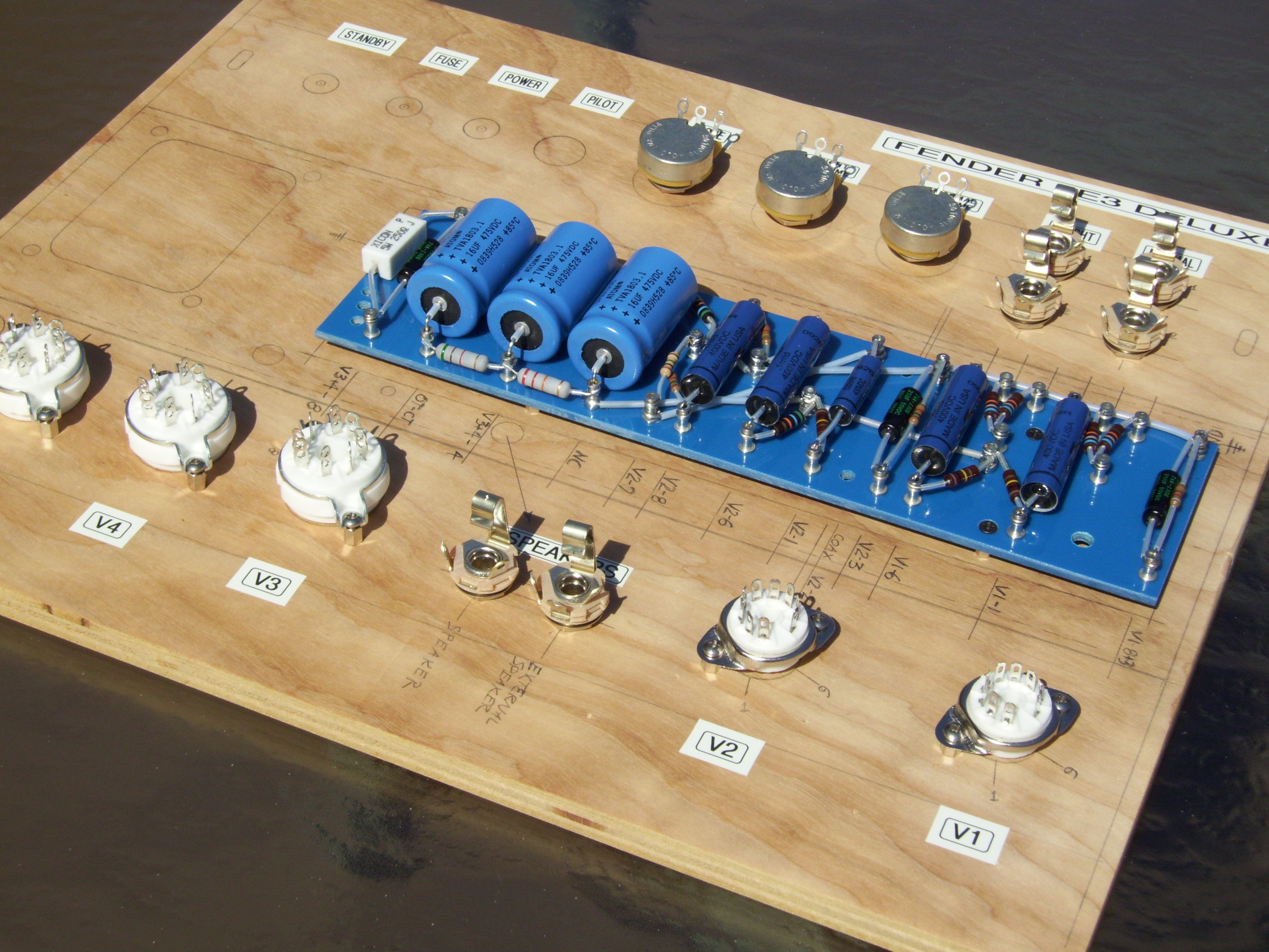

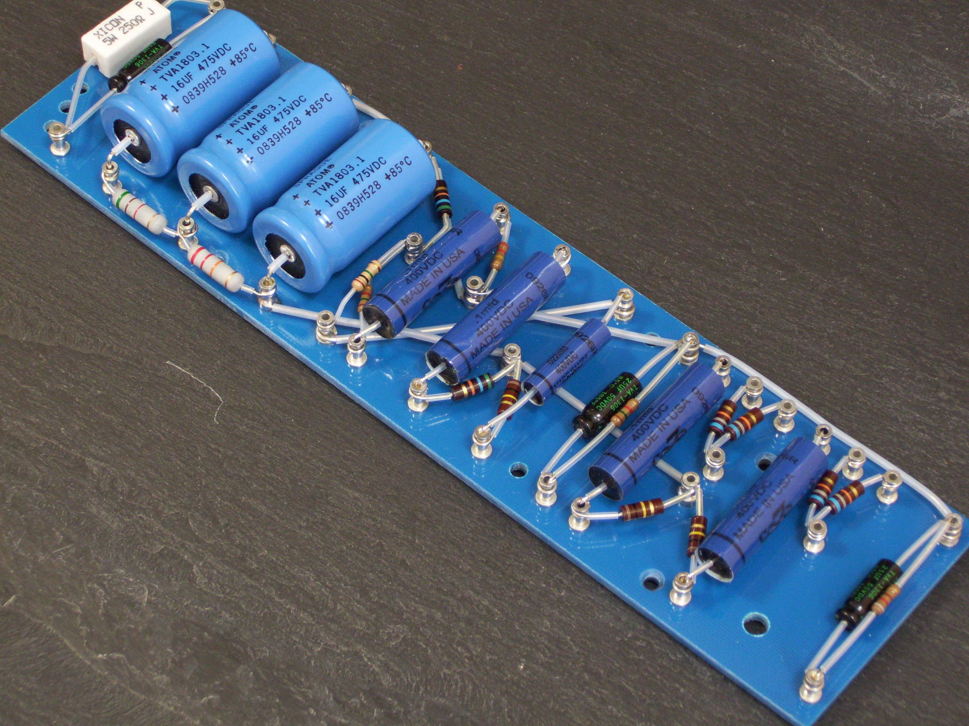

Hey, I started a new project, a 5E3 scratch build!
Hopefully I'll finish this one day :roll:

Can I ask where did you bought your board and your turrets ?
PostPosted: Sat Mar 27, 2010 8:43 pm
Posts: 432
Location: Massachusetts
Thanks so much :o
The board came from Ken Watts at http://www.turretboards.com/
First time I've dealt with them, but Ken seems like a great guy to deal with and this board is just beautiful.
Very meticulous, Joeyvelour approved!!

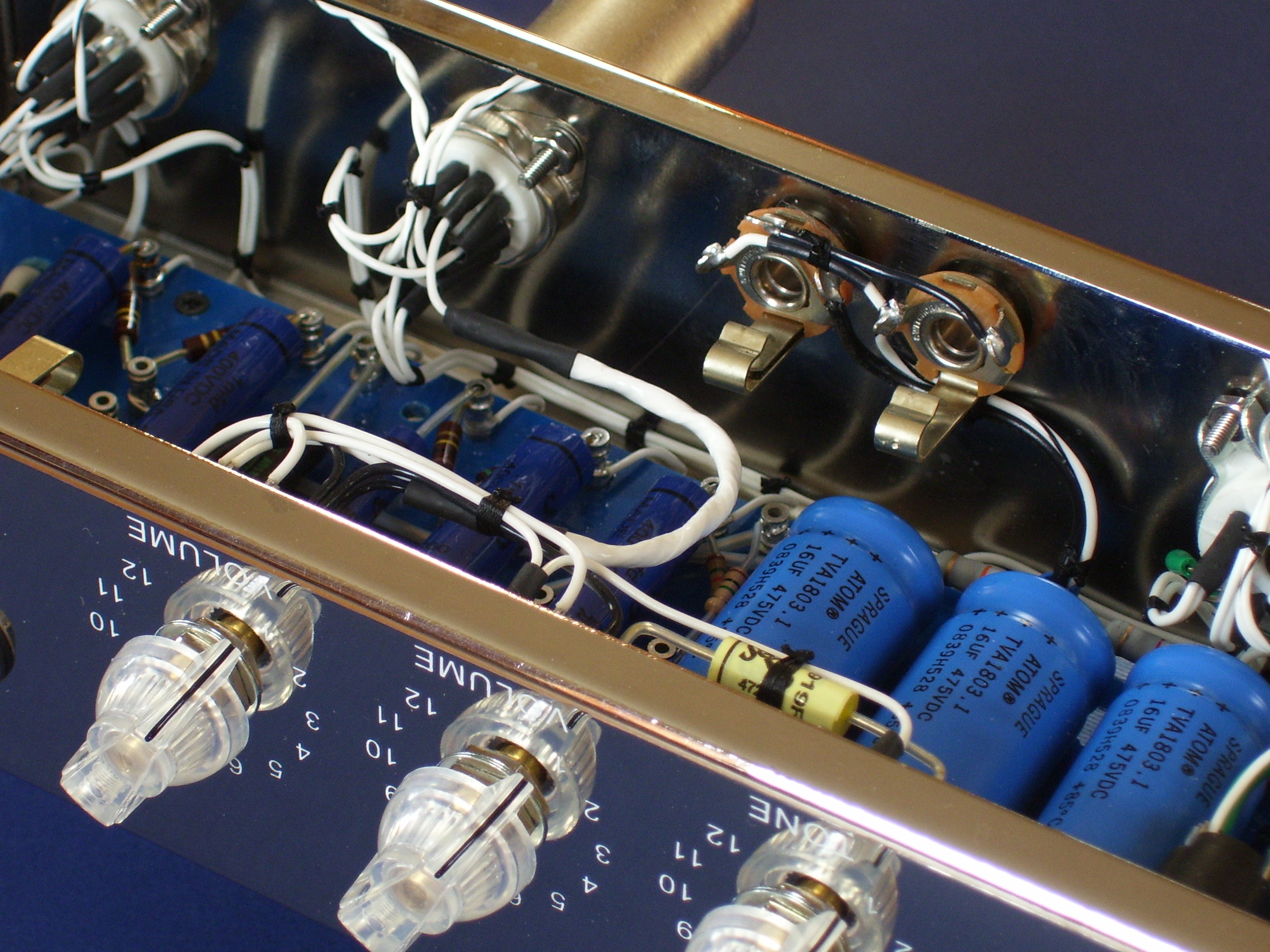

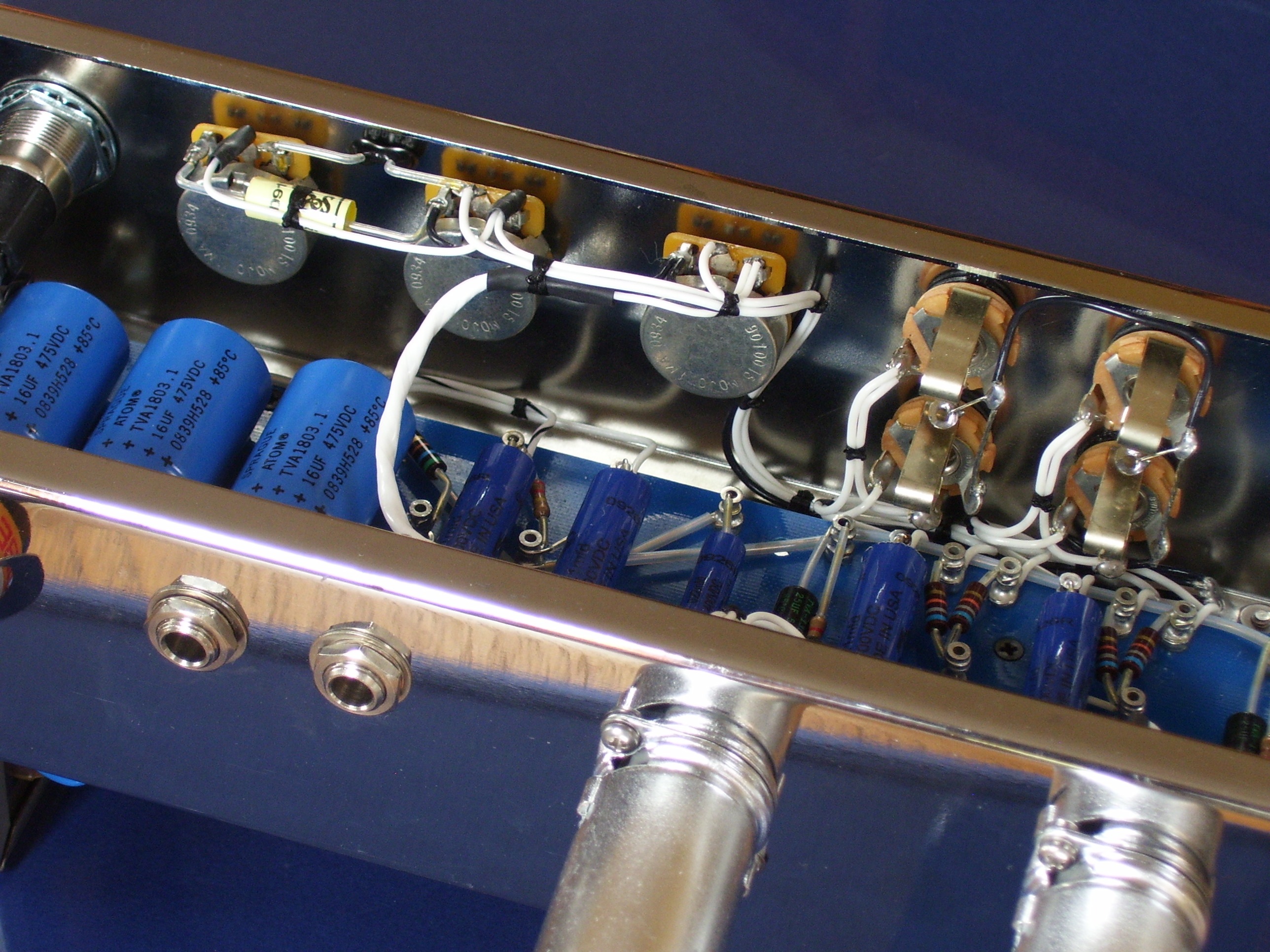

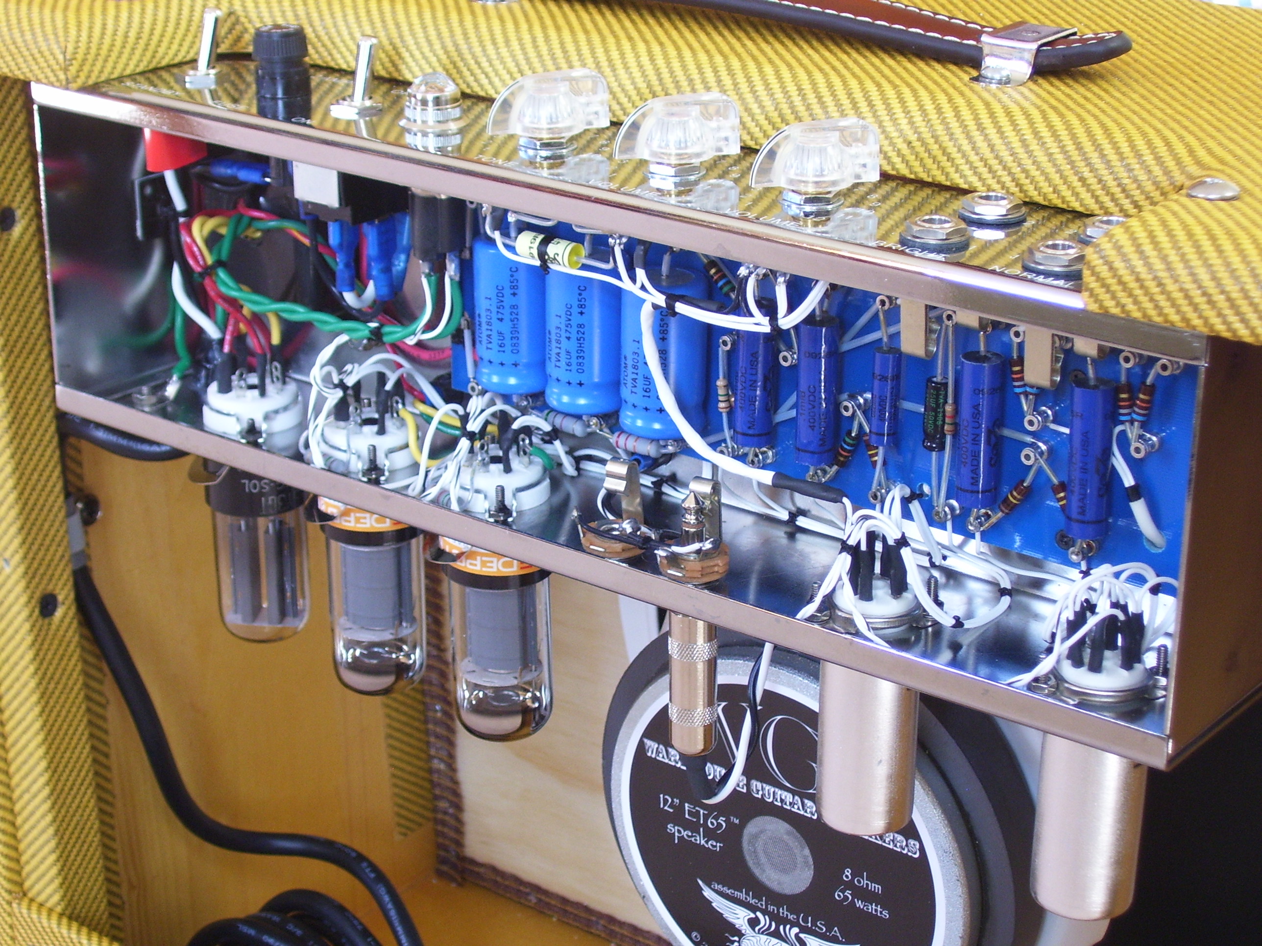

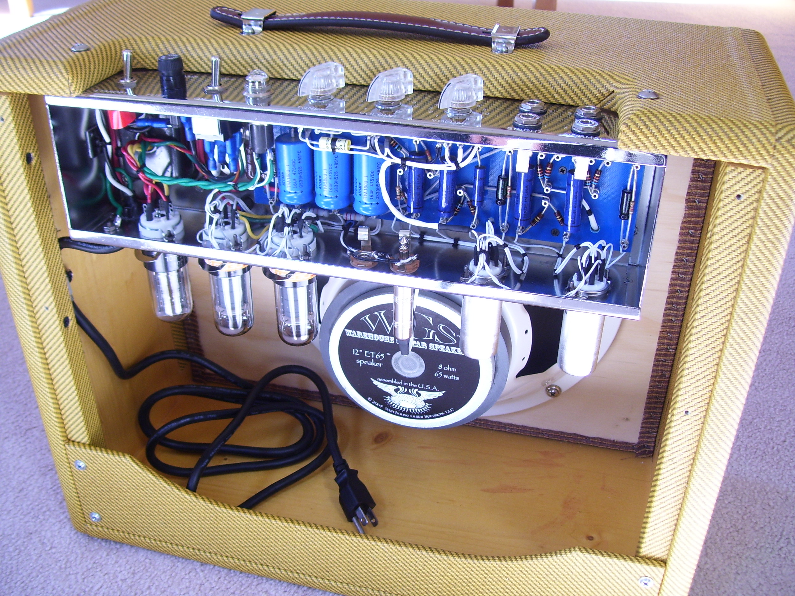

Hey everyone, I finally finished this...!
Joe G

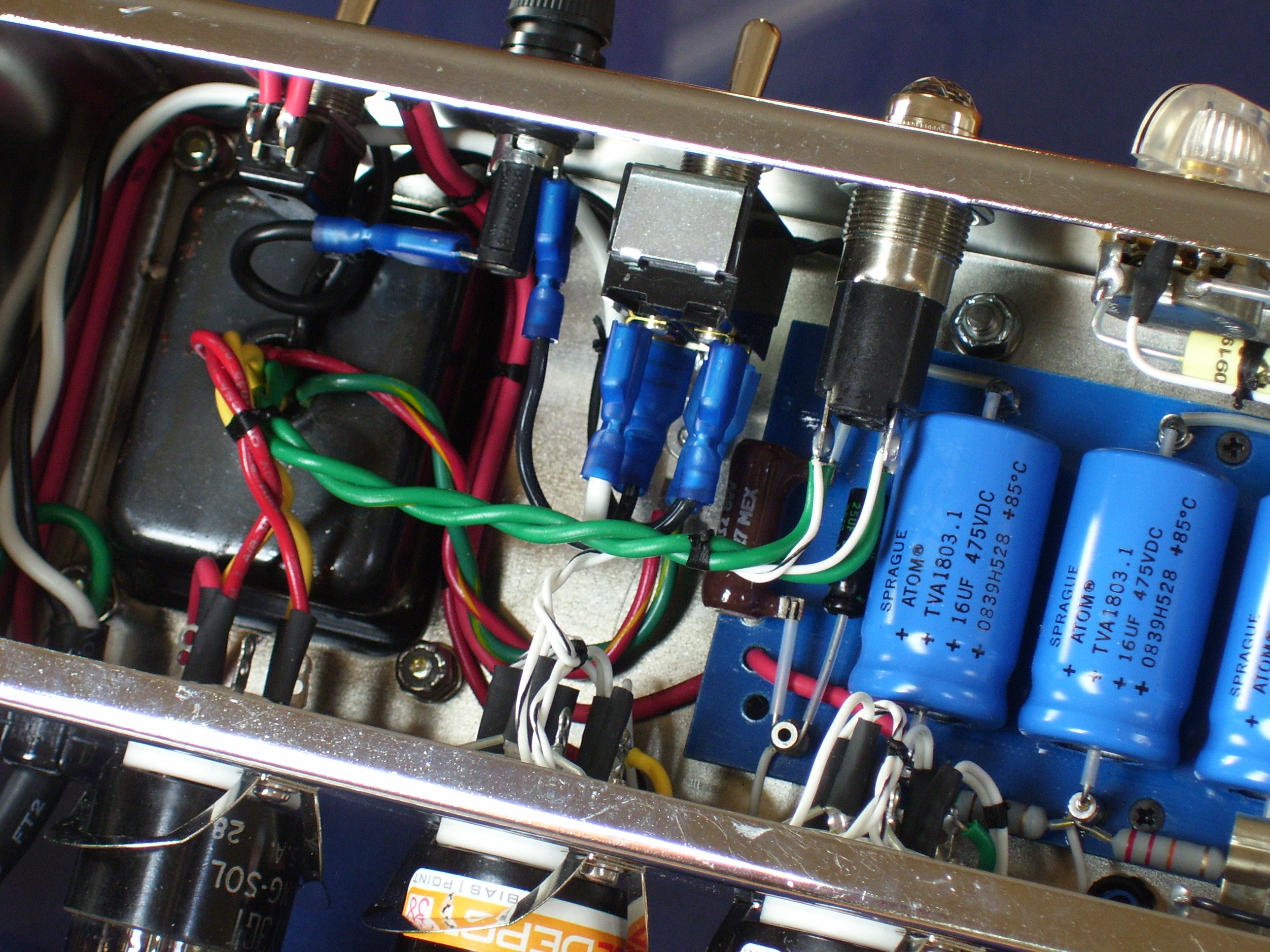

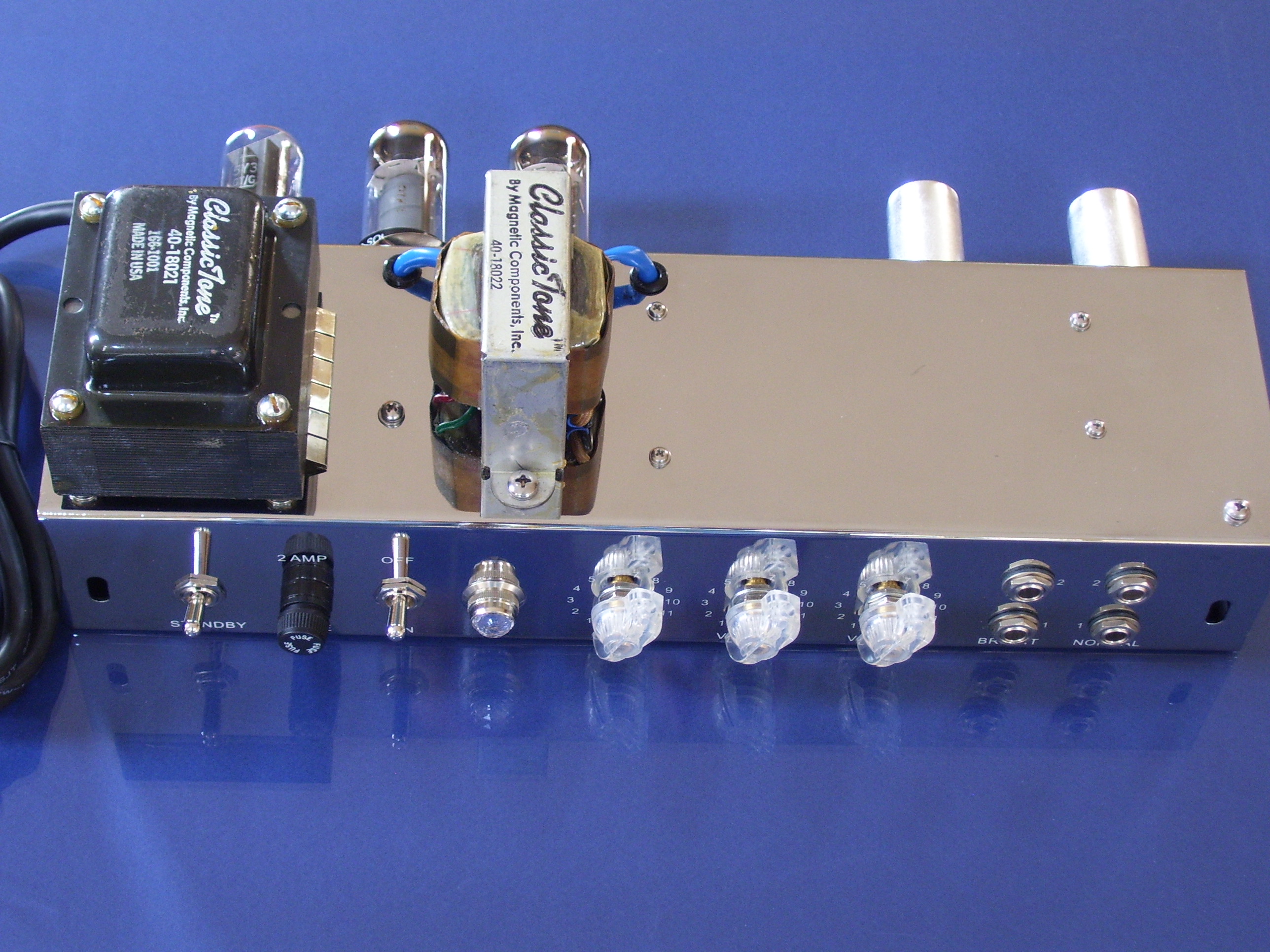

A few more...
Enjoy!

Joe, that is gorgeous work, your usual of course but ours to admire! What are you using to bundle your wires - I don't recognize that material.
PostPosted: Sun Nov 13, 2011 7:48 pm
Posts: 103
Location: Burlington, ON
With craftsmanship like that you'll need a transparent panel in the cabinet to show it off!
Great job.
PostPosted: Sun Nov 13, 2011 10:27 pm
Posts: 432
Thanks guys!

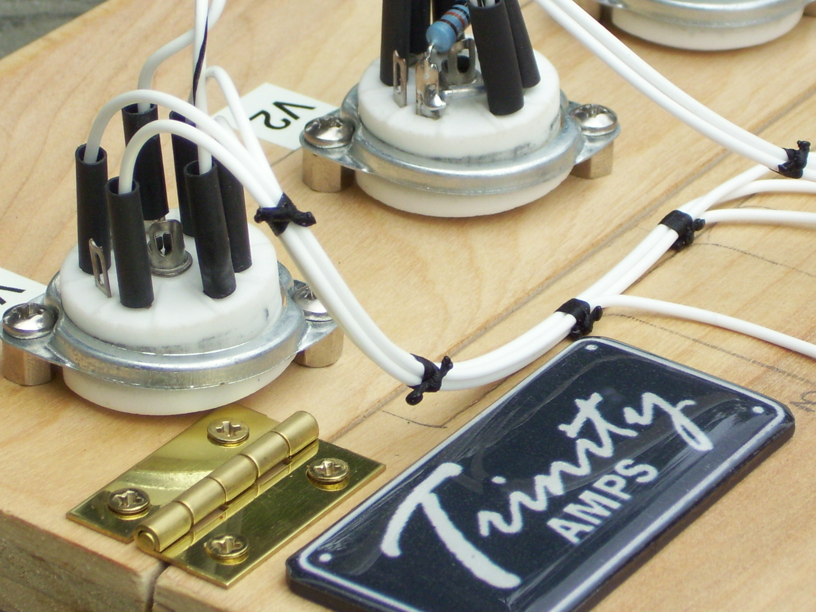

Hey Jim! Here's a link to a description of the lacing cord (or tape) that I used...
https://www.pegasusautoracing.com/produ ... oduct=4041
I like to use individual "NASA knots", but you can do a continuous run stitch as well like in the Hiwatts. After I tie the knots I cut off and cauterize the ends by hovering close to them with 1400F thermal strippers, then seal the knot the same way
You can see it better here...

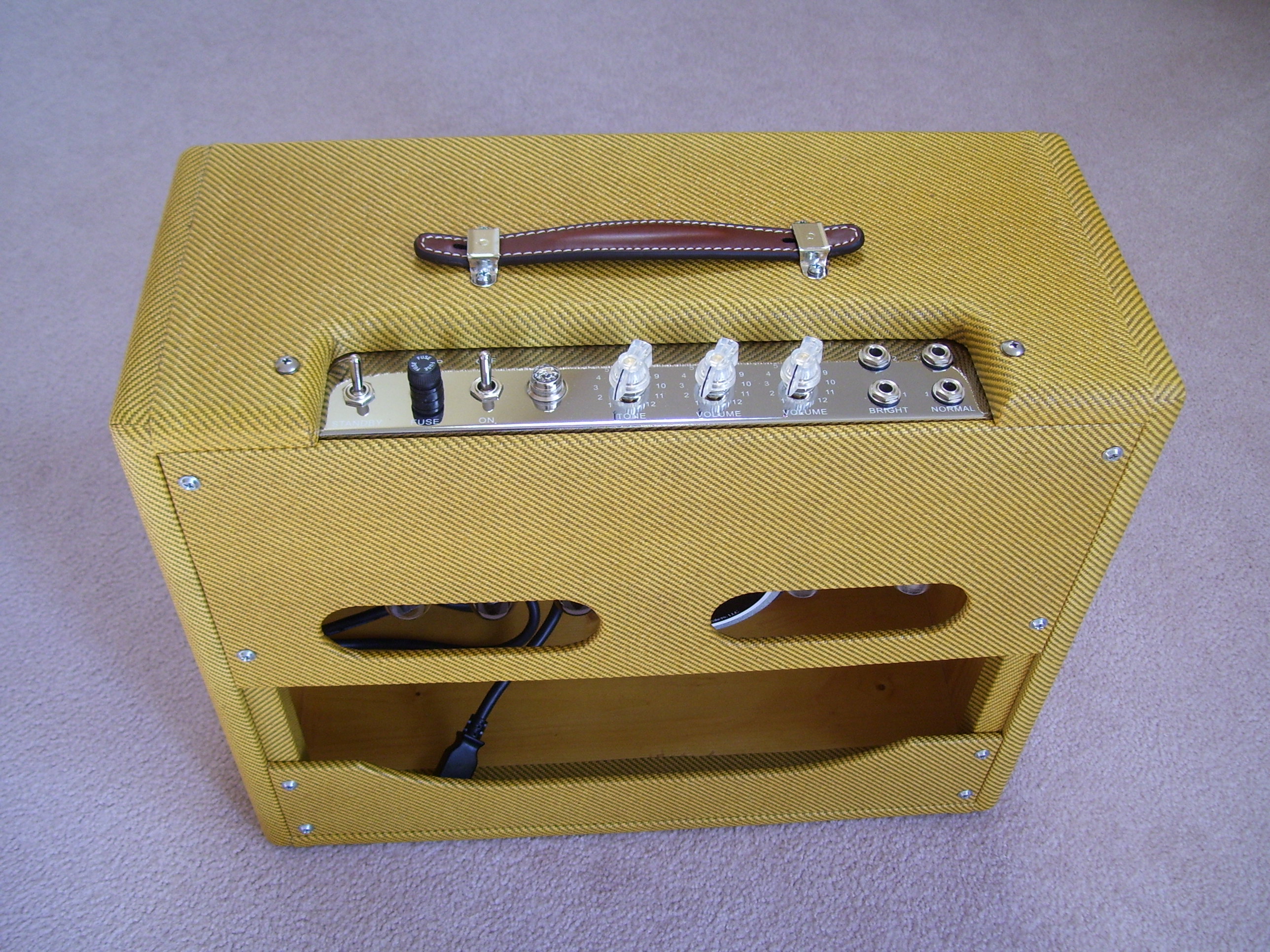

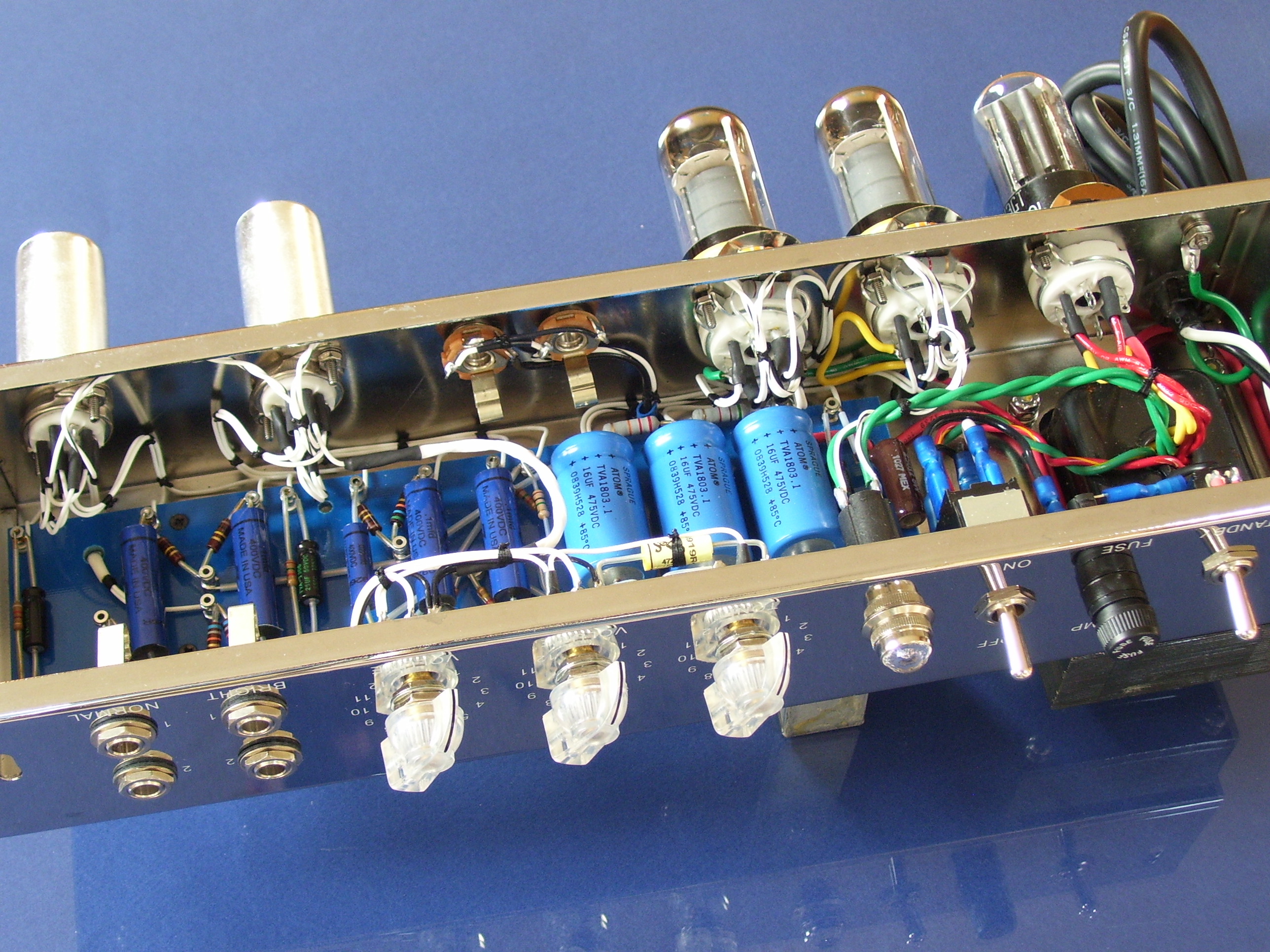

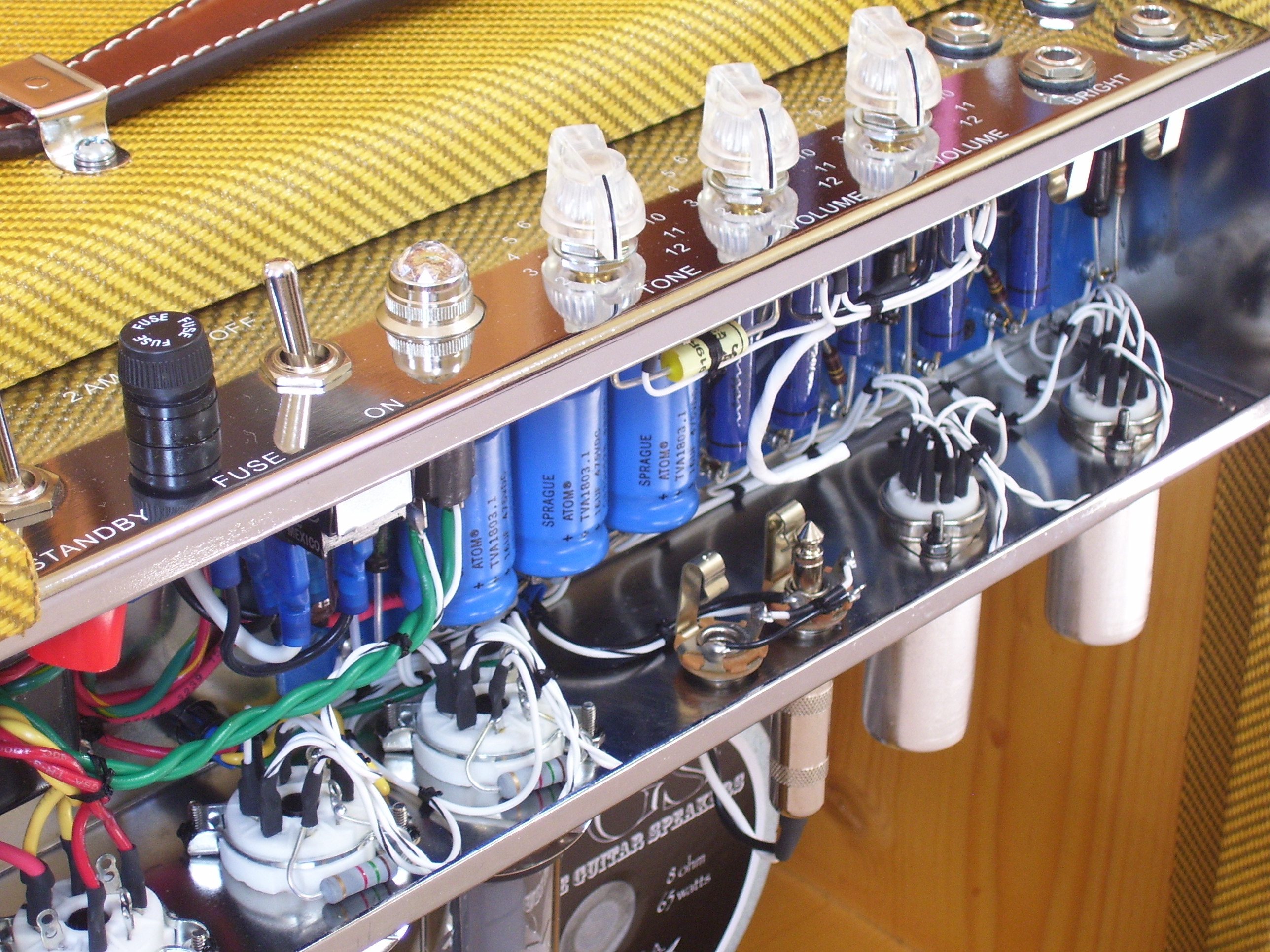

Thanks guys. Got this finished up today and it sounds gorgeous!
Some assembly required,
Brain sold separately...
PostPosted: Thu Dec 01, 2011 4:58 pm
Posts: 432

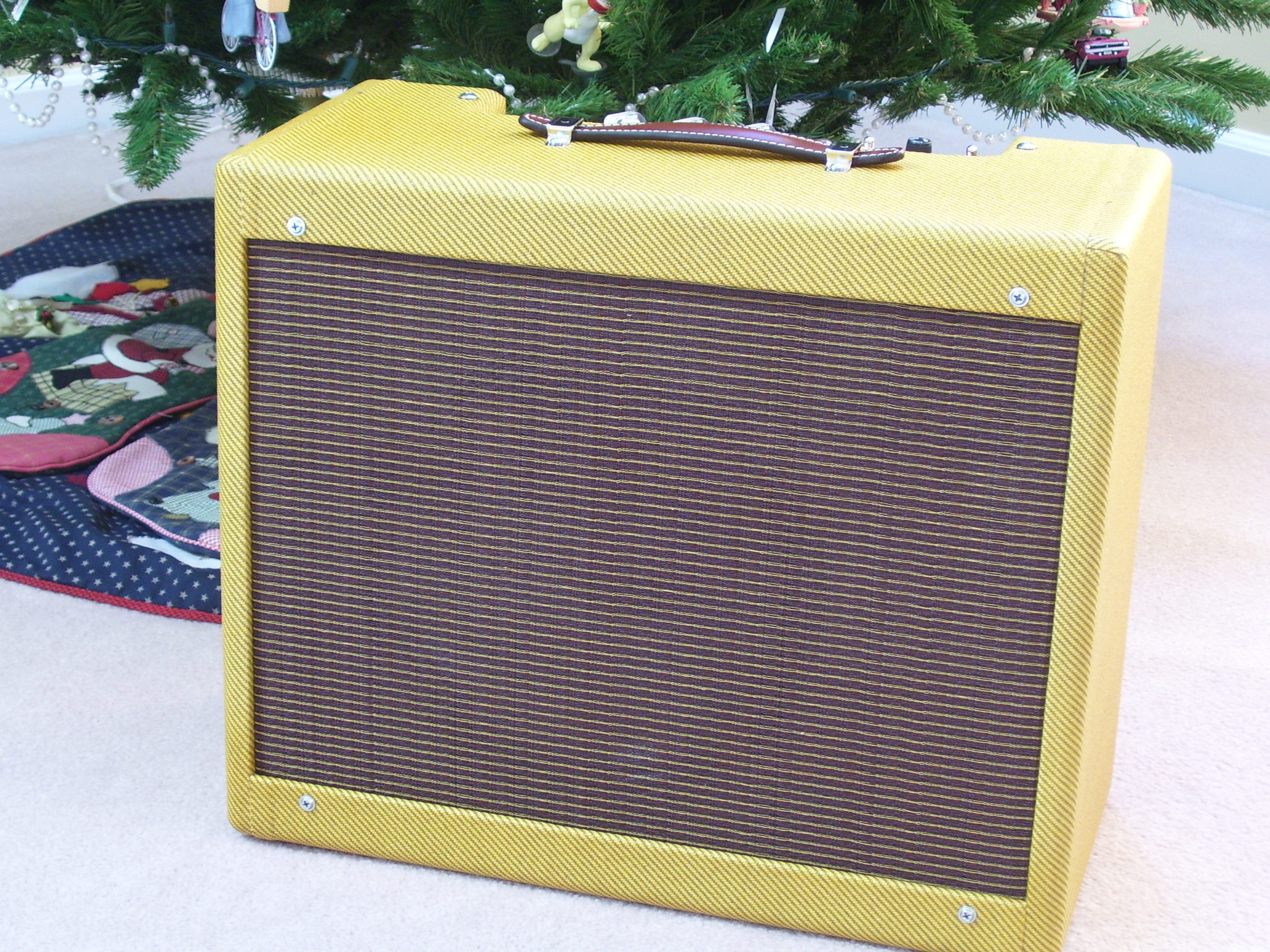

...and under the tree it goes!
Thanks Santa!!

Thanks Stephen, no mods needed for this thing! I played it in my friend's studio for about 5 hours yesterday and I think I saw a tear running down his face when I loaded it back in my car :P I may have to build another one!!

Awesome build.Any probs associated with running all wires on top of board ??
Seems like the way to go to me. :chatter:
