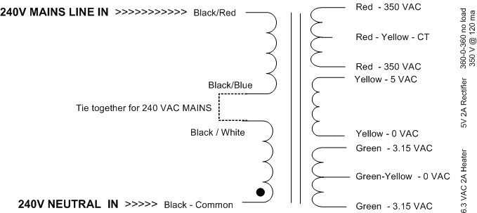

I wired the Power like this.
240 V
White from outlet to Black PT
Black from outlet to fuse
Black/blue to Black/White
Black red to on/off switch.

For 240V - use the primary in series hooking Black /Blue to Black /White. Connect 240 mains to Black/Red and Black (common/neutral).
If White on mains line is neutral in your country, then it should go to Black on PT.
Other connection (Hot) should go through fuse to power switch and then to Black/Red on PT.
Rule is: Always break the hot line (fuse, switch)
Yes, you have the Black /Blue to Black /White connected properly.

Check that the path for the hot side is correct. Just follow it through. Some of the leads off the board are long and it might be a little noisy.
