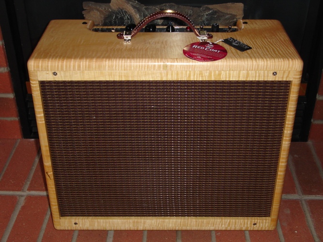

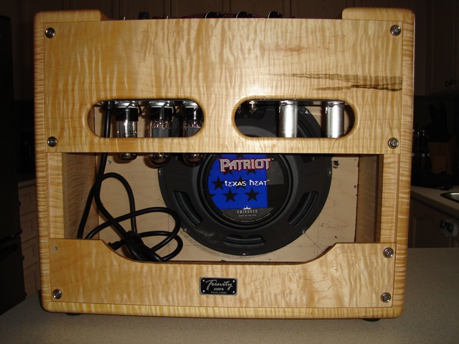

Anyway, I built a Trinity Deluxe a few months ago as a surprise birthday/wedding/christmas/housewarming gift for a friend of mine. I also had Stephen build a maple cab for it - very similar to lbet's cab, but with oxblood grill cloth. Looks VERY vintage. Don't have a pic handy, so you'll just have to imagine! :P
Anyway, I didn't have the coin to shell for a TT so I tried an Eminence Texas Heat in it. Love it! Keeps the roundness & chime clean but cooks nicely when the amp's pushed hard. It projects exceptionally well. The bottom end is especially sweet - very full but not flubby at all. We probably never got close to speaker breakup with the power handling of that speaker, but to be honest I'm not a big fan of it anyway.
When we presented him with the amp (brought along my Strat with Kinman AVN Woodstocks for a test drive) the amp lit up the eyes of every musician in the room (about 8 of them).
Another winner Stephen! Good job my friend.

pics added to Emo's post
Thanks for posting the pics. I take it you've heard from Chuck then? :)

I tried the Deluxe through a few speakers also. I agree with the assessment regarding the V30's. It sounded a little too edgy through my 2x12 closed back cab. I also tried it through an Epi valve Jr cab with the stock Eminence "Lady Luck". Pretty dull sounding, but that speaker doesn't sound great with any of my amps. It's on the replace list.
I decided to try the Texas Heat for a number of reasons, budget not the least of them. However I also wanted something with a vintage american flavor with a bit more "spice". The Texas Heat was recommended and I think it delivered nicely. Still has that vintage open character but has just a bit of a compressed feel when you throw an overdriven signal at it. I think that'll work well for Chuck (the guy I built it for) as he has strong blues-rock influences.
But hey...speakers, like anything to do with tone, are a personal thing. I didn't hear any complaints about what I put together at least! :)
