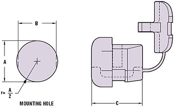

Thanks for the encouragement. I'm going to try to get a lot done today. However, I'm completely baffled on how to fit the strain relief! Coco actually mentioned how to, when I picked up the kit, but I forgot! Any tips?
PostPosted: Sat Jul 26, 2008 8:35 am
Strip 8-10" the end, Put the strain relief on the cable that still has the outer plasic sheath by folding it over itself. Take a pair of pliers to squeeze the strain relief and push it through the hole in the chassis so when it expands, it will stay in tight. There is a flange/groove on it for that purpose.

PostPosted: Sat Jul 26, 2008 8:45 am

Harrumphh . . . I had to wait a whole hour for an answer! :roll:
J/K! Thanks Coco! :D
PostPosted: Sat Jul 26, 2008 9:36 am
It was a valid question so I put the instruction in the resource forum too.
