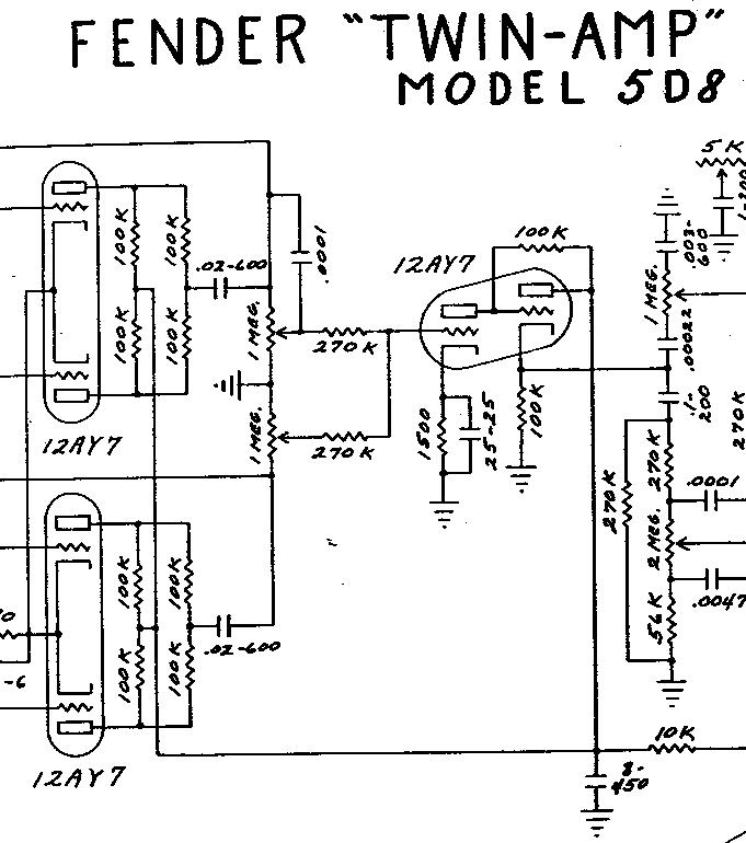

On the Twin for example, there are two volume controls each controlling one stage of a 12AY7 tube. They are very simple and economical circuits, only 5 parts per circuit. Each output comes from the volume control and passes through an “isolation” resistor – a resistor placed in the circuit to isolate the two volumes from each other, and at the same time to mix them for the next single input tube stage.
The “feature” is that the isolation resistors values (270K) do not isolate the stages from each other enough – one stage can still “see” the grid load resistance from the other. It appears to the channel you are plugged into, that there is another resistor in the circuit formed by the other unused volume control and its isolation resistor.

Stephen...I don't see that in the schematic of the tweed deluxe that you have posted. No mixing 270K resistors and the "out" is from the tone control not from the volume pots!?????
Stew
PostPosted: Fri Feb 15, 2008 6:28 pm
Truly. The description is generic to some Tweed models. I guess that's not clear.
Take a look at the schematic and it is clearer what is being discussed.
