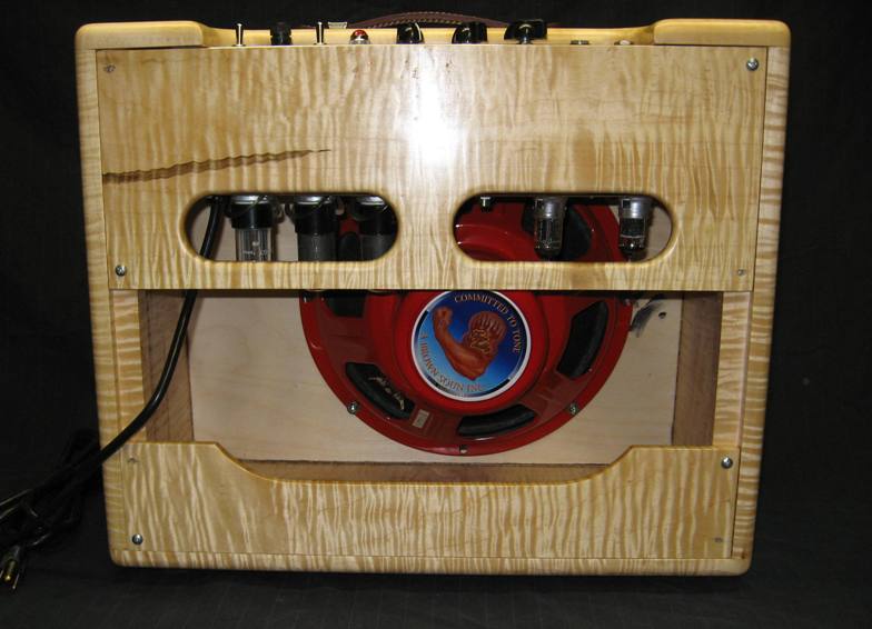

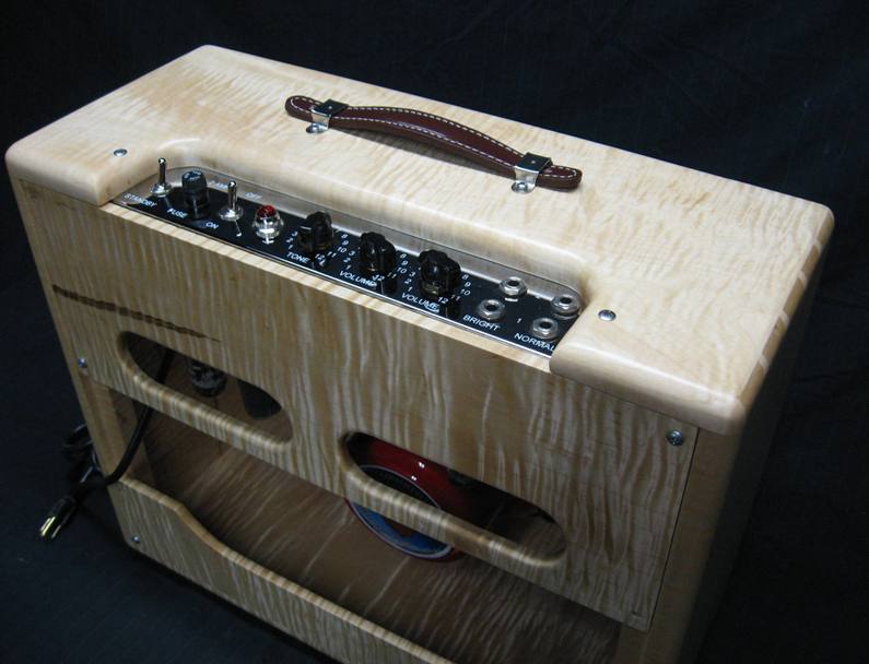

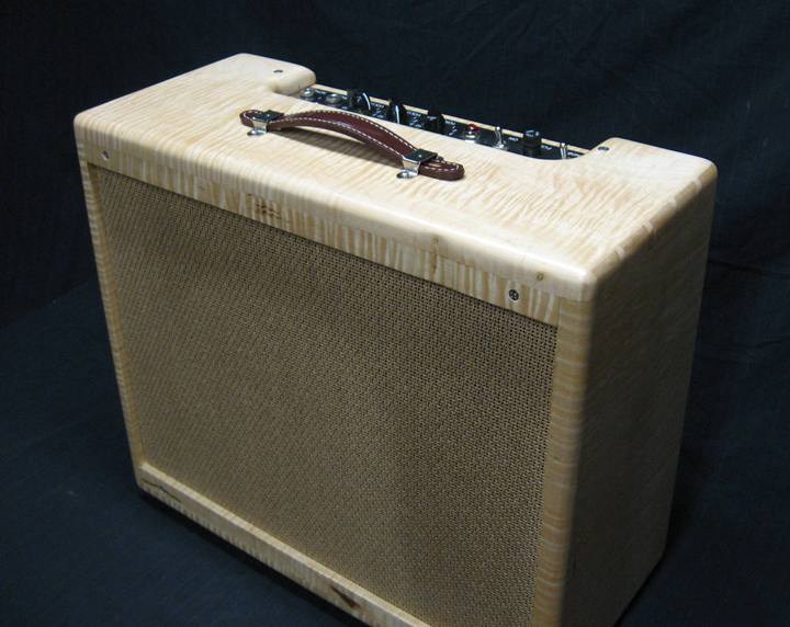

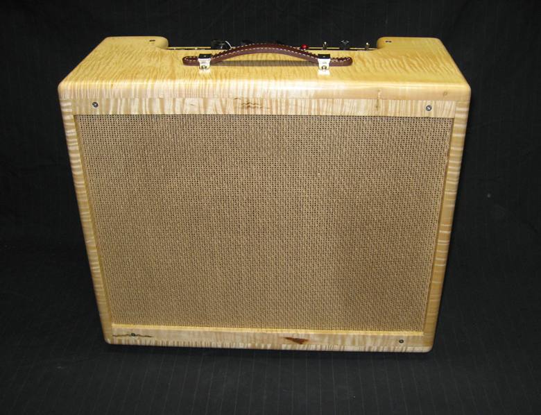

Flame Maple Cab is built and ready for inspection. It's quite gorgeous with excellent flaming with dovetail joints.
Time to wrap this one up!

Stephen, looks fantastic!!
You do exceptional work on the hardwood cabs, you should promote them more :D :D
I know I'm thrilled with mine and will go that way again with the next kits.
PostPosted: Sun Feb 03, 2008 5:00 pm
Posts: 69
:shock: Wow that looks amazing!
I always thought it would be cool to have a nice flamed or quilted maple amp cabinet. Maybe one day I'll get a flamed cab sprayed in cherry burst, that'd be cool.
Great work Stephen, that looks beautiful! I'm sure Ibethune will be very pleased with that amp!
PostPosted: Thu Feb 14, 2008 2:53 pm
Man...every time I look at these pics the thing grows on me. I was ambivalent about it at first, but now...
I just build a Deluxe for a friend of mine and we've decided on a cab very similar to this one. We figure if it looks this pretty his wife might not mind having it in the living room! :)
Kirb
PostPosted: Sun Feb 17, 2008 4:36 am
Posts: 308
Location: Brampton
The cab has definitely grown on me. I think the grill cloth colour is great match ( I was sweating over that for a while). At this point I stop in my tracks every time I see it.
Coco did an excellent job on this one.
