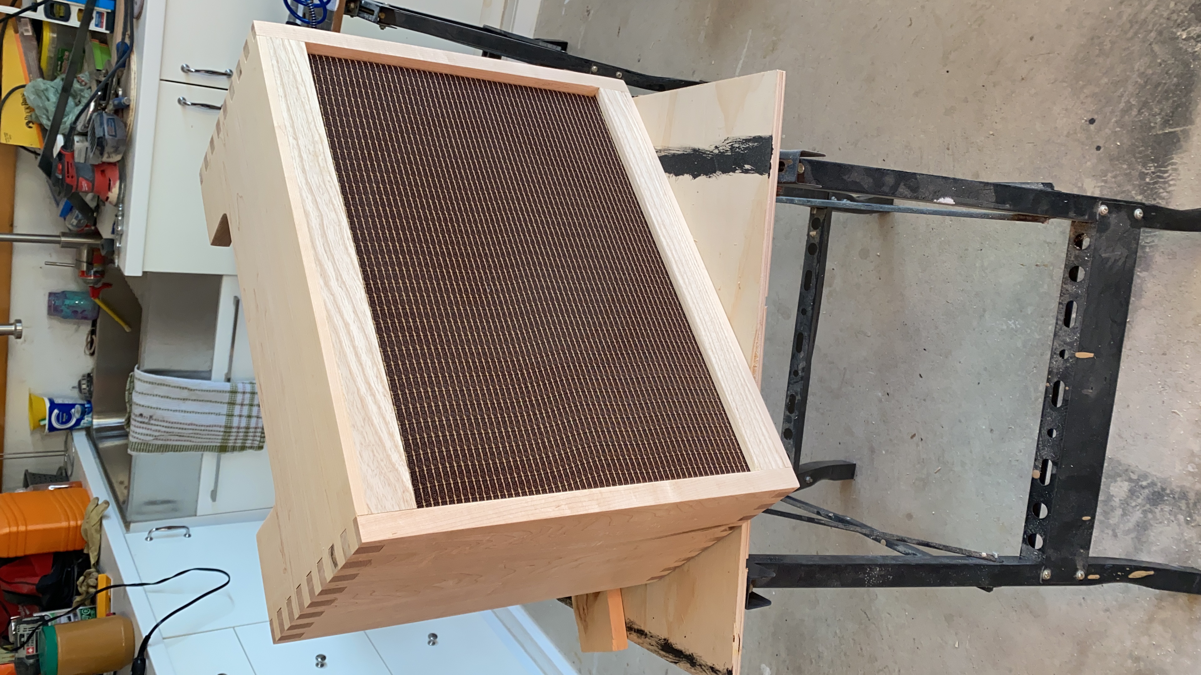

Wow how time flies. The new year rolled around and the guitar portion of my project kicked in and and kept me occupied. I'm working with a local Luthier building a telecaster and having a blast... until COVID. So with that shut down for a couple months I decided to start in on the cabinet build. I still haven't mustered up the courage to test my amp yet... really need to do that. I've included a photo of the cabinet build though, hope to upholster the speaker baffle tonight. I think the natural maple looks amazing, I'd never done box joints before and they turned out alright... plan is to paint the cab to match the theme of my guitar build but right now I just like looking at the natural finish.

Good to hear from you again :thumbsup: Cabinet looks good, first time building one? Box joints look good and strong.

First time amp build and cabinet build, so far so good. Got the speaker baffle covered last night... not entirely happy with the result. Hard to get the right tension across both sides and not warp the pattern. I used a hair dryer to warm up the material and that helped get it wrapped around the wood better. It is nice and taut though so I've got that going for me :).
I've only ever really dealt with low voltage electronics before so the clips I do use are not a terribly thick gauge, they are just cheap ones from Sayal that look like the attached. I usually just clip those on to the end of my probs... I think I'll look for clips that plug right in the meter and not screw around with these cheap ones. I also read MitchM's response and it's helpful, I should be able to sort those measurements out.
I also need to round over the edges on that cabinet and build the back panels. Looking forward to trying to get the radius right on the lower panel.
