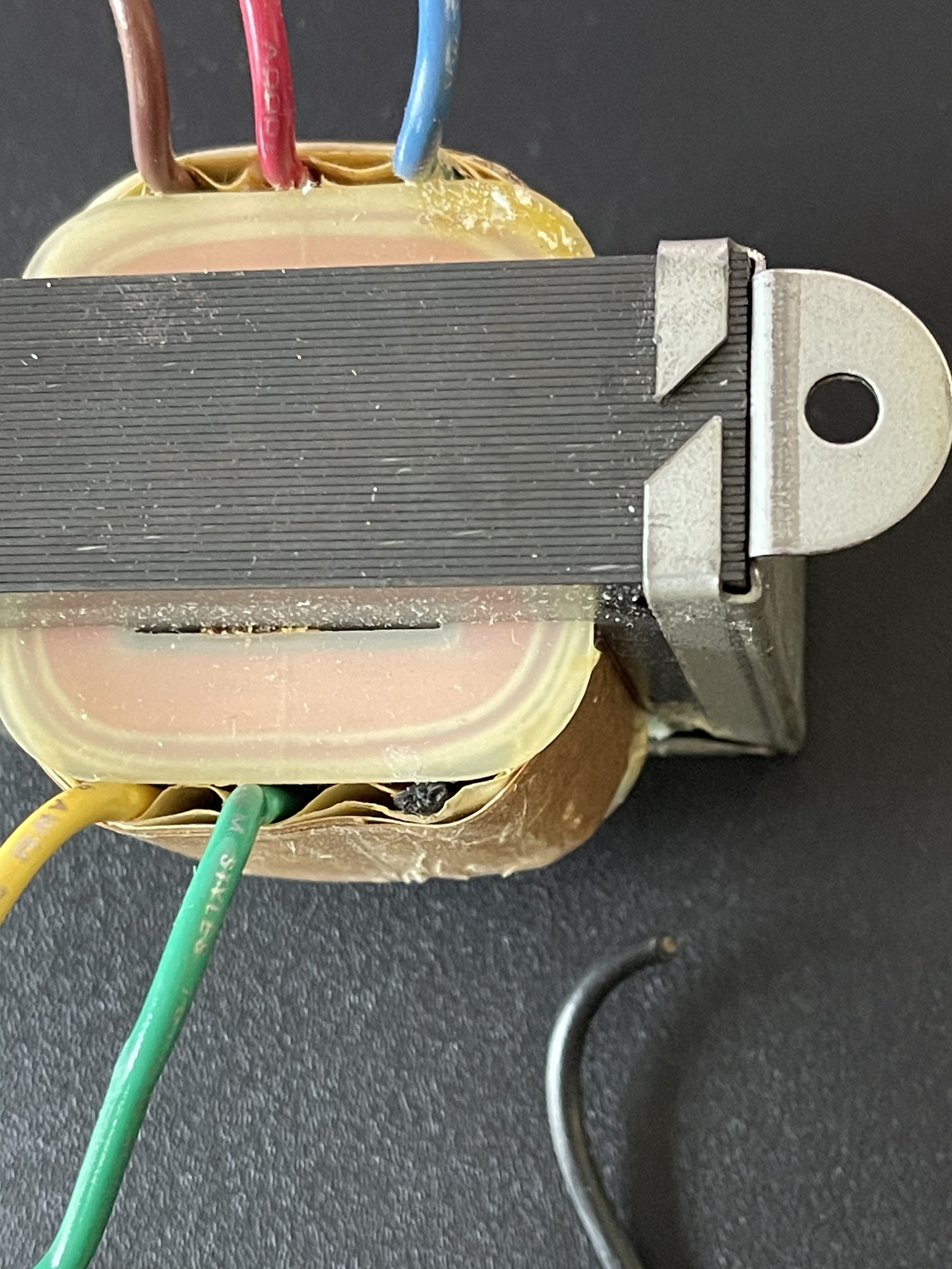

I'm building the Tweed Deluxe, and just got to mounting the output transformer on the chassis. When I removed the rubber bands that held down the wires, the black wire fell off. It appears to have been crimped or cut where it comes out of the paper cover next to the green wire. Is this repairable, or do I need a replacement?

Update on this. Obviously I needed a new transformer, which Craig did supply.
