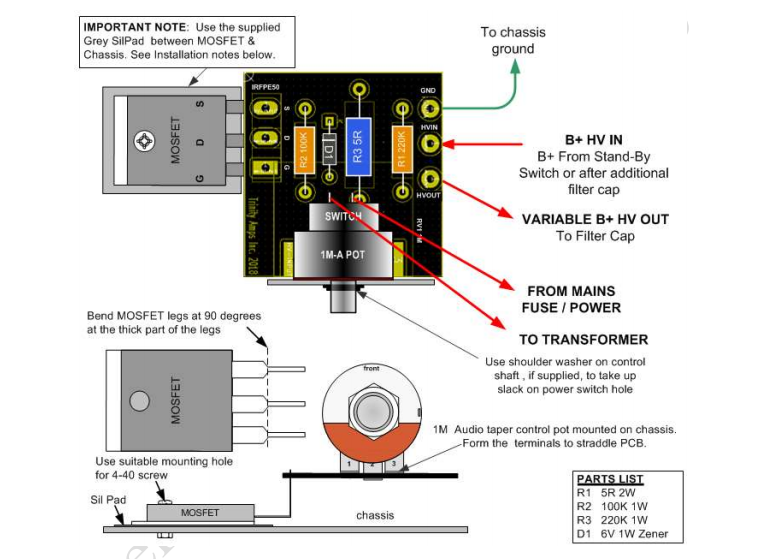

The diagram in the VRM documentation (version 3.1) locates the VRM potentiometer on the front panel. But that's where is now located the power switch (not present on the VRM layout). The tweed documentation require to connect a red wire between the right side of the standby switch to the the eyelet board (to the 4K7 resistor). Do I have to remove this wire ? Does someone would share some pictures of this version of the VRM on tweed ? I find this part so confusing between the regular Tweed build and the installation of the VRM (+with the "switch feature" which seems to be optionnal (???)). I'm sure when you know what to do it's a versy easy and fast job but I'm just lost here and don't understand what I'm supposed to do with what I've already wired and where goes thing the way I've installed the VRM... :/

The VRM does not mount on the outside of the chassis. That wouldn't be safe!
It mounts inside as shown on this drawing.
You have to mount the VRM on the front panel instead of the power switch. The pot on the VRM board includes a switch (the black part at the back with the two terminals) and you use this instead of the regular power switch.
The drawing also shows how a red wire runs from the standby switch to HVIN on the VRM board. Another red wire runs from HVOUT on the VRM board to the eyelet on the main board where the 4k7 resistor is.
You have to remove the MOSFET from the VRM board and mount it on the side of the chassis and run wires to it from the VRM board. This is also shown on the drawing.
You have to remove the 1M resistors from the input jacks and mount them as shown on this drawing.

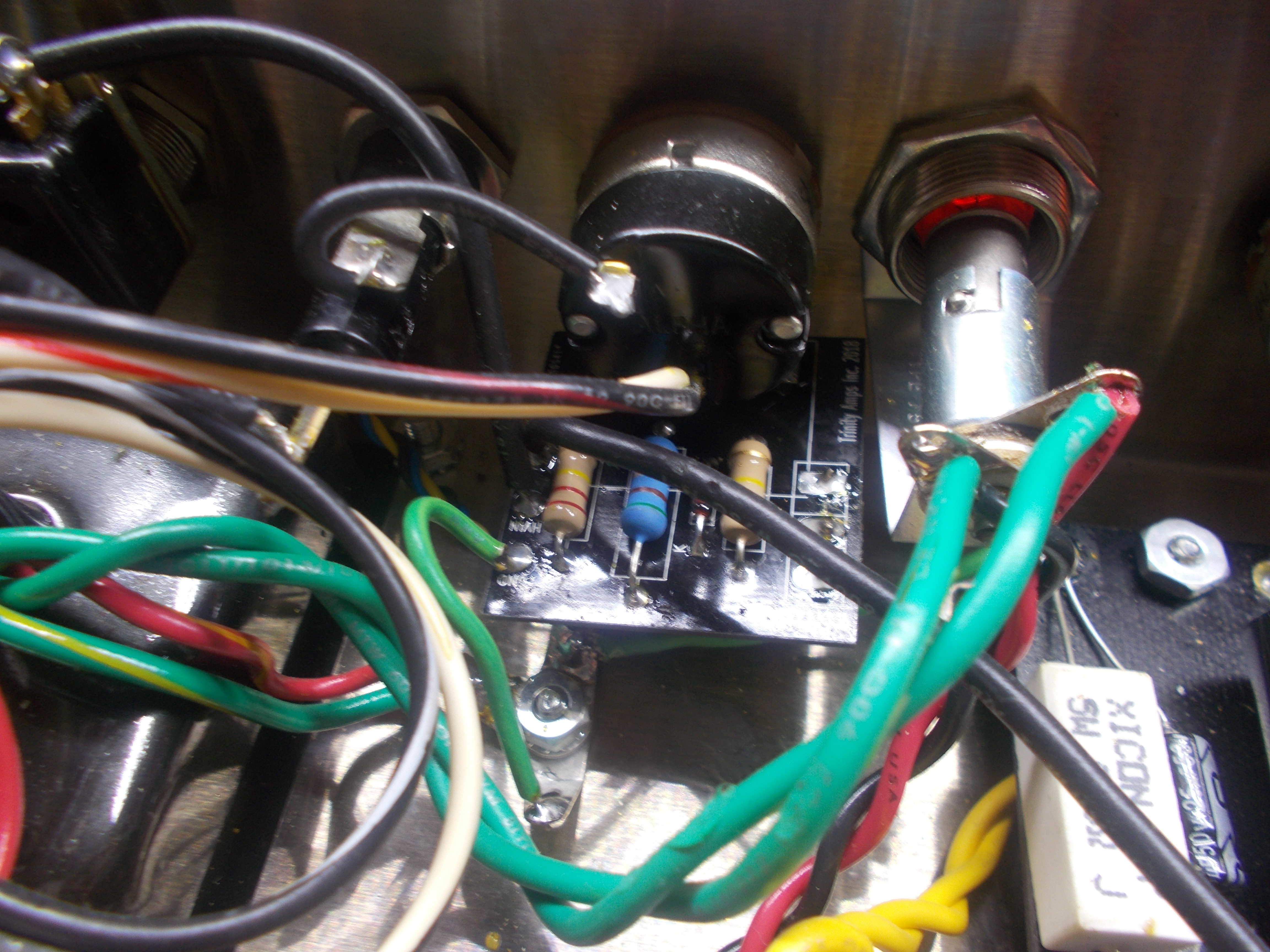

Here are some pictures. Used 3 different colored wires (twisted) to prevent confusing the connections and connected wires to board first. Ran the wires down and along the chassis, over to VRM MOSFET and connected the wire to proper connections on MOSFET.

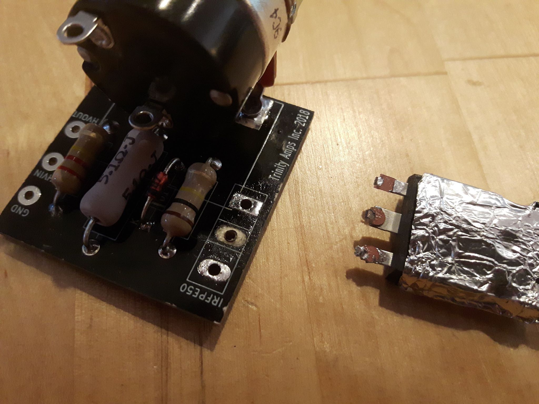

I think I'm going to have to skip the VRM. Even after removing all the solder, unattach the three legs at the same time didn't work. After being melted, the first leg hardened as soon as I took care of melting the second one and so on.. I was unable to melt the three at the same time and remove the mosfet. I had to cut the legs as short as possible. Didn't work So I simply cut them all from the other side.
As you can see on the pics the PCB seems to be damaged. So if I want to go on with this I have to order antoher kit.
I've tested the conductivity/connectivity with my multimeter. The S and D still works but I have no clue for the G. I'm not able to find a working connection anywhere on the PCB board.
So enjoy the long weekend and thanks again for your precious help !
