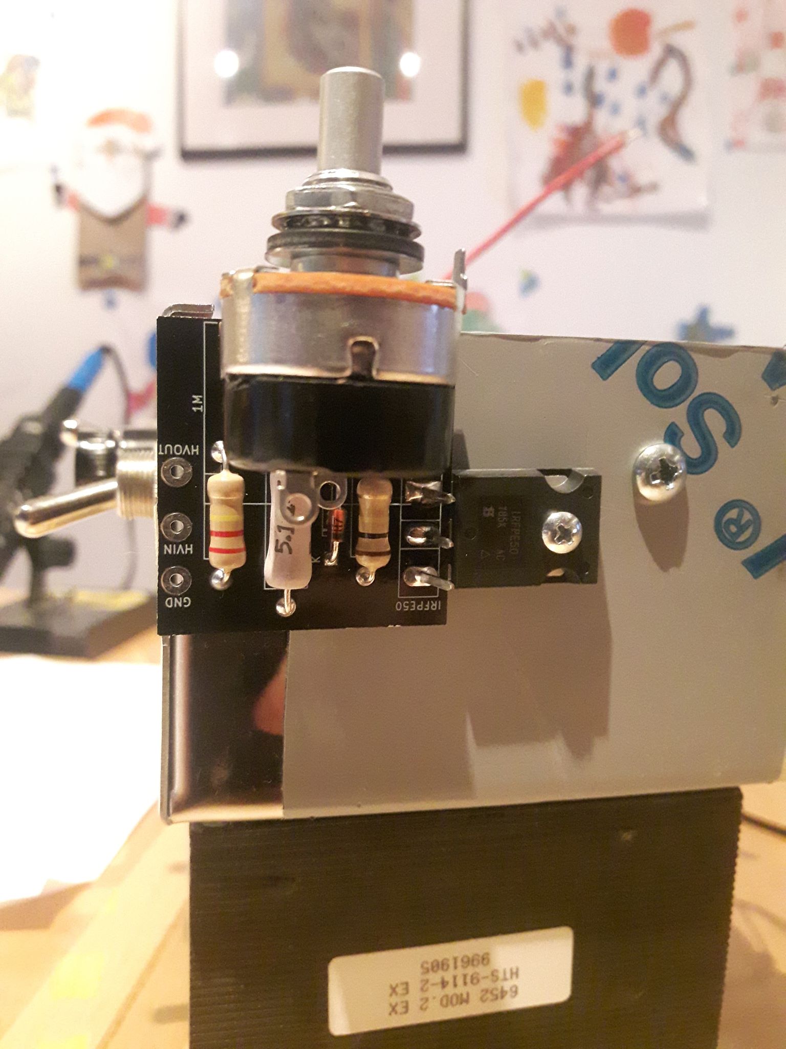

Hi ! I start a new topic about the VRM installation (besides my other post with my regular followup/questions).
I would need some confirmation/answers to make sure how to install the VRM correctly..
Location of the VRM
Is this where it goes ? (pictures below) I cannot find another place. At first I thought it was supposed to be installed in the inside of the chassis but that's just doesn't fit inside.
Since the cabinet is long enough I guess it goes on the outside. I will need to make a special access through the cabinet.
Can you confirm me it's supposed to go on the ouside of the chassis like this ?

 Post subject: Re: VRM installation
PostPosted: Fri May 15, 2020 9:50 pm
The VRM does not mount on the outside of the chassis. That wouldn't be safe!
It mounts inside as shown on this drawing.
You have to mount the VRM on the front panel instead of the power switch. The pot on the VRM board includes a switch (the black part at the back with the two terminals) and you use this instead of the regular power switch.
The drawing also shows how a red wire runs from the standby switch to HVIN on the VRM board. Another red wire runs from HVOUT on the VRM board to the eyelet on the main board where the 4k7 resistor is.
You have to remove the MOSFET from the VRM board and mount it on the side of the chassis and run wires to it from the VRM board. This is also shown on the drawing.
PostPosted: Fri May 15, 2020 11:57 pm
Posts: 24
Ok, thanks. I thought that was a previous/former way to install it. There was no wire in the VRM kit I've received. That led me to think it had to be done another way, like shown in the VRM documentation... Plus I have no purple wire as I see on pictures on forum, like this download/file.php?id=1886&mode=view. Not even sure I have enough long wires to do the job. So I thought it was done differently now.
Thanks a lot for your reply Mitch. It's very appreciated. Confusion's gone now.
PostPosted: Sat May 16, 2020 10:18 pm
Posts: 24
Sorry, I'm stubborn... I had to try the 9V battery test (I've stacked a couple of C batteries to get just above 9v). I didn't want to solder anything and used alligators clips (I've tested the connectivity from each leg until the PCB (from Mosfet D to HVIN and from Mosfet F to the R3 5R resistor and it worked).
So, despite the apparence (pictures above), I have results...
From a total of 9.54 volts I measure 6.89 volts at HVOUT which seems to be the voltage expected in the test.
Problem is, if I turn the potentiometer one way or an other, it always stays at 6.89 volts and even if I wait some time before each move...
If someone has still some patience with me (ahah) and have any idea... (?) :)
(edit : I'm trying the mosfet testing from the troubleshooting page of the VRM)
(edit2: I'm not able to get any reading from the mosfet testing)
