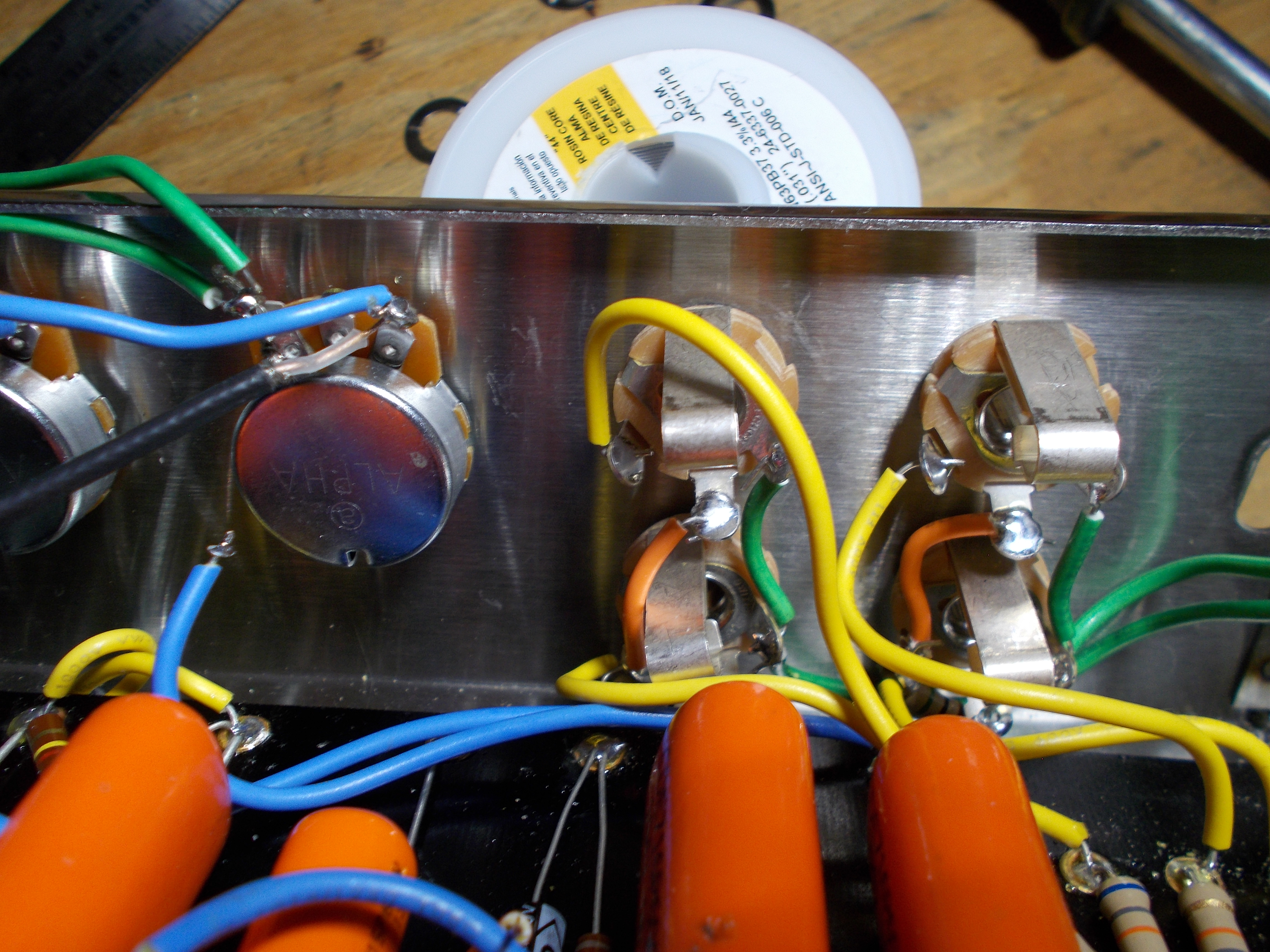

After getting everything put together, was checking components and when I checked the inputs the meter indicated continuity to the chassis on both of the Bright inputs but none on the Normal inputs (except when testing ground connection on Normal). All 3 Bright connections for each jack (ground, hot and switch) indicate continuity. Have switchrd the fiber washers around and removed/isolated jacks from chassis. Any ideas what I'm doing wrong?

PostPosted: Fri Oct 26, 2018 4:32 pm
Can you post a good picture? With isolated jacks and with no plug inserted, tip should be grounded. Only when a plug is inserted should you get continuity from tip to the 68K grid resistor. Both channels should behave the same way.

PostPosted: Fri Oct 26, 2018 5:52 pm
Here are two from different angles

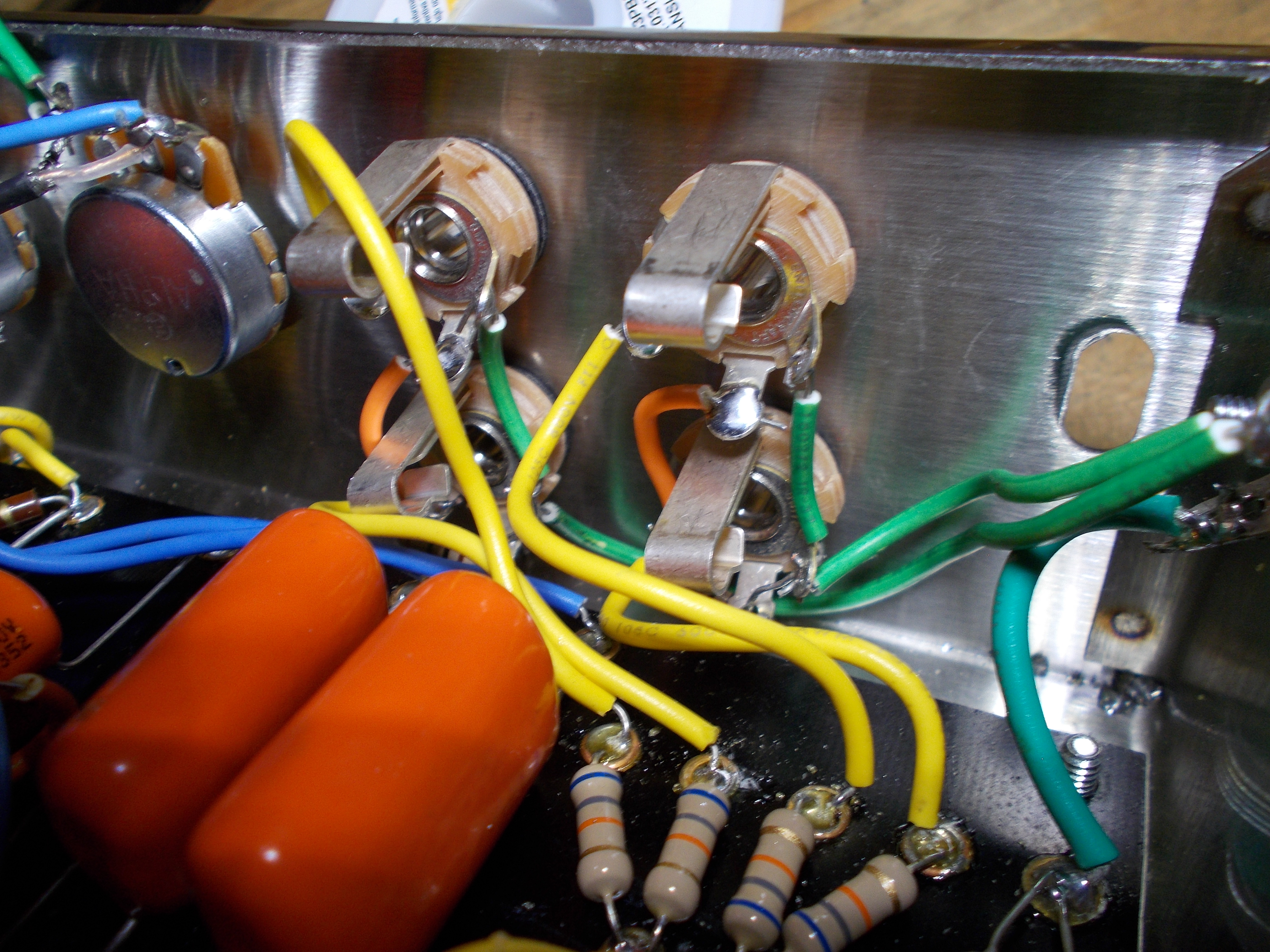

PostPosted: Fri Oct 26, 2018 5:54 pm
here is the other one
PostPosted: Fri Oct 26, 2018 6:39 pm
Stephen, disconnected the the star ground from chassis and there is NO continuity signal from Bright jacks now. I don't understand why there was no continuity on the Normal jacks, but there was on the Bright. Ground loop, maybe?

PostPosted: Mon Oct 29, 2018 10:08 am
With the ground disconnected, does it behave the same way? The channels are independent and should both work the same way if they are wired the same way.

PostPosted: Mon Oct 29, 2018 11:25 pm
Then they should act the same way when tied to ground. Put a jumper from chassis ground to the ground pont and what happens?

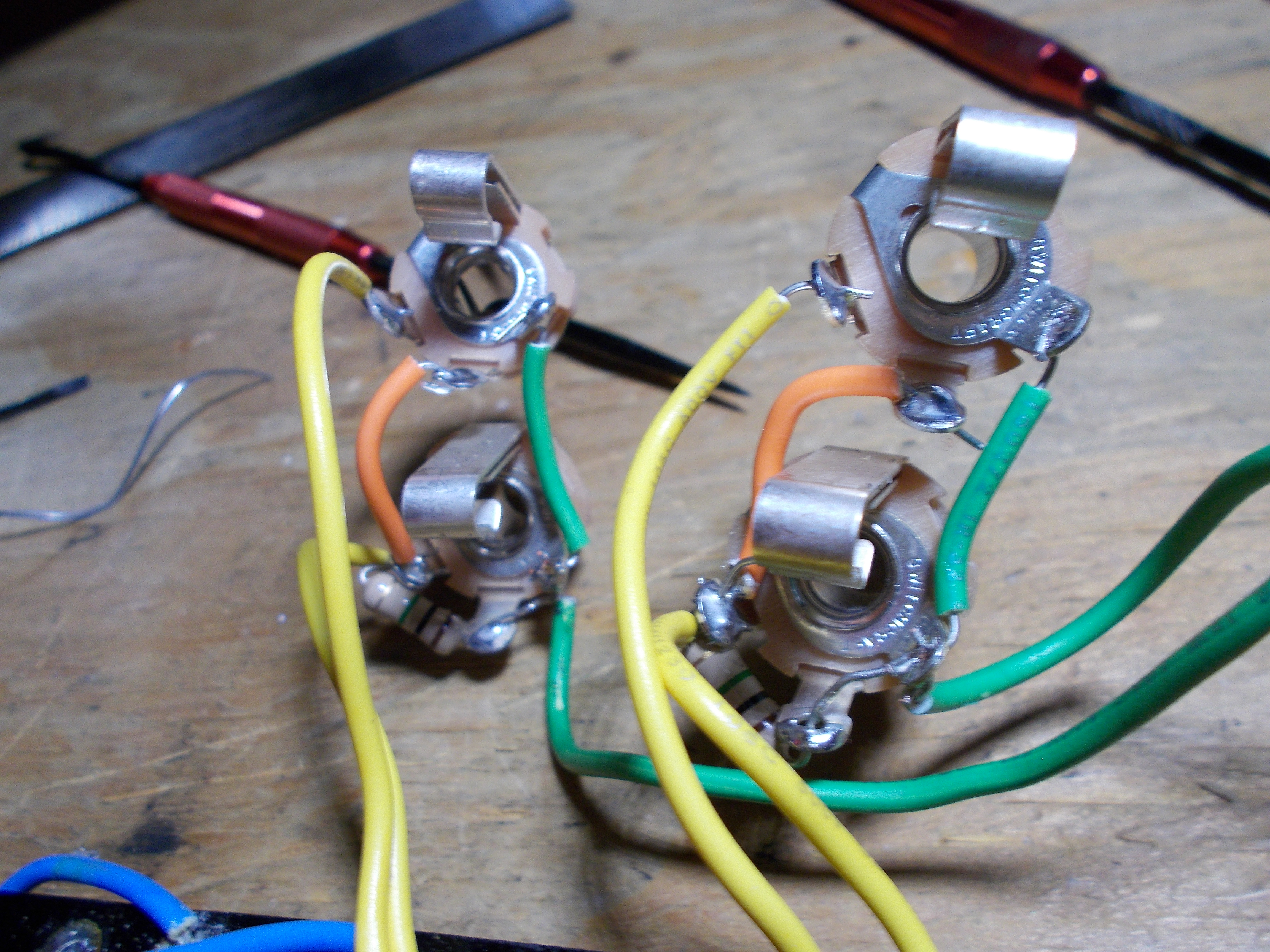

PostPosted: Tue Oct 30, 2018 3:28 pm
OK. All jacks installed in chassis. Both Bright and Normal jacks (tip; hot, switch and ground lugs) test the same when chassis ground from jacks are removed; continuity from chassis to ground lugs ONLY. With chassis ground attached (ground closest to jacks), Normal jacks test with continuity from ground lug to chassis only, but Bright jacks (tip; hot, switch and ground lugs) indicate continuity to chassis. (Was checking to make sure jacks were still isolated from chassis).
PostPosted: Tue Oct 30, 2018 6:55 pm
Found the problem. Bad solder joint on Switch lug of Normal-Hi jack. See picture in previous post.Thought I had corrected it , but have been concentrating on Bright jacks. Now, all jacks test the the same (grounded and ungrounded). Now for the scary part-VOLTAGES. Thanks for your patience. Hank S.
