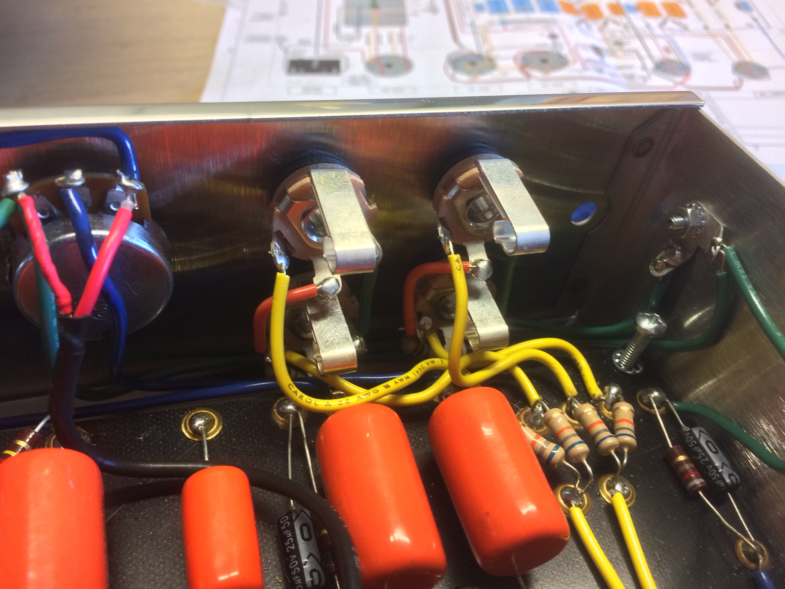

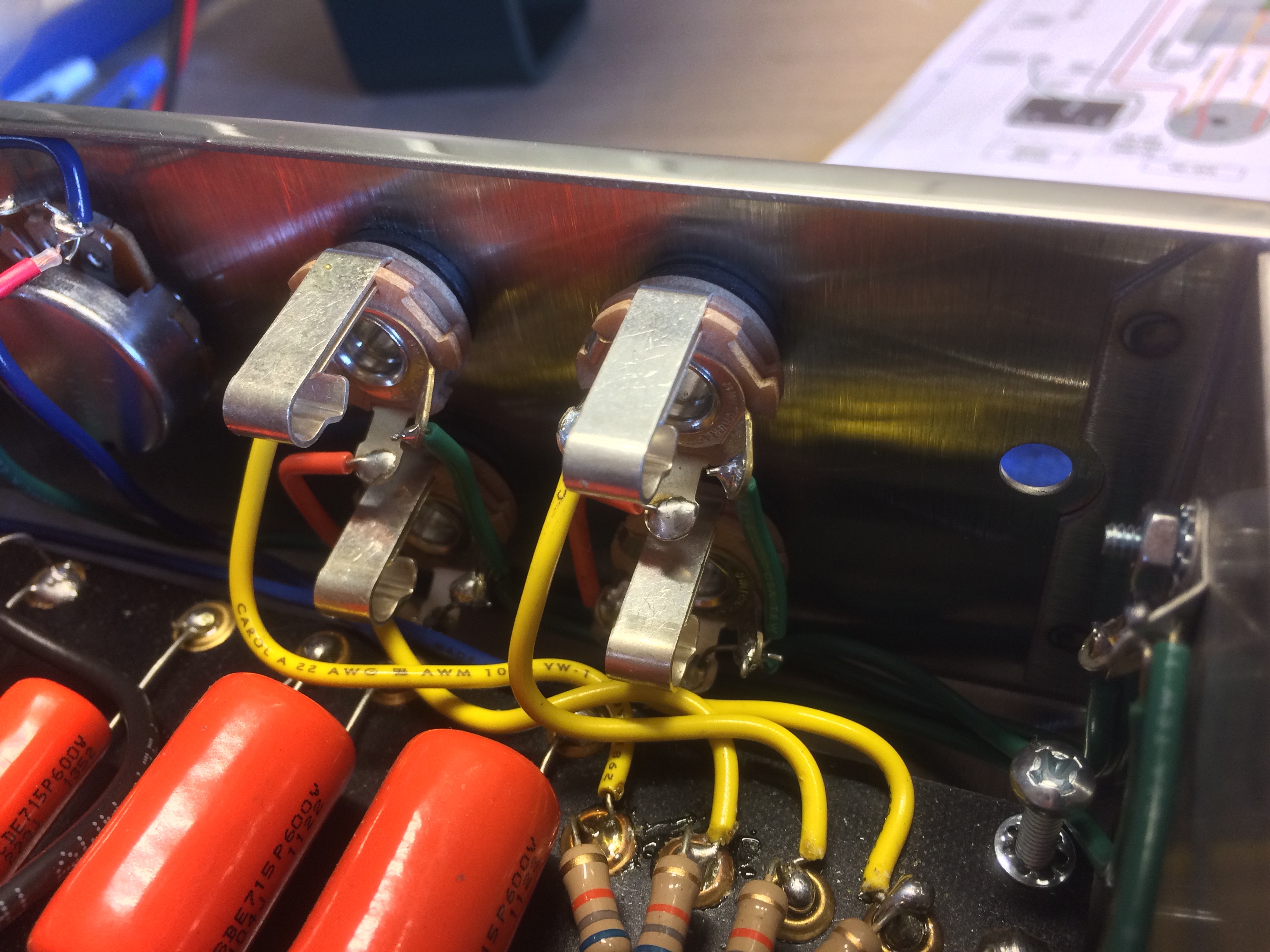

Input jacks
I get continuity between the chassis and all 3 tabs (Ground, Hot and Switch)?
Is this correct?

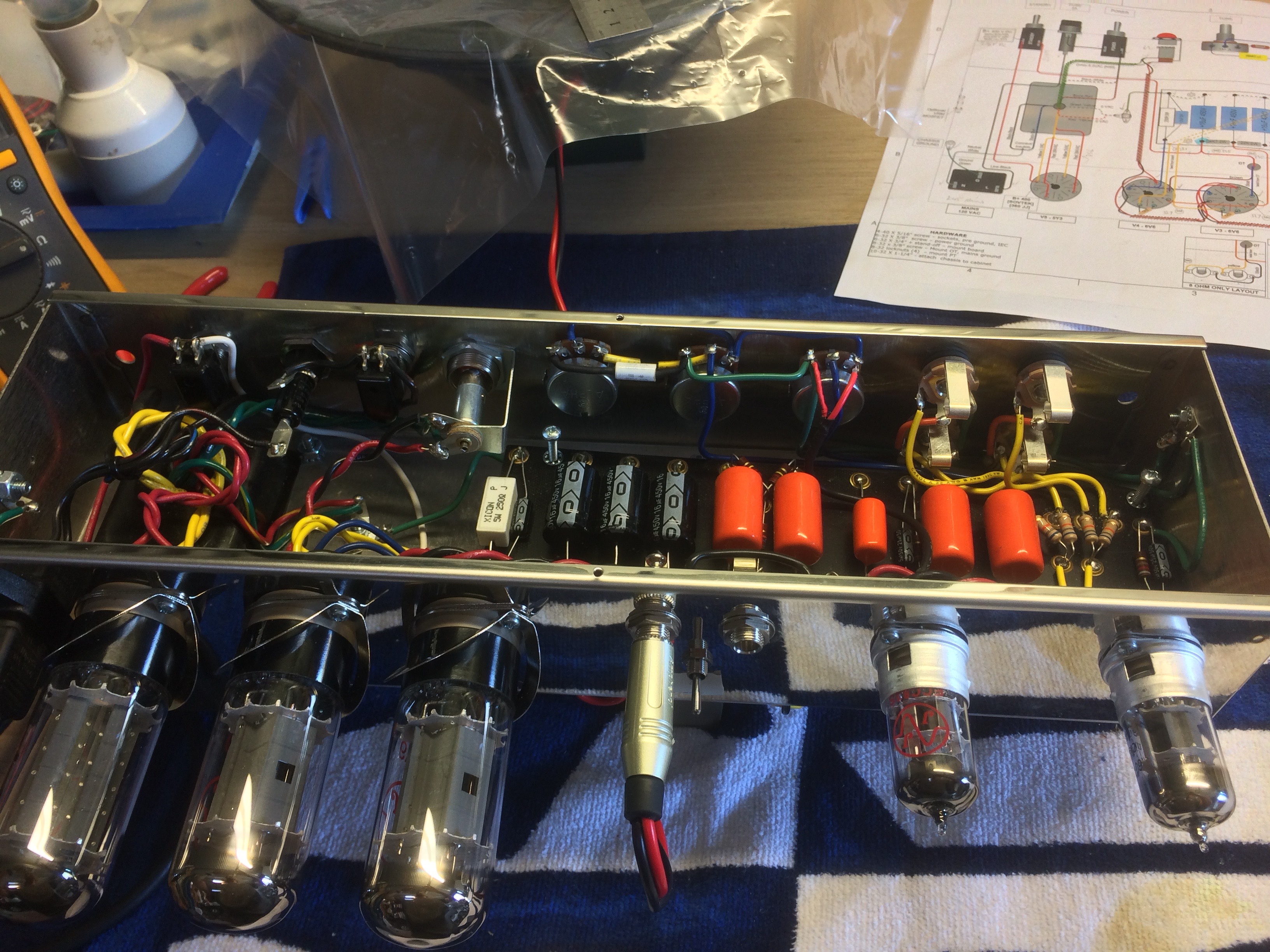

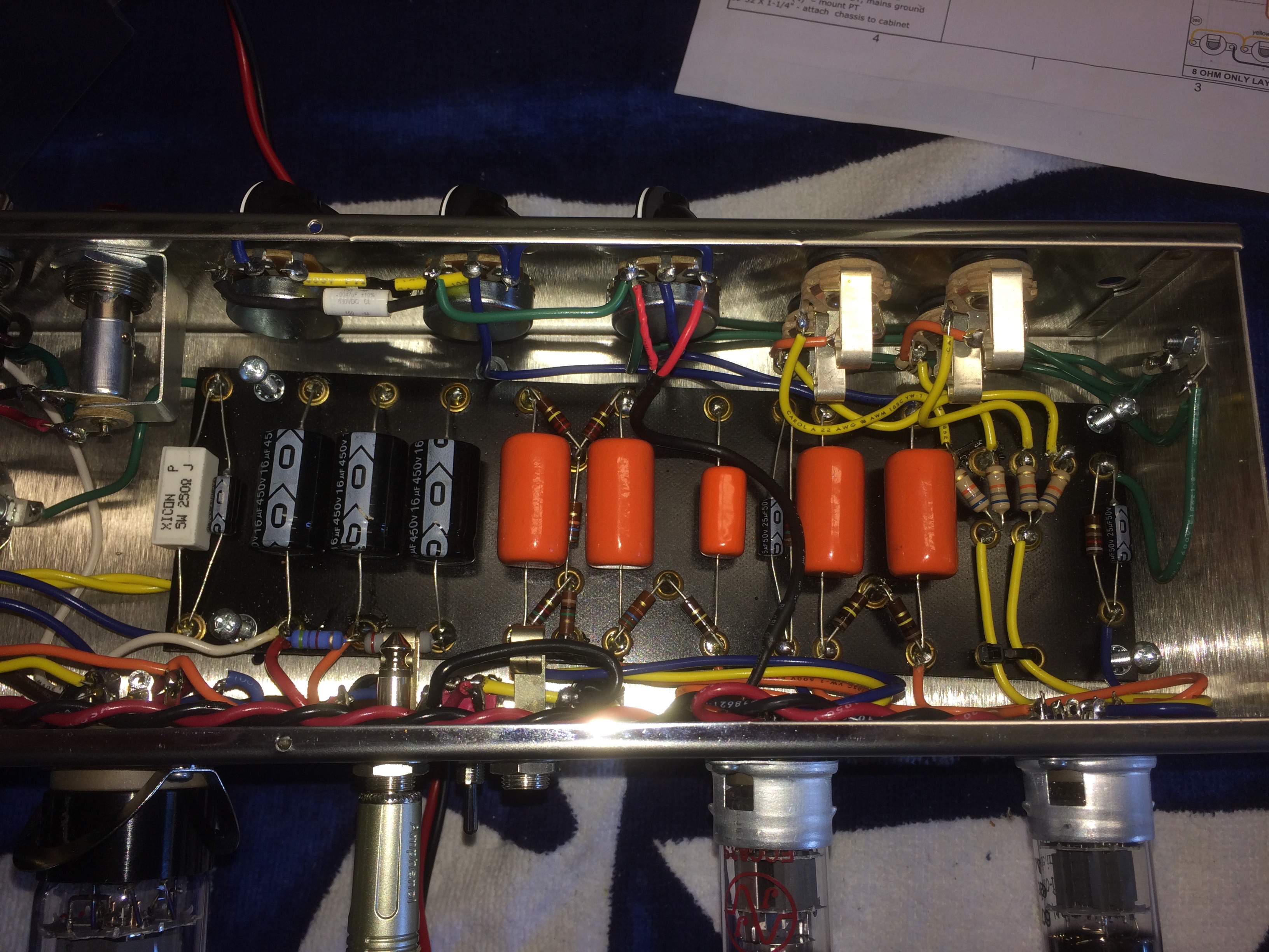

Soldering
My soldering doesn't look great in places,especially on the board. Looks like I've got things too hot and melted the flux in the solder??
I've check the continuity of all joins, all being around 0.1 ohm so i'm thinking they are ok.
Thanks for any help.

With a cable plugged in, you should not have continuity to ground from the tip of the cable. No cable, the inputs are grounded.

From those pictures are the standoffs for the board installed?

I was't getting a good volume and the bright channel wasn't working but its all sorted now. I had a poke around with a chopstick and found some dodgy connections. One on the coax and another on the .1uF cap running up to the bright channel.
