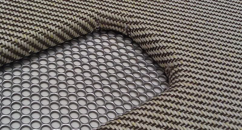

On another note, any idea where I can source this snazzy metal grill in Canada?

Nice grill but haven't seen that anywhere. I got some perforated steel at http://metalsupermarkets.com/store-finder/ a long time. ago. Expensive as I recall.
