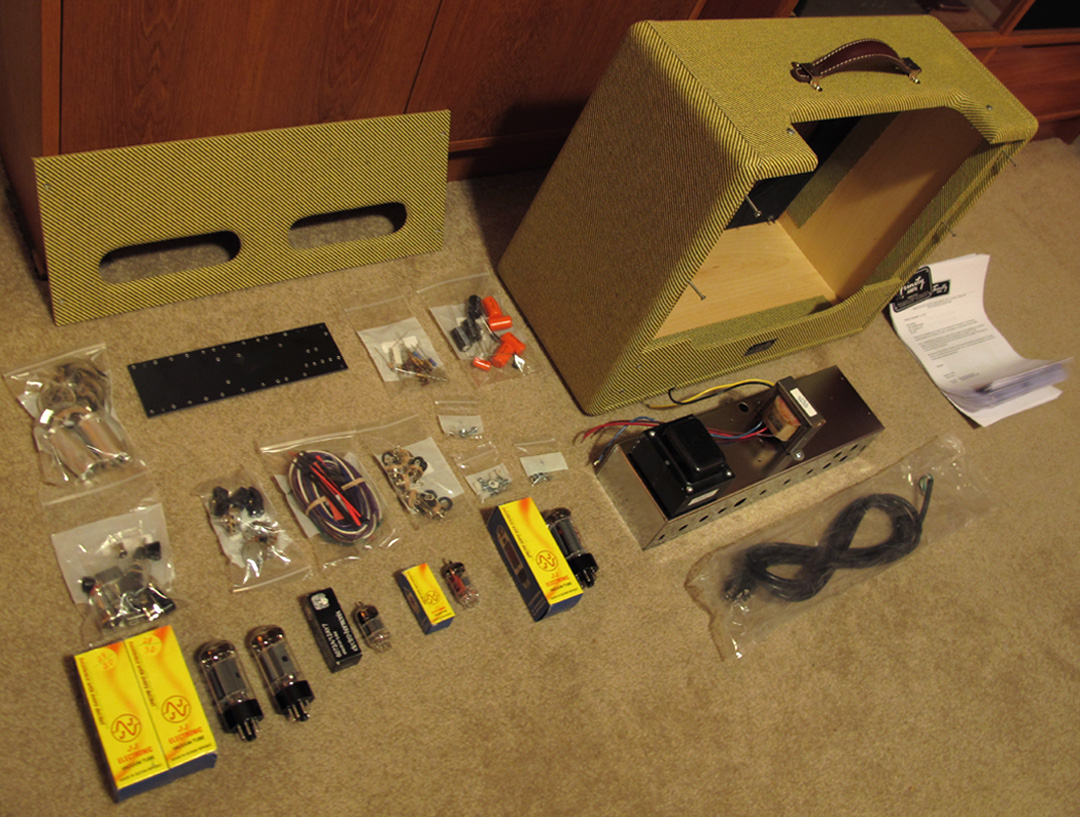

Everything arrived in one box, very well packed. The transformers were mounted to the chassis and the chassis was mounted to the cabinet. The electronic parts were packed in plastic bags inside the chassis.
The chassis, transformers and the rest of the electronic parts are all first-rate and the cabinet is a work of art.
The documentation that comes with the kit is excellent. There is a lot of background information as well as step by step instructions and photos for those who need them. I mainly just followed the layout drawing and the schematic. I checked the parts I received and found that everything was there.

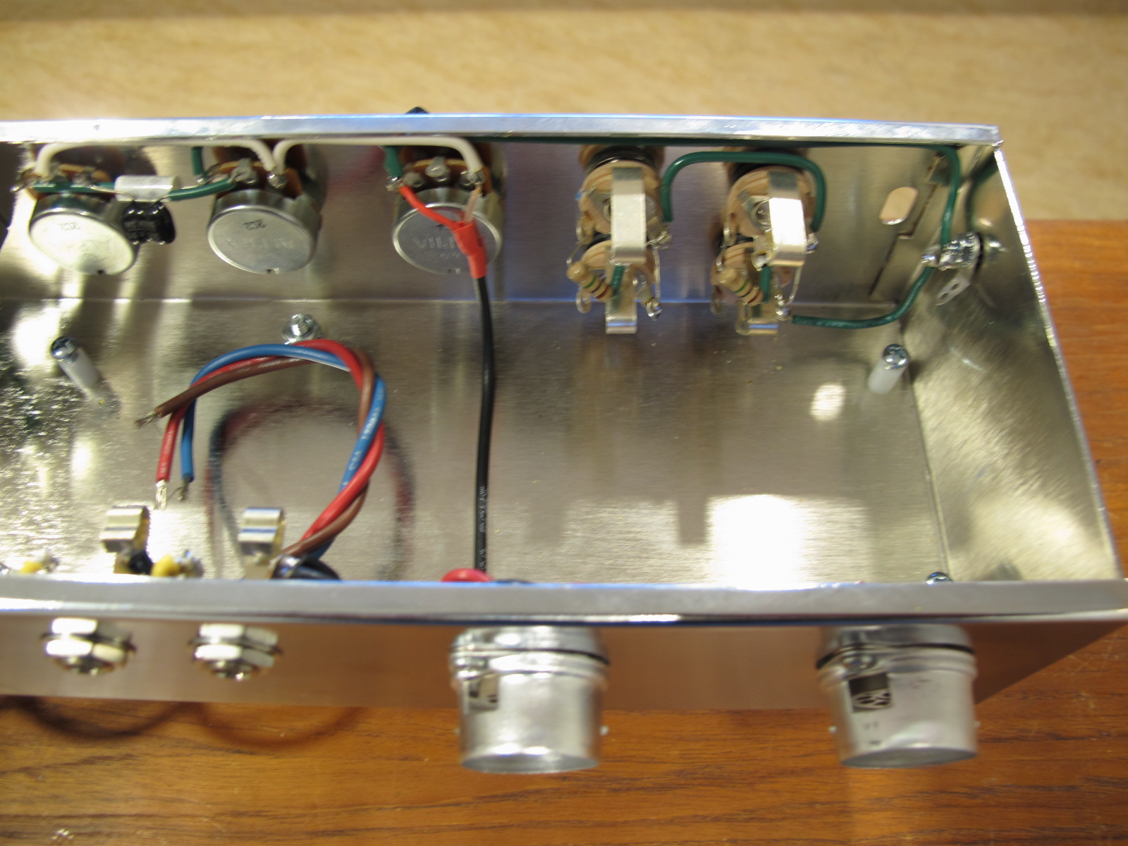

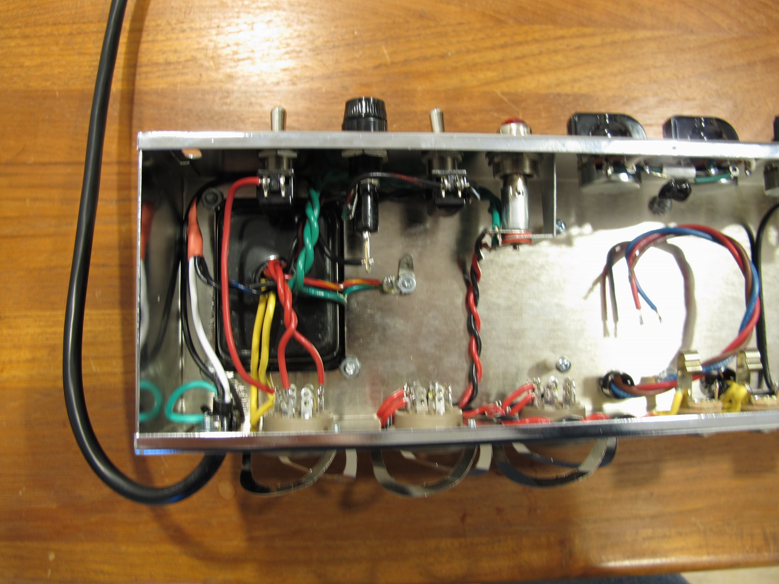

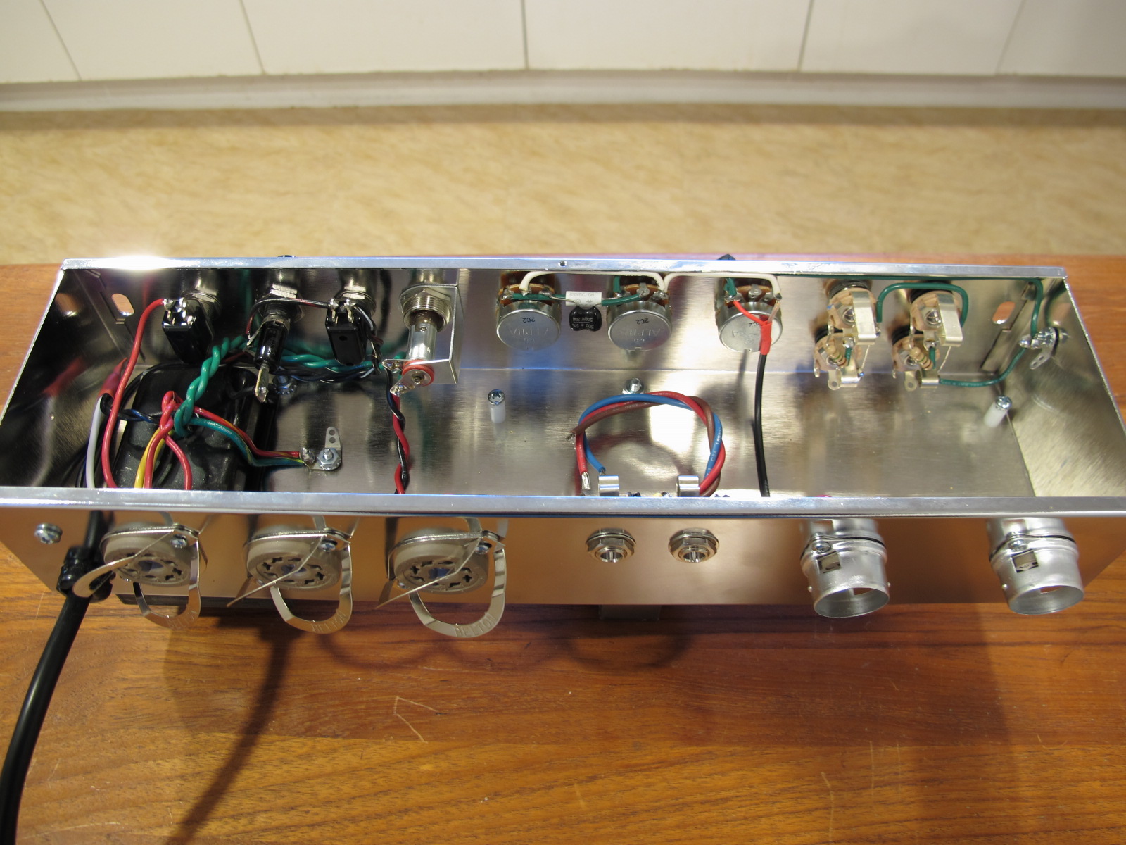

I began by installing all the tube sockets, pots, switches and jacks on the chassis. Then I wired up the AC, the power transformer, the heaters, the output transformer secondary, the jacks and the pots.
Now that the power supply was wired I could give the amp its first test. No tubes were in yet, of course. I double checked all the wiring I had done so far. Then I plugged in the AC cord and flipped on the power switch. The pilot light lit up. I measured about 6.3 VAC across the heater pins at each preamp and power amp tube socket. I also checked that there was about 3.15 VAC from each heater pin to ground. I measured 5 VAC across the heater pins for the rectifier tube. I also carefully measured the high voltage coming out of the power transformer at the rectifier tube's socket. Each leg read about 350 VAC with respect to ground.

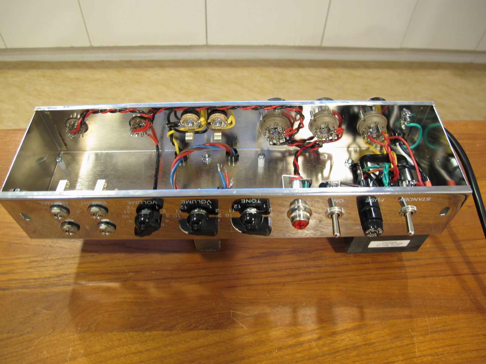

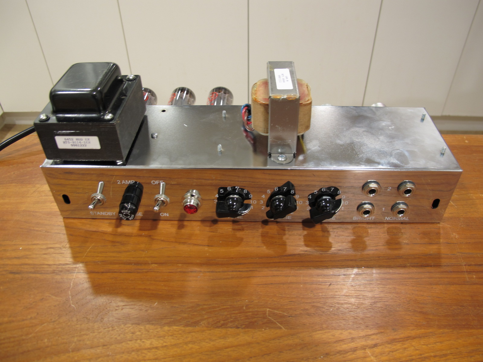

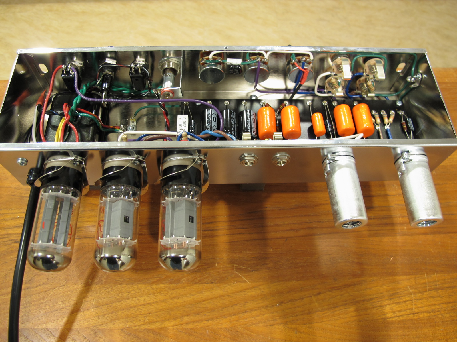

All that was left now was to attach the flyoff wires coming from the eyelet board to the tube sockets, pots and jacks.
The amp was now finished and ready for final testing. I checked my wiring very carefully. First visually using the layout, then I used an ohmmeter and the schematic to make sure everything that's supposed to be connected actually was connected. I did one more check to make sure there weren't any shorts and the polarity was right on all the electrolytic capacitors. All was good, so I plugged in the rectifier tube and applied power.
It passed the smoke test. It also passed all the voltage checks. I powered it down, waited for the capacitors to discharge, then I plugged in the preamp tubes. I powered it up again and they all glowed normally, there was still no smoke and all the voltages were still good.
I powered it down, waited for the capacitors to discharge, then I plugged in the power tubes and a dummy load. I applied power again. All the tubes glowed normally. There was still no smoke, no signs of red plating on the 6V6's and all the voltages were good. I powered it down again and plugged in a speaker and a guitar for the first time. I fired it up and it worked like a charm!

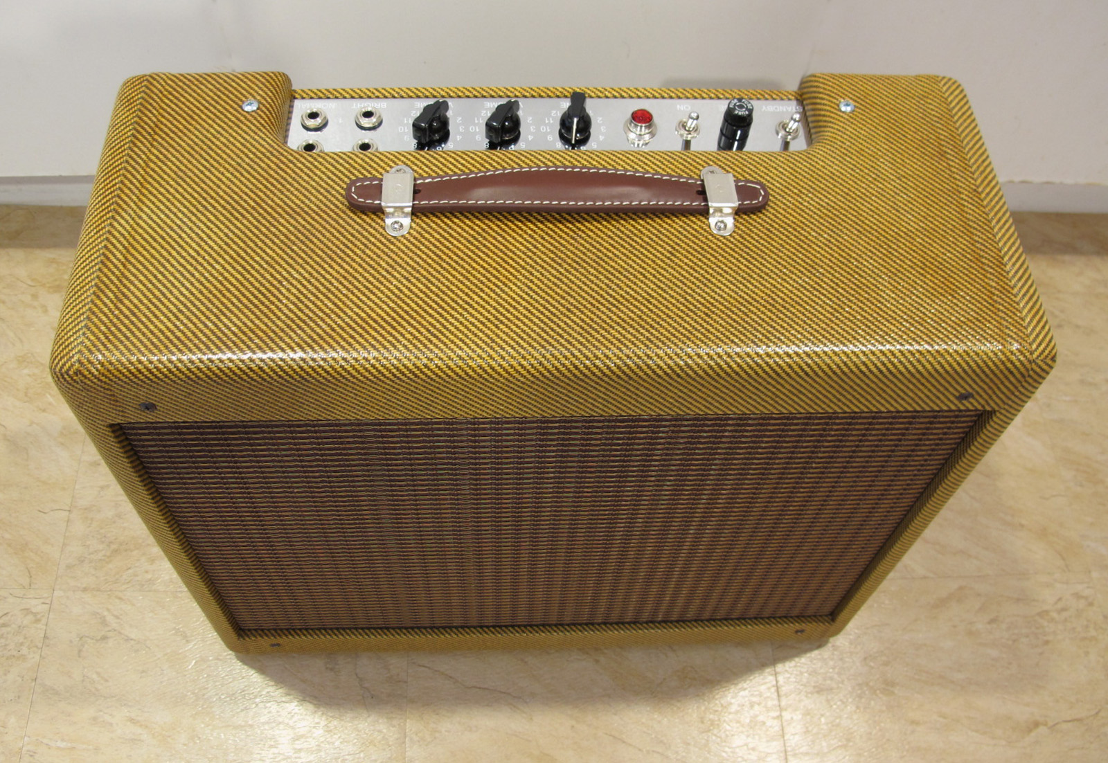

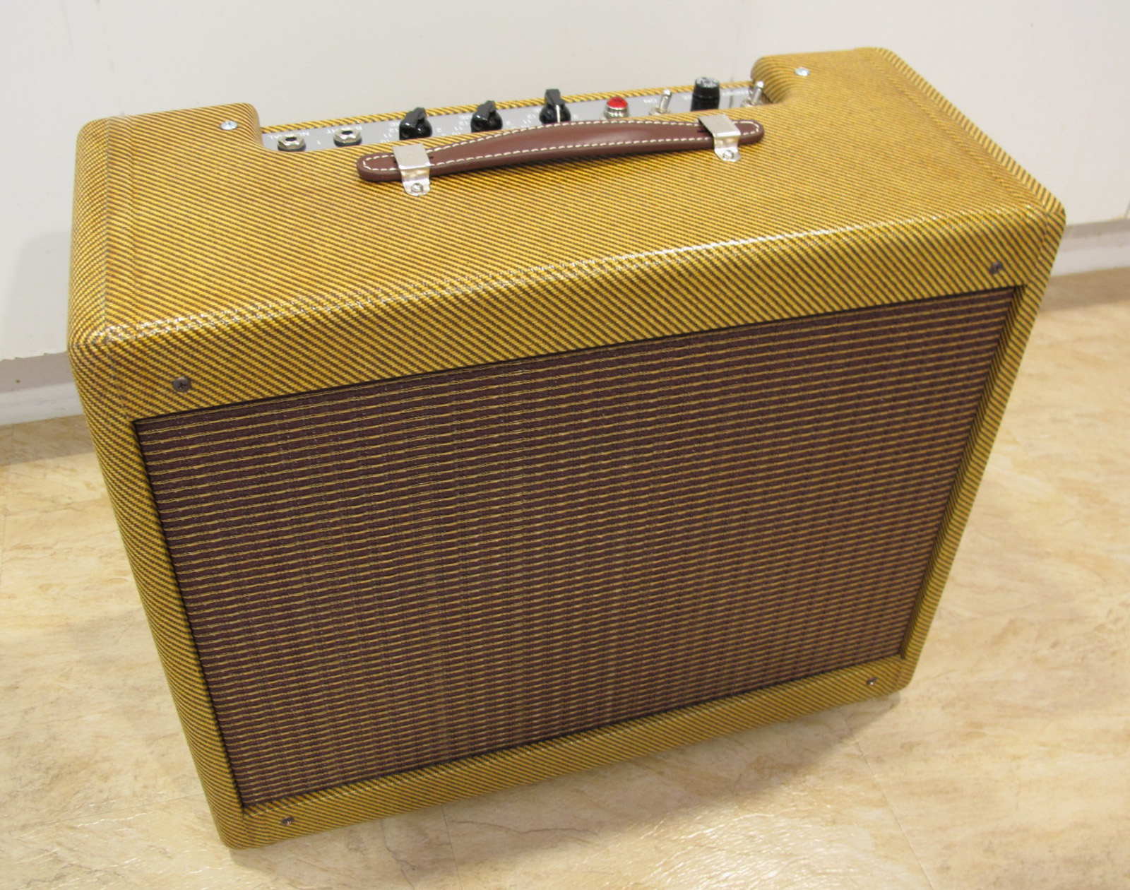

First I removed the handle, feet and speaker panel from the cabinet. Then I applied a couple of coats of shellac. I used Zinser Amber shellac mixed about 50/50 with Zinser clear shellac. I didn't want the cabinet to be too dark. I didn't want it to be really yellow either, the way the tweed looks naturally. This mix worked pretty well. It sealed the tweed and darkened it the amount I wanted. I applied it with a brush and sanded with 220 grit paper after each coat. Then I sprayed on four coats of clear lacquer inside and out to give the cabinet a tough durable finish.
It was easy enough to do the finishing, but I didn't really save enough money to justify me doing it instead of Trinity.

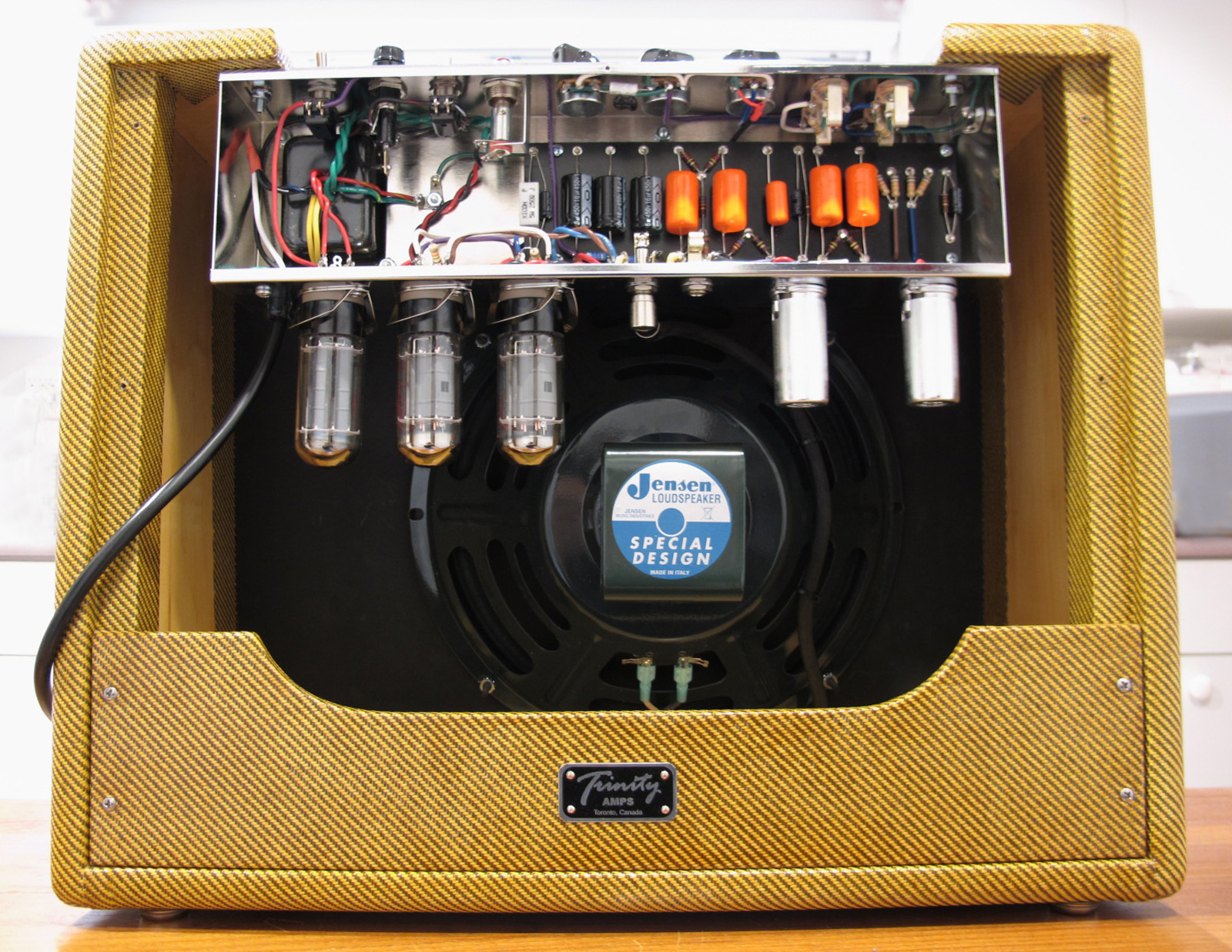

I re-installed the handle, feet and speaker panel. I mounted the chassis and a speaker in the cabinet. I used a 12" Jensen P12Q like the originals had.
I put on the back panel and the project was done!
The kit went together very well and it worked the first time. It was a lot of fun to build, too. I've had a chance to use this amp for a few weeks now. It sounds great and I can see that I'll also have a lot of fun playing it. I don't hesitate for a moment to recommend Trinity to anyone who wants a great amp, especially if they want the pride that comes with building it themselves.

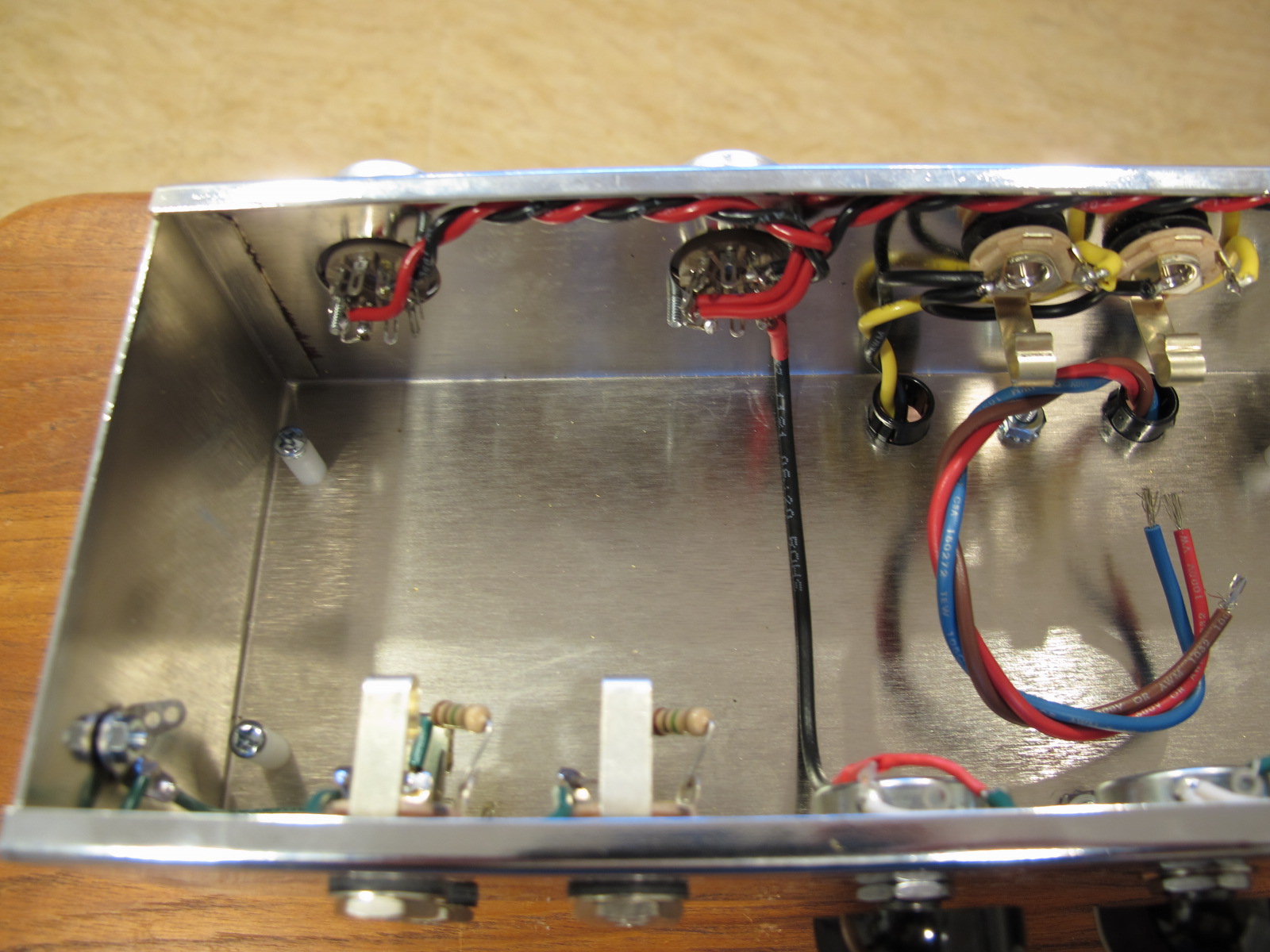

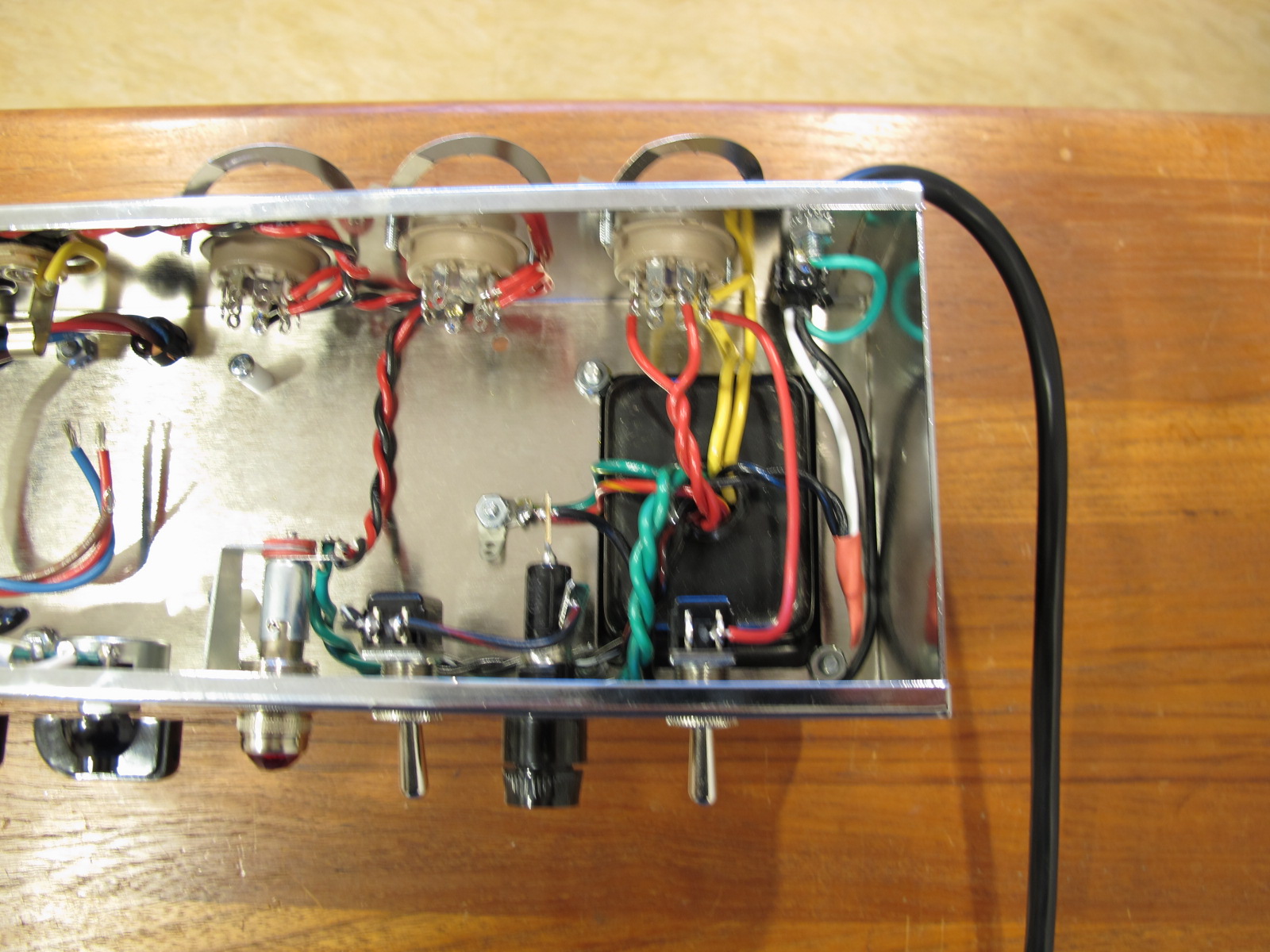

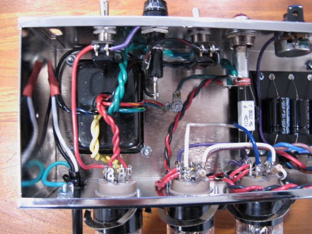

While I was in there I neatened up a few of the wire runs. I thought I got it pretty good the first time, but then I saw Olivia's pictures!
