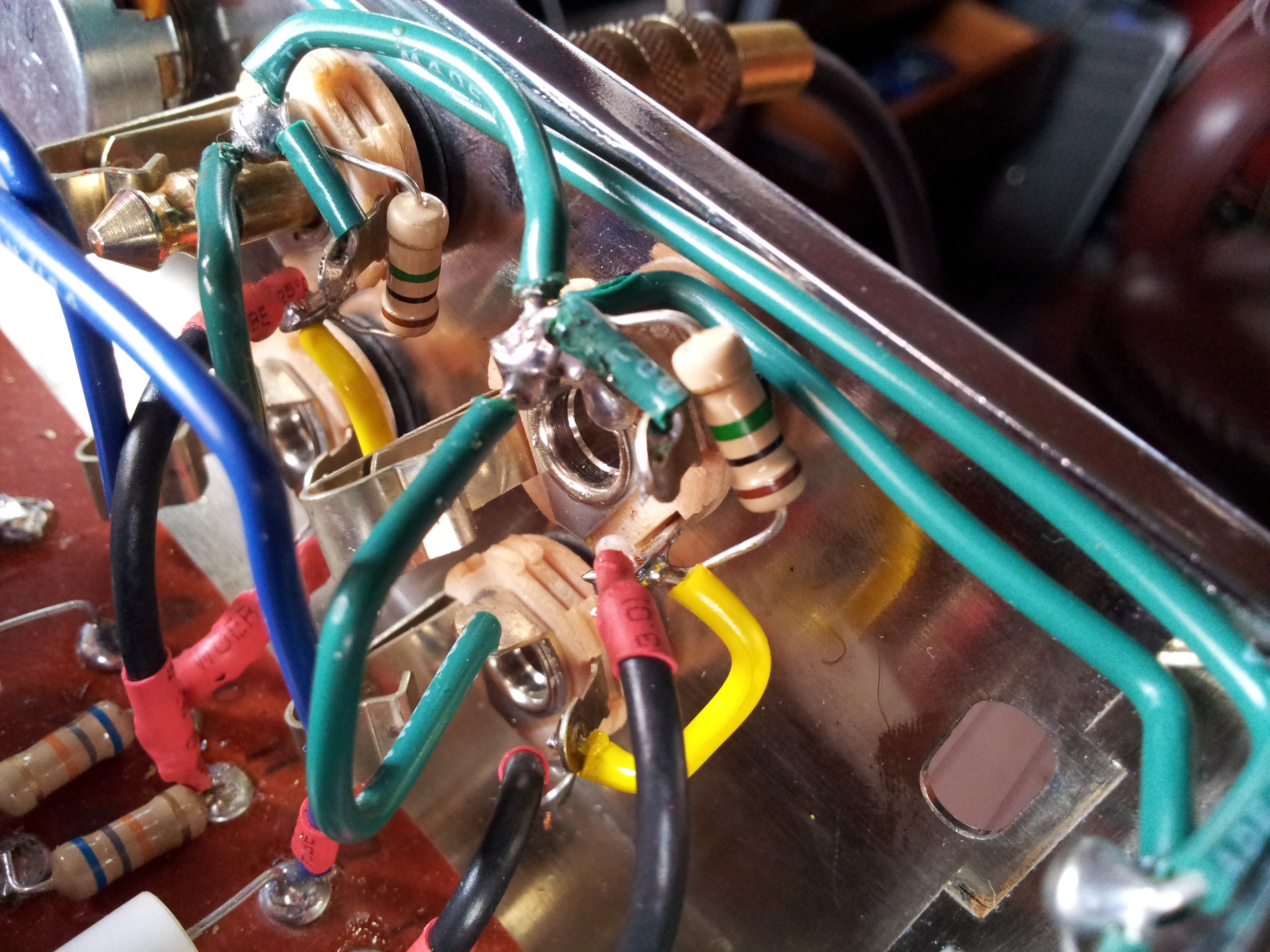

The really weird thing is the following....
Im getting really low volume and very opaque sounds when im plugged into the BRIGHT channel. On Normal it sound trully amazing, but when plugged into the bright channel i just get a very low volume pretty UNBright sound.
Any ideas?

This is a close up pic of my inputs

NEVER MIND GUYS..... MY STUPIDITY WAS RAPIDLY SHOWN!!!! JAJAJA
The cable from the Bright Volume Pot somehow became lose... Just soldered it and....
Holy crap it sounds good.... The voltages are still kinda weird as i posted before. But still... it sounds amazing!!!!!!!! :D
