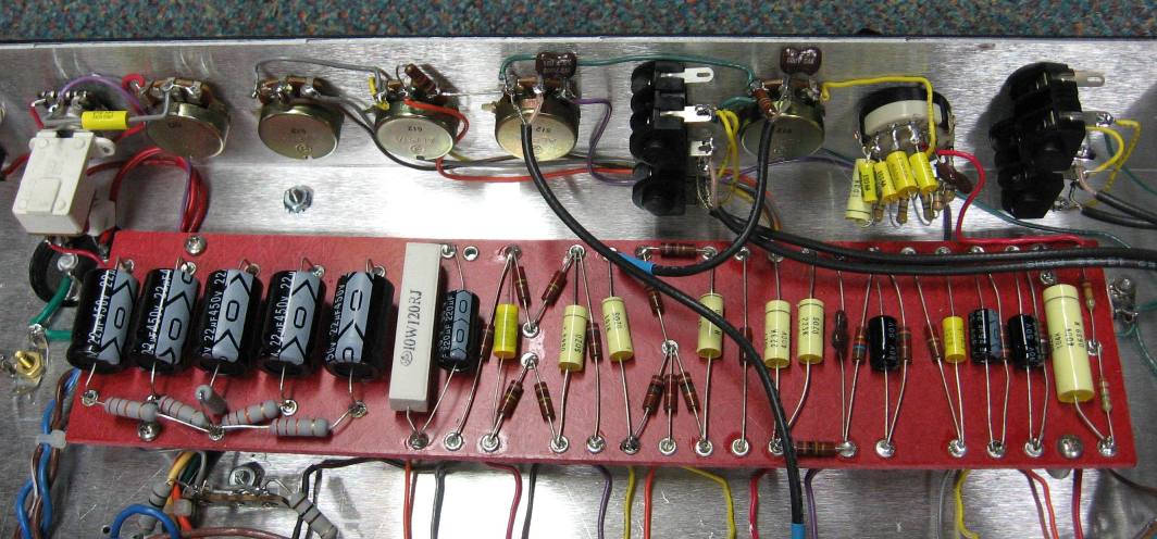

TC-15 Production Build Underway Inside

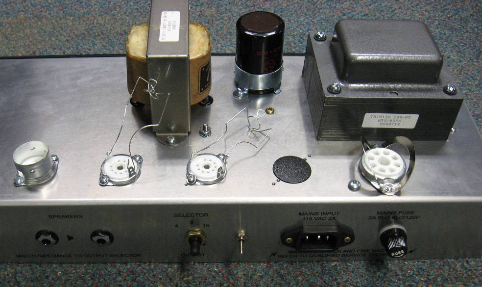

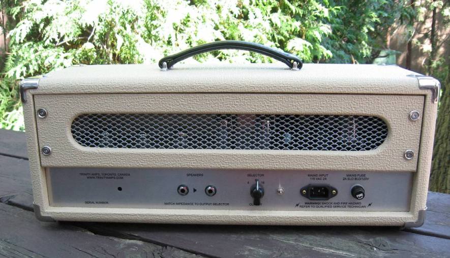

Note the two output transformer leads to the rear toggle switch. You can choose a 'Smooth' sound (8K) or a sound with an 'Edge' to it (5K).
Also, you can see there are no nuts to fasten the sockets. The New chassis is tapped for the screws!
TC-15 Production Build.
Note the NEW Silk Screened chassis.

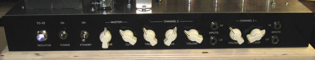

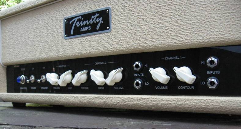

TC-15 Production Build - Black Gloss Panel / Silver Lettering.
Master Volume has a Pull - On switch on builds. Builds also have large coloured jewel indicators running off 6.3VAC.

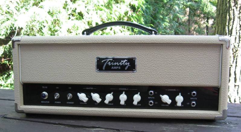

This particular build will have cream knobs to match the Fender Rough Blonde tolexed custome cabinet.

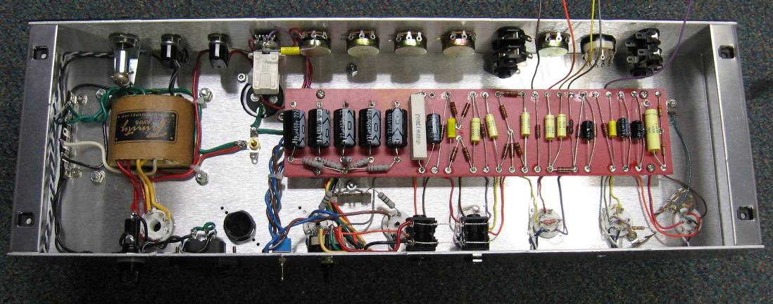

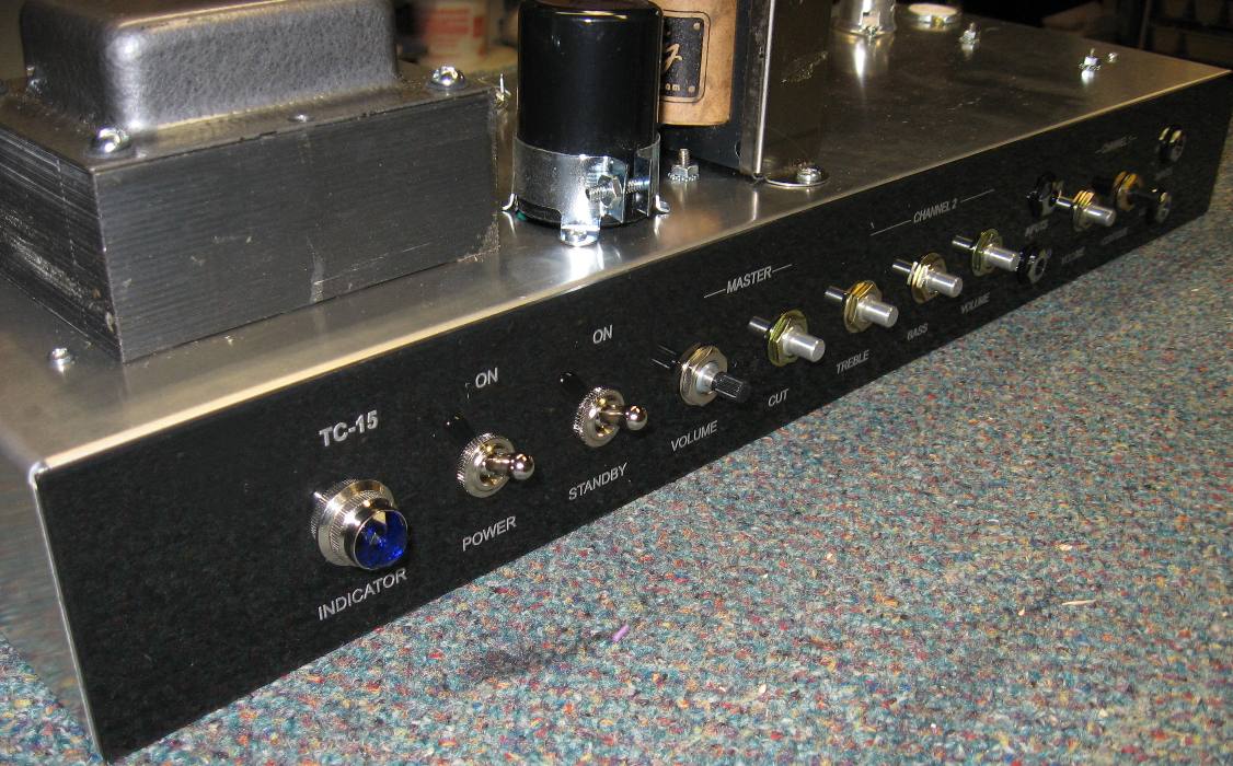

TC-15 Production Build - Overview
The amp is quiet as a mouse!
TC-15 Production Build - Control Side
The Tone Contour Switch is always a challenge!
TC-15 Production Build - Tube Side
Notice the Blue transformer impedance toggle switch?

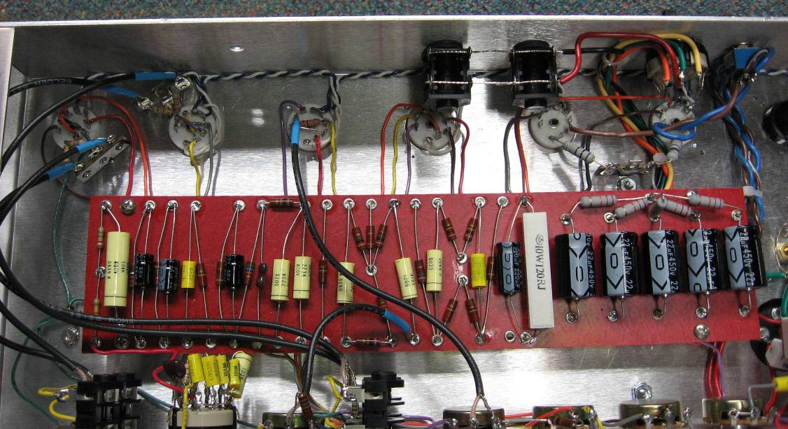

Coax cables keep the noise down.
TC-15 Production Build - Power Supply
Cream Knobs Too!
Large indicator light is for production builds.

Quick question tho... push/pull on master does what?
PostPosted: Wed Aug 22, 2007 6:32 am
The switch Bypasses the Master Volume. Pull - On: Master Volume control engaged. Push - Off: Out of Circuit.
Special on production builds, but easily applied to any amp with a Master Volume.

Looks great , Coco! 8)
When are ya gonna do a Tc-v6 ? :wink:
