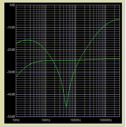

Thought this would be of interest to some. These are frequency response simulations of the Trinity15 Tone Stack.
Trinity 15 Tone Stack - all controls set to middle position
Trinity 15 Tone Stack - Sweep Bass; Treble in middle position
Trinity 15 Tone Stack - Sweep Treble; Bass in middle position

Fantastic. I'd like to see what it look like with both controls at zero.

These are frequency response simulations of the Trinity15 Tone Stack. All controls Minimum is the Flat Curve. All controls Maximum is the notched curve. Interesting..
Trinity 15 Tone Stack - Controls set to Min or Max positions
