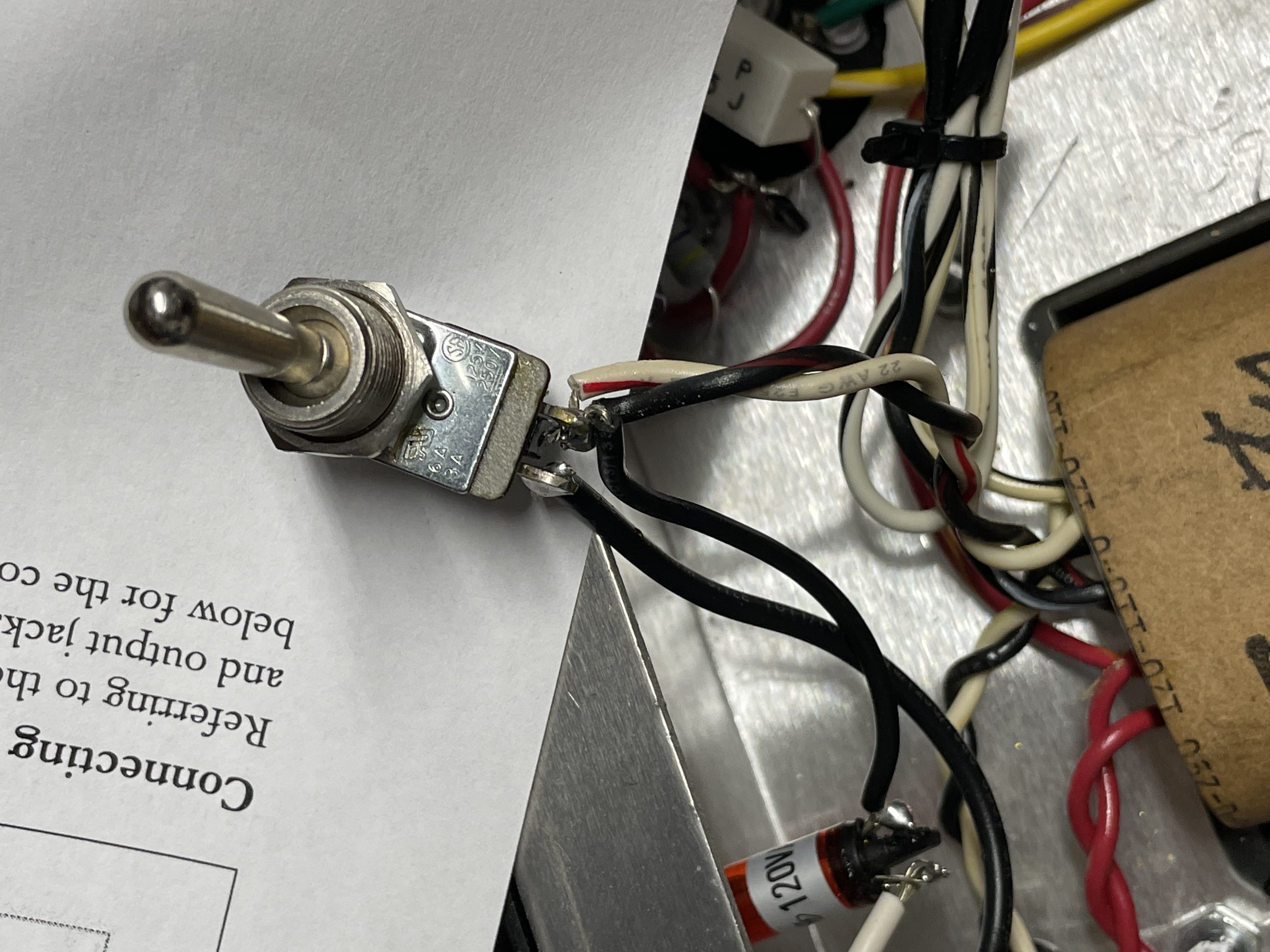

It's impossible to tell from the videos but do you have the 120V primary leads connected correctly. Black-Red and White-Red are connected together at one Power Switch lug. I do see the Black & White correctly connected to a lug on the terminal strip and then to the Neutral. In your earlier post, I recall you had the wires going to the power switch mixed up which might cause a problem if it was turned on (Never tried that!)

Thanks. Here’s a pic of that connection. I’ve unmounted the switch and flipped it around. The installed orientation has the PT leads and the wire to the lamp on the left. I just followed the layout drawing.

PostPosted: Thu Oct 27, 2022 3:41 pm
It looks correct for 120V. So, you'll need to disconnect the secondaries ( or make sure they are not connected to anything) and turn it on to see if it blows the fuse. If it gets hot, blows the fuse etc., there is an issue with the PT.
