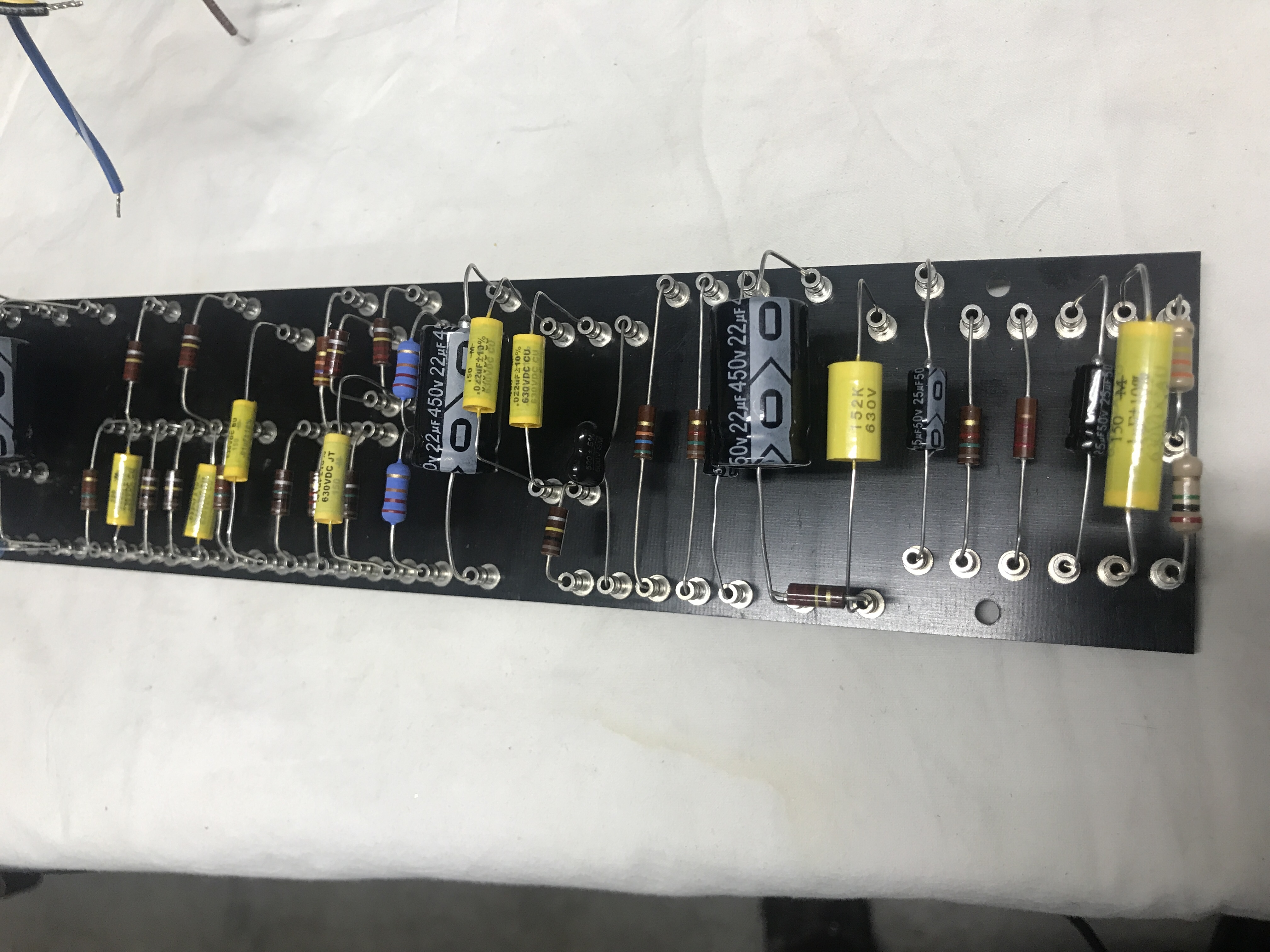

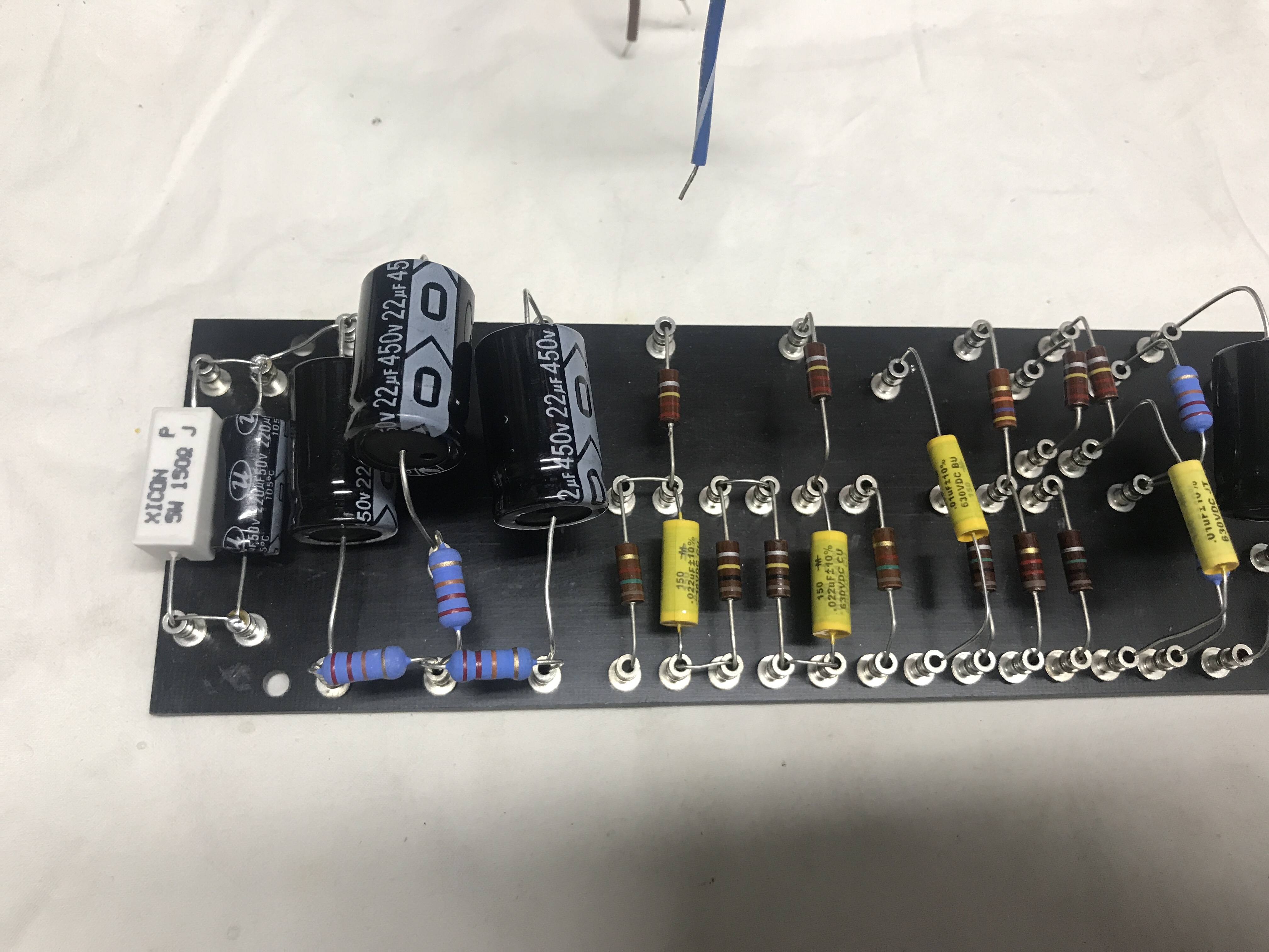

I'm going to create a separate thread about the voltage/circuit breaker issue and post some pics there. In the meantime, here's my turret board with everything (hopefully) in the right place, but with untrimmed leads and only a few turrets soldered. Also don't have all the jumpers or ground bus on it yet. If anything looks bad or wrong, I'd appreciate the feedback.
