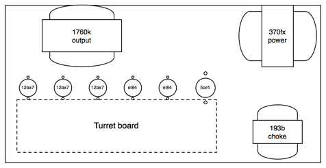

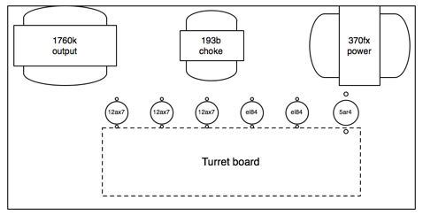

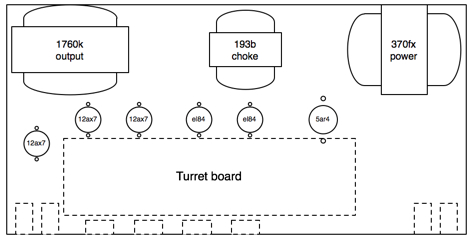

I finally have everything I need to get going on my build!
However I'm struggling with the layout. I'm worried about the preamps being close to the output transformer and equally worried about the output being too close to the power. I've used the headphone trick to determine that the OT needs to be as far away as possible from the PT. (The chassis is quite small for the massive size of these transformers!) I know there's always going to be compromises but I'm struggling to determine which ones are best.
I've come up with 3 possible layouts. Can anyone comment on which is best or recommend an alternative?
Layout 01 - facilitates the neatest wiring, but has noticeable 60hz hum
Layout 02 - gives a quiet output, but puts preamp 1 very close to the OT
Layout 03 - also gives a quiet output and keeps the preamp tubes far away from the OT, but makes for tricky wiring
Any thoughts?

First question is what amp are you building cause the 370fx seems a little over kill for those tubes. (NM I'm assuming you all ready have these transformers) and I assume your gonna be playing with the plate load to make it 4 8 16 r output impedance to get an 8K load
And what are the chassis dimensions
Was thinking like a trainwreck layout like half a rock it. check out Ceri@tone pictures (layout)

need more information. amp, size etc.

It's a lightning basically, mostly following the Trinity 15 schematic. Yes I have the transformers (and everything else) already, including a 16x8x2 chassis.
I'm only planning on using the 4r output and I will plug an 8r speaker into it to get the 8k load.

No ef86 (1 channel) ?
The trainwreck chassis is 17x8x2.5 (not sure on the 2.5) but you have the right depth so 1 inch less length and two el84's less
An idea of what it looks's like.
I'm not telling you what to build (no expert in layouts) just giving you more ideas. :D
PostPosted: Thu Feb 12, 2015 7:49 pm
You can move the rectifier and choke to the transformer side and then line up the rest of the tubes in a line.
