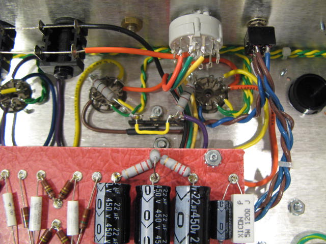

Thanks for your responses so far! I have uploaded pictures of the inside front & inside back.
Here is a view of the inside/back - http://anthonycravero.com/gallery/index.php?level=picture&id=293
And here is the inside/front - http://anthonycravero.com/gallery/index.php?level=picture&id=292
You can enlarge by clicking the photos on the site. Check out the two pots (varitone & impedance selectors) and let me know if I need to get a different part for one of them. They both look similar, and I believe are the "Lorlin" switches you're talking about.
PostPosted: Wed Sep 11, 2013 12:49 am
Looks like you have the two rotary switches right. My TC-15 is the same vintage as yours and on mine the 6-position Contour switch has a black and white body, too.

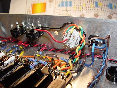

Here are a couple of pictures of the impedance switch in my TC-15. If you have a two-pole switch this might help with your wiring.
You can tell how many poles (individual sections) the switch has by how many terminals it has near the center of its body. A one-pole switch will just have a lug labeled "A". A two-pole switch will have lugs labeled "A" and "C". A four-pole switch will have lugs labeled "A", "B", "C" and "D". These are the common terminals and will be connected to the numbered terminals near the outer edge of its body depending on the position of its shaft.
It's a bit confusing until you get used to working with rotary switches. This switch style can be anything from a one-pole 12-position to a four-pole three position.
First you have to use the tang washer to limit the switch to three click positions as it says in the manual. I used pole A on the switch, so the lug marked "A" is the common terminal. I wired that lug to the speaker jacks.
I wired the yellow (4 ohm) lead from the output transformer to lug 1 on the switch, the green (8 ohm) lead to lug 2 and the orange (16 ohm) lead to lug 3.
If you have an ohmmeter you can verify that with the shaft fully counter clockwise, lug A has continuity to lug 1. The next click clockwise should connect lug A to lug 2. The next click clockwise should connect lug A to lug 3. This should be as far as you can click the shaft clockwise if you have the tang washer in the proper position.
I hope all this makes sense!

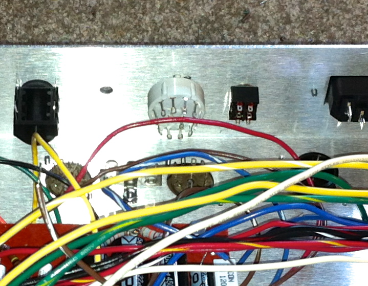

Here is a pic of how I wired mine that shows the speaker jack connections as well as the rotary switch. Hope this helps!
