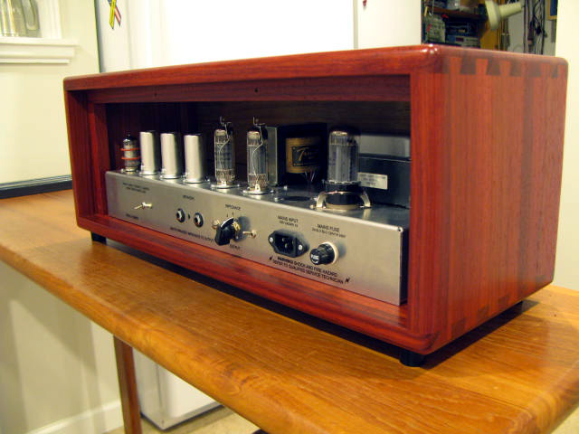

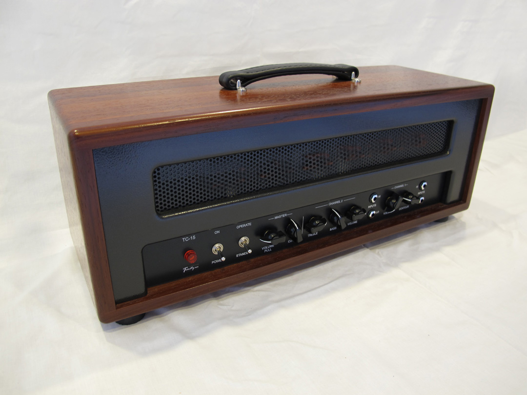

Here are a couple of pictures of the finished amp. I built the cabinet out of solid African padauk wood. I'll post a couple of more messages with other pictures taken during the build, too.

I've had a chance to use this amp for a couple of years now and have a lot of fun playing it. I don't hesitate for a moment to recommend Trinity to anyone who wants a great amp, especially if they want the pride that comes with building it themselves.

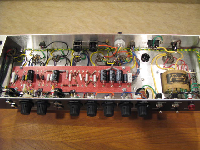

Here are a few photos taken while building the chassis.

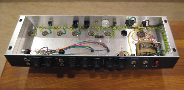

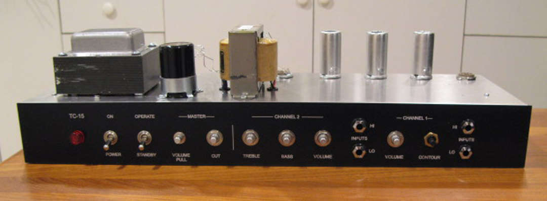

I began by installing all the tube sockets, pots, switches and jacks on the chassis. Then I wired up the AC, the power transformer, the heaters, the output transformer secondary, the jacks and the pots.

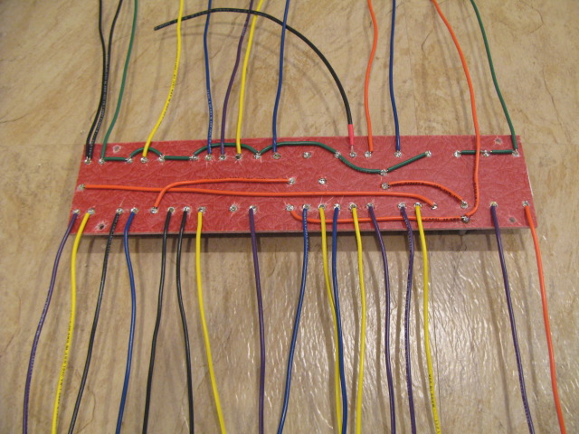

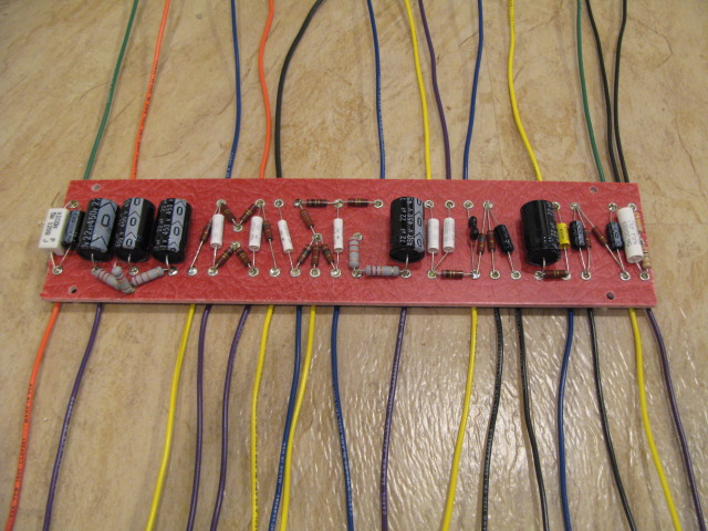

I started working on the board next. I see the new kit has a fancy black turret board. This one just has a red board with eyelets. I installed all the wiring on the bottom side, then I started working from left to right installing the resistors and capacitors on the top side. I also attached all the flyoff leads using the lengths recommended in the assembly manual.
All that was left now was installing the board and wiring it to the tube sockets and pots.
I did the final checks, installed the tubes and checked it some more. Everything was good. It worked the first time and sounded fantastic when I plugged in a guitar and a speaker!

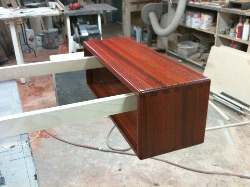

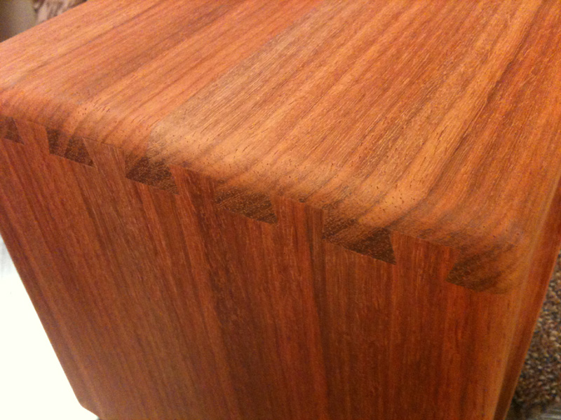

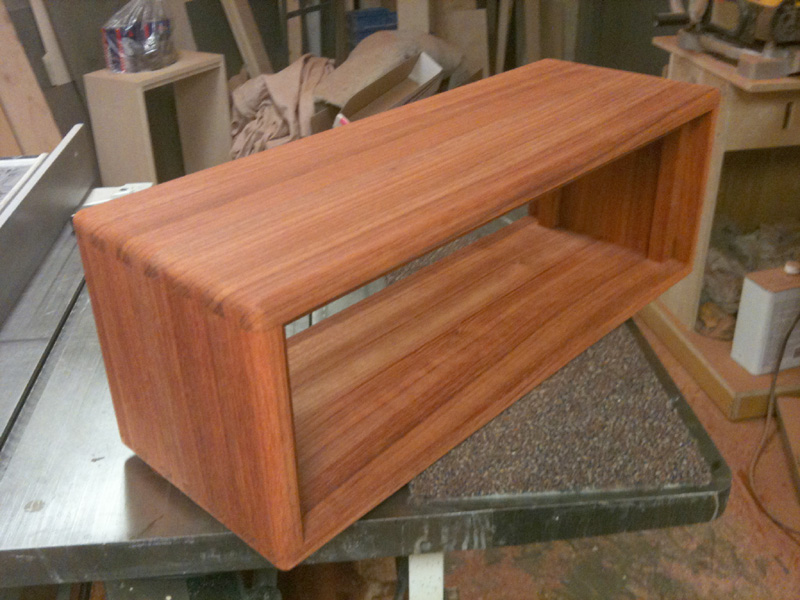

Here are a couple of pictures of the assembly. I've already planed the wood to final thickness, cut the pieces to size and routed dovetails on the joints.
Rounding all the edges with a router and sanding came next. It's pretty hard to build an amp or speaker cabinet without a router. I have several!

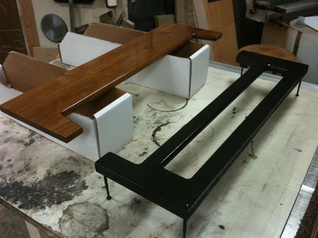

I finished the cabinet by spraying on five coats of clear lacquer.

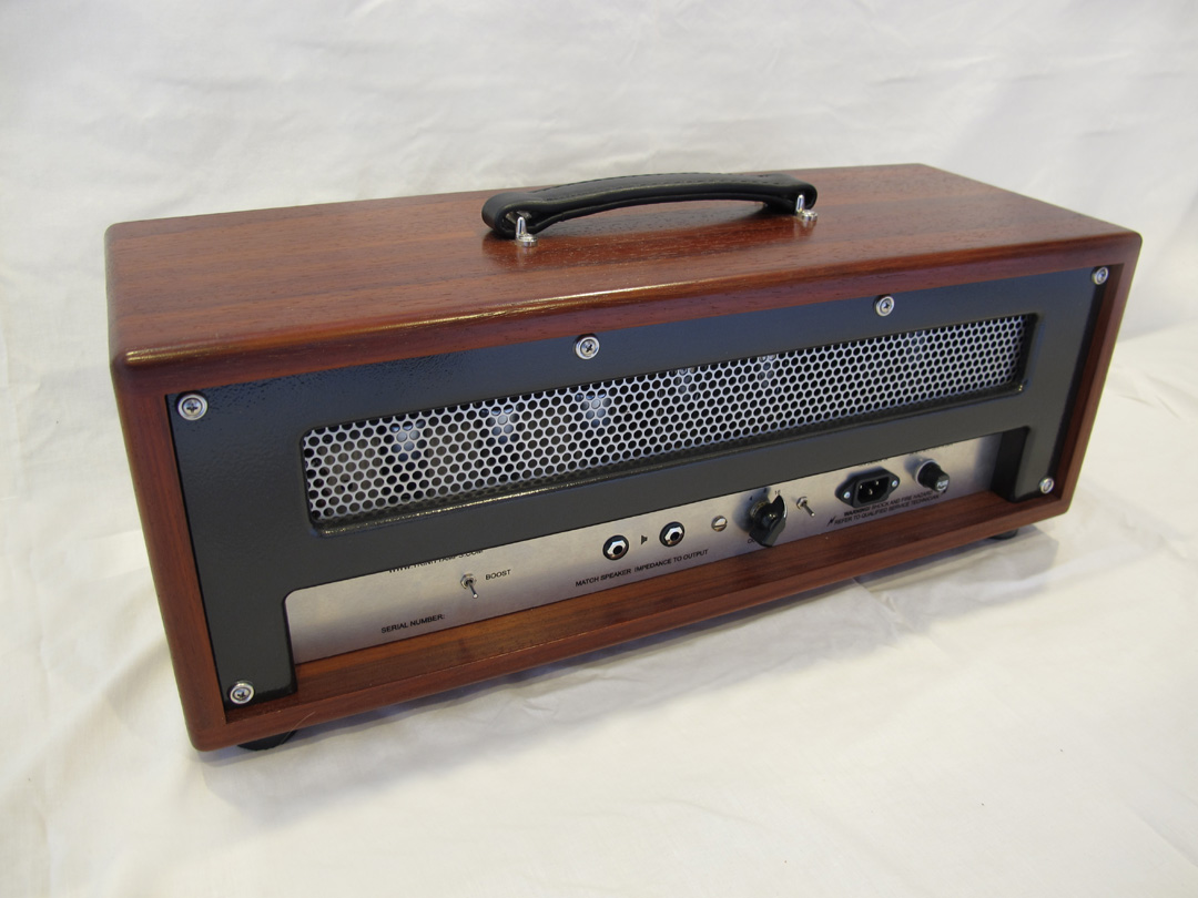

I finished the front and back panels by spraying on three coats of hammertone paint. The vent grills are just perforated steel. The front one was spray painted black, the back one was left natural.

I installed feet and a handle, bolted in the amp chassis and the project was finished!

Yes, I did put a small Trinity logo on the chassis under the pilot light. I wanted to prominently display a Trinity logo on the front vent panel but I wasn't sure how they felt about their name going on a cabinet they didn't build.
For now I just have my name on the vent panel. I cut the letters out of some leftover padauk wood with a scroll saw. It does need something on the front grill to break up the blackness.
It's a Trinity amp, though, and I'm happy to give them credit.
