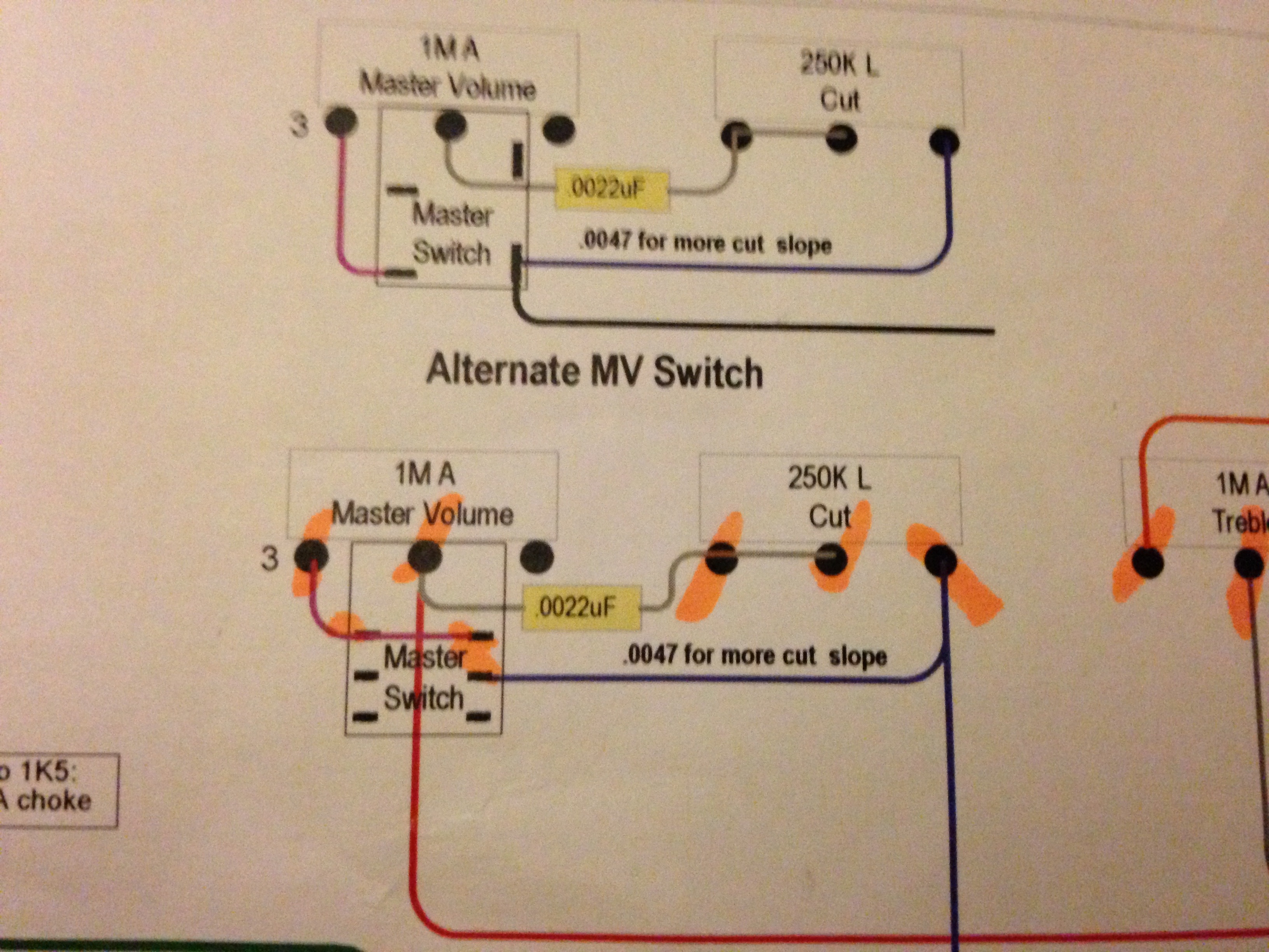

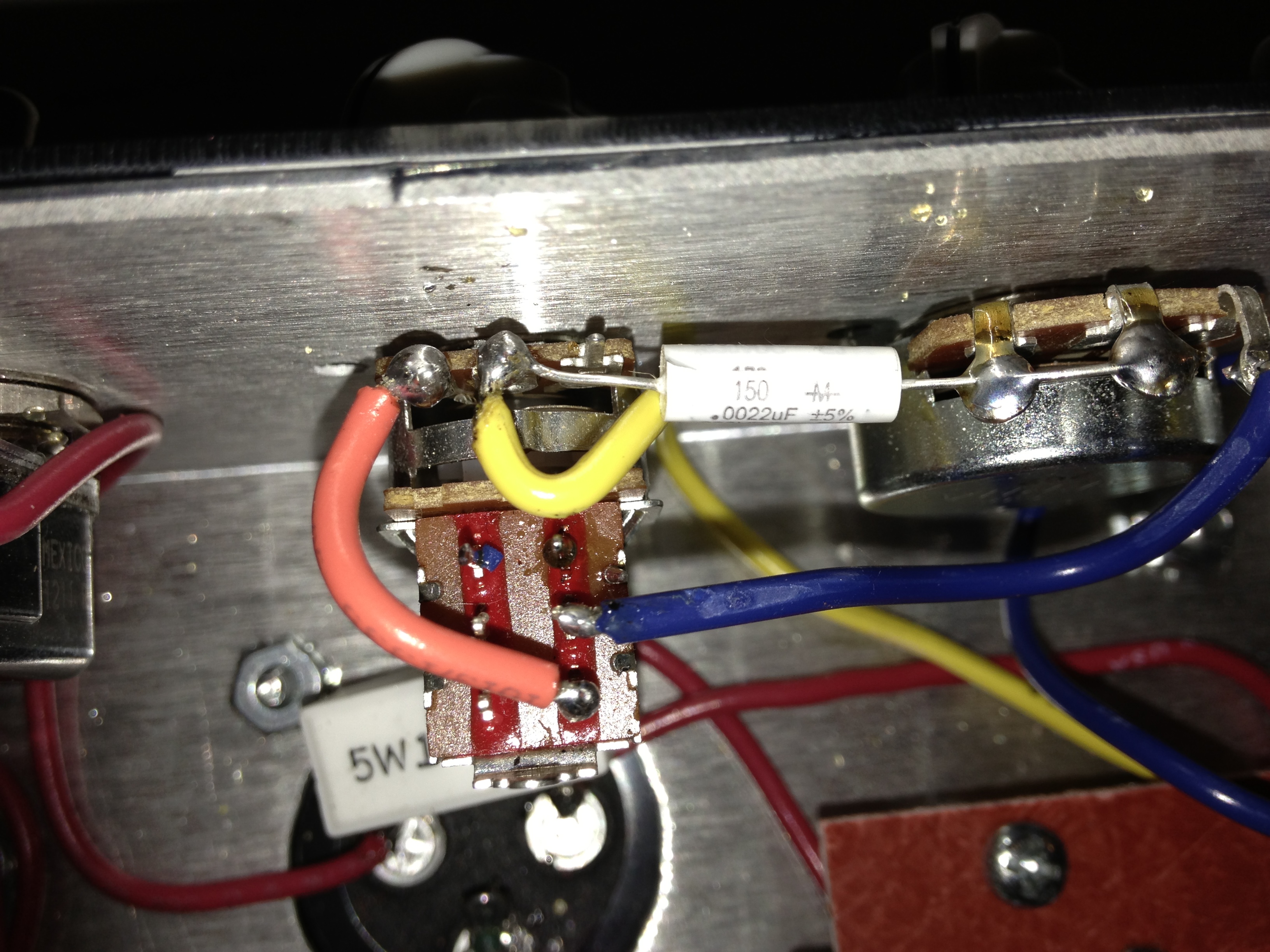

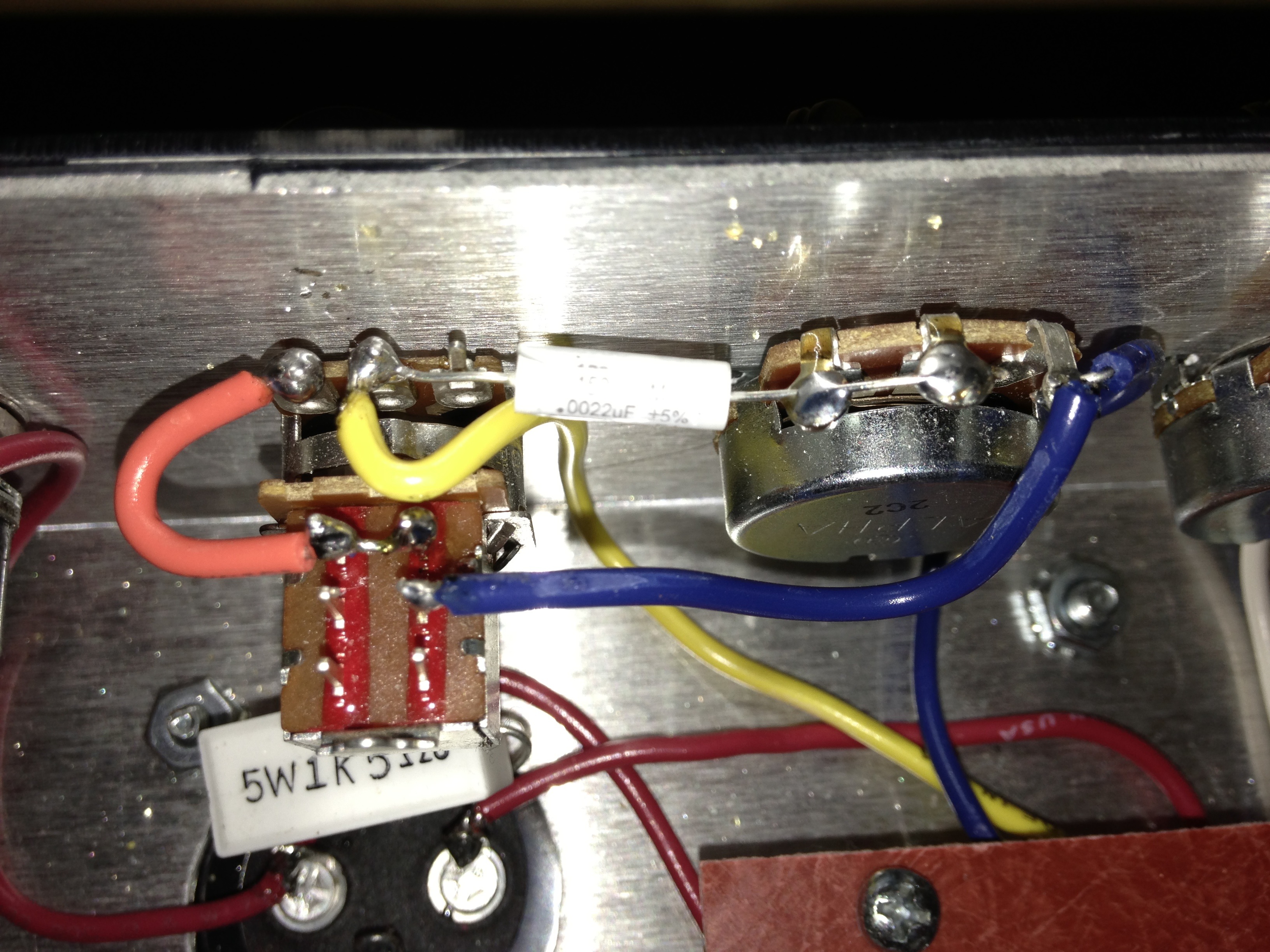

Hi Guys,
Thanks for the help!
I have attached a photo of my master volume build and the layout i'm following. In this arrangement the cut does not work with the master volume engaged (pot pulled). it does work with with out (pot down).
Am i making a obvious mistake here? i've checked it over and over looks correct to me!

PostPosted: Tue Feb 12, 2013 4:19 pm
Posts: 26
I'm not looking at my build right now but going from memory.
MV uses pins 2 and 4 if I recall. So if your switch is layed out like this:
1 2
3 4
5 6
You have pins 1 and 2 bridged.
I could be completely off base here, but I don't have pins 1 & 2 connected together and the MV works fine.
Hope that helps and good luck!
PostPosted: Tue Feb 12, 2013 4:29 pm
Posts: 22
Yes, I have pins 1 & 2 bridged, it looks like it's mean to be that way on they layout. You recon it should just be pin 2?
PostPosted: Tue Feb 12, 2013 4:30 pm
Looks fine
Have you confirmed no broken wires with a DMM set to continuity test function? While at I'd verify the switch is working and the pots measure ok.
Bridging pins 1 and 2 won't make a difference.
Try reflowing your joints, especially that bridge between 1 and 2. I suspect your switch may be bad though.

Just throwing things at the wall but the first thing I'd do is just unmount the pots from the chassis and check without the pots touching chassis. Next I'd take that blue jumper and get it hooked to where the orange wire from the switch part of the pot attaches right at the pot terminal. That would make a temporary switch bypass (as if knob MV was engaged all the time) to see if it is switch.
I'm not sure if it matters if the yellow and blue going to the 220k resistors makes a difference which ones they go to but it wouldn't take much to switch the yellow and blue wires at the pots around just to see. Someone jump in if this is bad!
I don't know how to check the cap jumping from MV to Cut pot but basically there is the two wires going to the board to isolate the circuit. Other than that the whole Master circuit contains a 250K Liner cut pot, a 1M MV pot, a switch and a cap. If I knew how to test the cap I could probably figure out how to test each component individually as my chassis is still open on the bench and everything works fine!

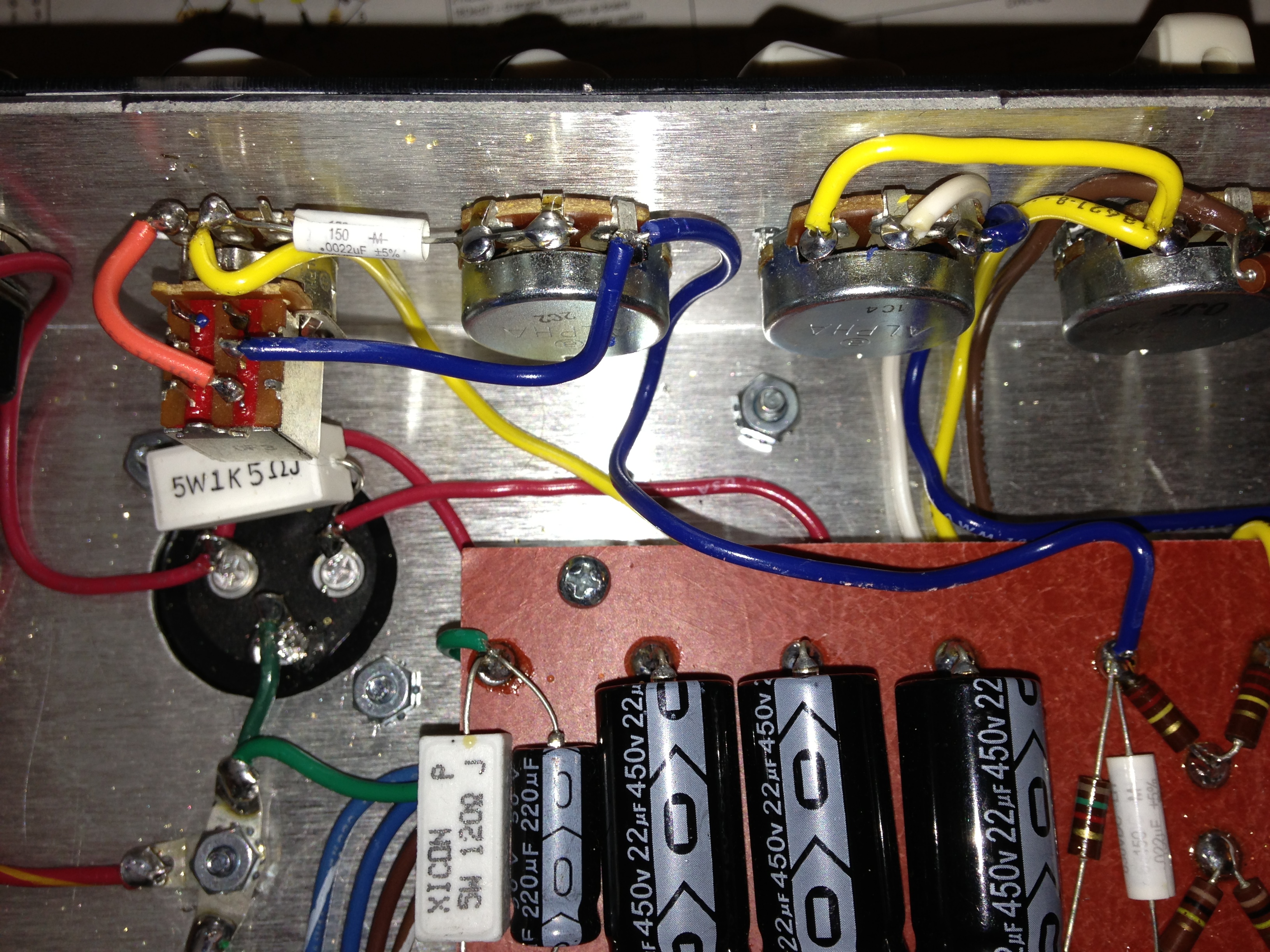

Ok, let me take a look at this. Go back to the schematic, the cut is always in the circuit. It is across C9 and C19. So, just to make it work, check that the wires from those two .022uf caps go direct to the cut pot. Trace the circuit from there.
PostPosted: Tue Mar 12, 2013 2:59 pm
Posts: 22
Thanks Stephen,
OK I have followed you instructions. All appears to be connected correctly. See Pics.
C9 is connected to pin 3 of the cut pot.
C19 is bridged across pins 1 & 3 before connecting to the pin 2 of the MV
Pin 1 of MV is also connected to pin 6 of the MV switch because i wanted to reverse the switch action (cut problem either way).
Any ideas?

PostPosted: Tue Mar 26, 2013 10:58 am
The only thing I can think of is maybe one of the wires is broken internally.
Can you use a DMM and check the wires using the continuity function?
