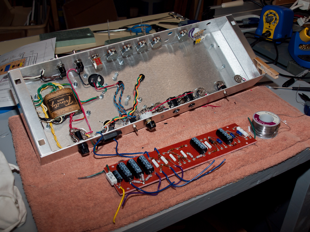

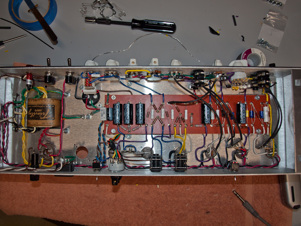

I've been a little slow updating the progress of my TC-15 Kit that was started after the first of the year. Anyhow... I completed the build of the amp in the middle of April and it fired up without any smoke (which of course is a good thing)!!! After a little time diagnosing a very low volume feedback like squeal on the EF86 channel (which turned out to be a cold solder on the signal wire on the high impedance input) I was up and running. Wow how fun this project has been. Recently completed my cabinets and installed a 12 inch WGS Reaper. Need to do the grill cloth and finish a few details on the head cabinet but I am truly enjoying the variety of sounds I can get out of this!!! Clean to Dirty oh boy!! The EF86 loves pedals but I just run reverb about 1/2 of the time. I'll have to figure out the picture thing so I can post up since I learned so much looking at the ones on the forum. Thanks to all of you and the fine folks at Trinity for making such a fine kit.
Well its a new year and I'm finally posting some pictures..... I'm getting ready to build a Tramp for a friend. Thats not a bad way to take care of the build itch since my cash flow keeps going in other directions. Hope everyone is doing well and I'll try to be a little faster in the future!
