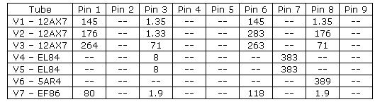

I have put the tubes back in. Putting the tubes in did not change the high voltage AC off the PT. Here's what I found:
With the rectifier tube only, the rectified voltage on pin 8 is about 290V DC (good). I read the B+ with standby on at 435V DC whic compares well to the builder's guide which says it should be 440V without tubes installed. I'm curious why the voltage goes up when you switch on the standby. If anyone knows please fill me in.
With all tubes in and the amp powered up, standby switched to on the B+ is at 390V which is about 40V higher than the 355 suggested in the builders guide. All the pin voltages on the tubes are as I posted before.

Looking through the TC15 docs I found these posted and they seem to jive really close to what I have. I've been going off the chart in the builder's guide and the layout. Is there a reason why there is such a difference between all these?

To account for varying voltages, we spec'd the PT at 117 / 290. 123 is 6 VAC or about 5% high, so expect the VAC to be 5% high, and B+ will be high then too. Although, not 395, I would have expected about 365.
check your resistors to all the 22uf caps, and assuming you used 32/32 / 1K5 on the first filter as per our schematic.

hmm, I checked and it seems that all plate resistors are 22K (or very close) and the 1k5 on the cap can is spot on as well. Any other ideas? I'm not really sure what else can affect the overall voltage. Should I be exploring the option of adding something to drop the voltage or is something definetly wrong? The amp sounds sweet by the way!
PostPosted: Wed Feb 08, 2012 4:30 pm
If this is OFF StandBy, then possibly, your tubes are very efficient and not drawing down the B+. Still seems larger than I would expect tho in this case.
Confirm if SB On or Off?

Stephen, these measurements are all with the standby switched off, as in the amp is in a playable state. When the standby is switched on I am getting the correct 298VDC on pin 8 of the rectifier. The tubes are all JJ's except the rectifier which is a sovtek. Is it safe to run the el84s at this high of a voltage? Could one of the filter capacitors be the wrong value? I don't have a way of testing capacitance.
Brandon
PostPosted: Thu Feb 09, 2012 9:09 pm
I dont think a cap would do that. We have not used the 5AR4 Sovtek rectifier. It might be more efficient. You can easily drop the voltage 20V with a 5W Zener similar to how we do it in the TRIWATT.

Cool. Does this just involve installing a zener diode backwards in the HV line? Also, does it matter where it goes and will it mess up the voltages on my preamp tubes? I'm curious, what is considered ideal for plate voltage on EL84s? There sure seems to be a wide array of opinions on this and I'd like to know what to shoot for. Well, I think I've used up more than my limit of questions for one post.
PostPosted: Sat Feb 11, 2012 10:02 pm
First it might be a good idea to measure how much the EL84s are dissipating. In this type of va intage-Voxish cathode-biased amp, they should be dissipating close to 100% of their rated 12W max. If they're dissipating much less than that, you will need them biased warmer, so they draw more current and pull down the B+ more.
You can stick some zeners in series in the B+ line after the first filter cap. The zeners must be reverse biased, and their total value must equal the amount you need dropped. As you probably have quite a few volts to drop, splitting up the job between several zeners will improve reliability, and also make it easier to adjust the amount of voltage you're dropping. I suggest getting yourself several 6V 5W zeners and connecting them in series on a piece of tag board. Leave the leads as long as possible to help dissipate heat, and don't even think of sleeving them. Then adjust the number of zeners to get the voltage you're looking for. Bear in mind that the builders guide voltages appear to be abnormally low, and a B+ of around 340V would have the El84s running closer to their sweet spot.
When you lower the voltage, the power tubes will also run a bit cooler, so you will need to measure an re-calculate their dissipation and possibly adjust the bias resistor value. That in turn may make the B+ rise a little again, and so you might just need to add in an additional zener. Or then again, you might not.

Ok, I worked out the dissipation at 11 watts, here's how I did it:
Voltage across cathode resistor = 8.35v
resistance of cathode resistor = 128 ohms
cathode current: 8.35/128 = 0.033
Voltage acroos screen resistor = 0.30v
resistance of screen resistor = 99 ohms
screen current: 0.30/99 = 0.003
Anode current: 0.033-0.003 = 0.03
Anode voltage = 381v
cathode voltage =8.45v
381-8.45 = 372v
372v X 0.03 = 11 watts of dissispation (If I infact followed the steps right :) this is my first time)
So if I'm within the max dissipation and I'm happy with the sound of the amp is it ok to leave the voltage as is or will it cause premature tube failure? I know that the specified max anode voltage for el84s is only 300v but have also heard of guitar amps with 400v and more. If I knew that my tubes would be alright I would just as soon leave things as is because the amp sounds ridiculously good. :D
PostPosted: Mon Feb 13, 2012 11:00 pm
You should be fine with that - and yiu now have a TC-20 :). Voltage on it's own doesn't wear out tubes - dissipation does. Although when you go way too high with voltage, you get arc-over, which will sound like crackling and popping, and that will instead destroy good tubes pretty quickly. But it doesn't normally happen with EL84s at 400V, and if it was happening, you would already know about it. Just as one further check, play the amp cranked in a dark room and check for screen grids glowing orange on peaks. If they do that, then put in bigger value screen grid resistors to help limit current peaks.
