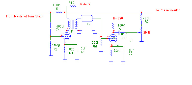

Hi, I'm going to add reverb to my TC-15. Thanks to Kurtlives for posting the schematic and photos in A New TC-15 Is Born.
I'm in the process of fitting a VRM at the moment, but I think I'll need to supply the reverb with full B+ at all times. I was thinking of using a 10K screen supply dropping resistor after a 1N4007. My question is would it be ok to take the B+ from the Cap can through a 1N4007 suppling the VRM and through a separate 1N4007 into 10K screen resistor onto reverb transformer, or do I need an extra 22uf 450V cap tied to ground to do this?
Quoting Kurtlives:
680pF for C4
1M (A) pot
Add a 10K grid stopper on the second triode
22nF for C3 or adjust to taste
Forget what the cathode resistors were, both bypass caps were 25mF. I want to say the cathode resistors were 1K each.
Use standard Fender iron (25K:8)
Tank was a medium delay/dwell tank (full size).
Take the B+ from the node supplying V1. The input to the reverb comes from the output of the tonestack (treble lug 3) and the output of the reverb gets mixed back at the input of the PI (100K 10nF node).

R1 connects to R9 literally as it's shown it's a mixing resistor, to mix the dry signal with the wet signal. It mixes the dry input (start) with the wet output (end).
No connection between R1 and B+, no node there.
Output of the TS is treble wiper (lug 2). You could remove R1 (100K) the mixing resistor and mix across the 220K coming from the TS out but I'm not sure how well that would work and how close it would be to the original TC-15 tone.
You may want to experiment with the mixing resistor....

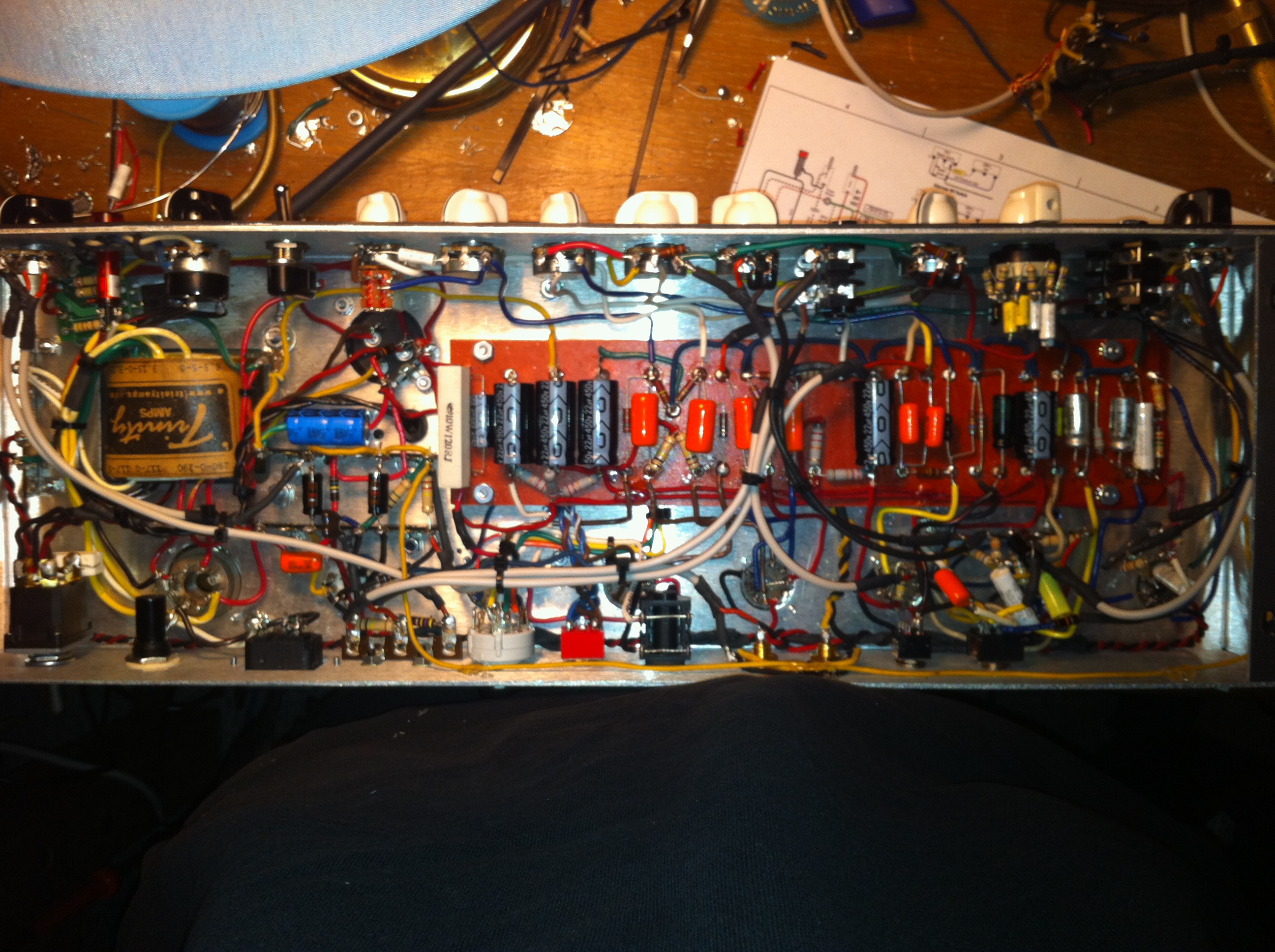

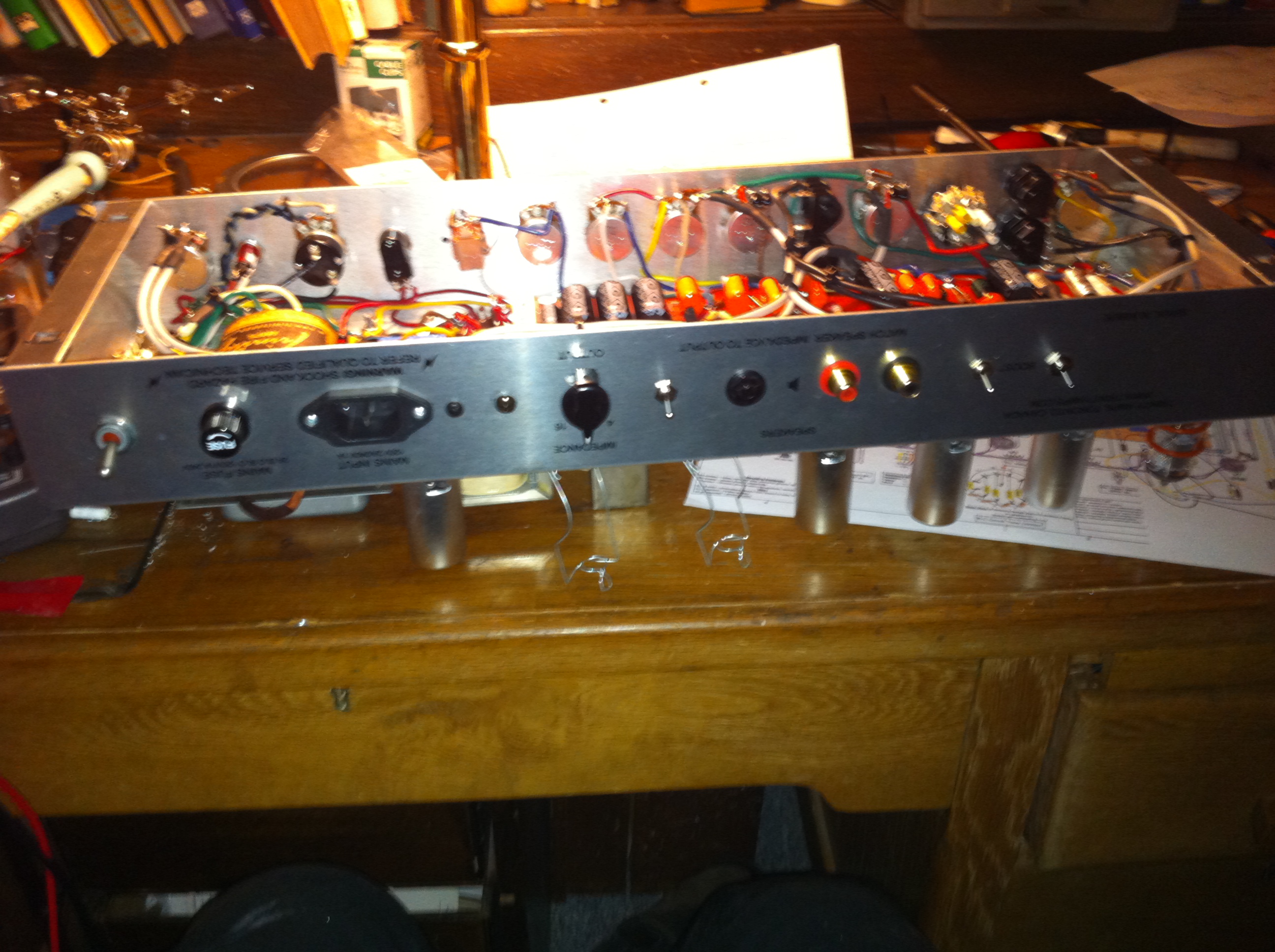

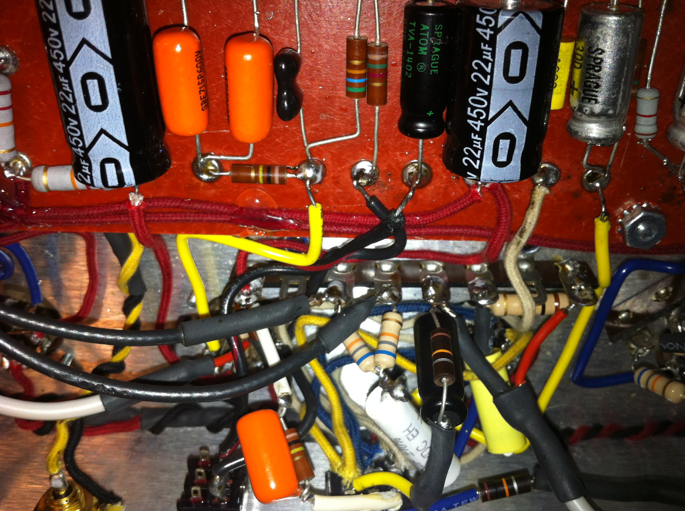

Finished! The reverb is awesome, not too bright or over the top. I've added some photos. I'm still not 100% on the connections.
Still looks like R1 is in parallel with the 220K on the board. I've taken the input for the reverb from the centre pin of the treble control which connects to one side of the 220k, and the return to the phase inverter to the other side of the 220k. Have I made a mistake here?
Thanks again for all your help!
PostPosted: Fri Oct 28, 2011 5:55 pm
Looks correct!
Did you try taking the output from pin 3 like the schem?

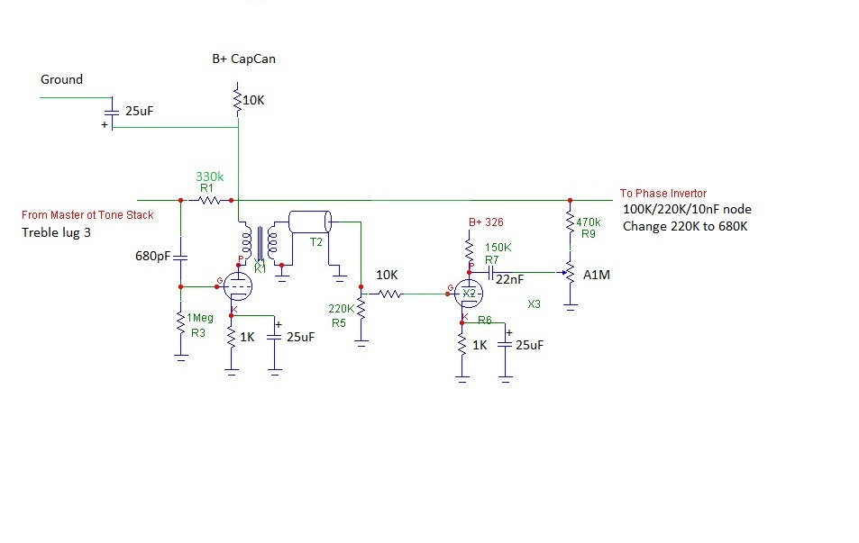

Ok take input from Treble wiper (2) and make the output the 10nF in PI cap. The PI input cap is at the 100K/220K/10nF node.
Take the reverb B+ from the filter cap second from the right. It has a 22K resistor attached to it, change it to 10K.

Since I've taken a separate supply to the VRM for the B+ of the reverb cct, I don't think I need to change any of the screen resistors. I did however change the 220K resistor on the board for a 680K and changed R1 to 330K. this gives me a parallel combination of aprox 220K. I also used shielded cable for almost all the signal wires as I've put the reverb control on the front of the amp and the wires run very close to the transformer. I've added my final schematic below with a photo. Hard to see whats going on in the photo cause there's so little space left! The reverb is amazing, even in cascade mode it sounds sweet, thanks again for all your help :happydance:

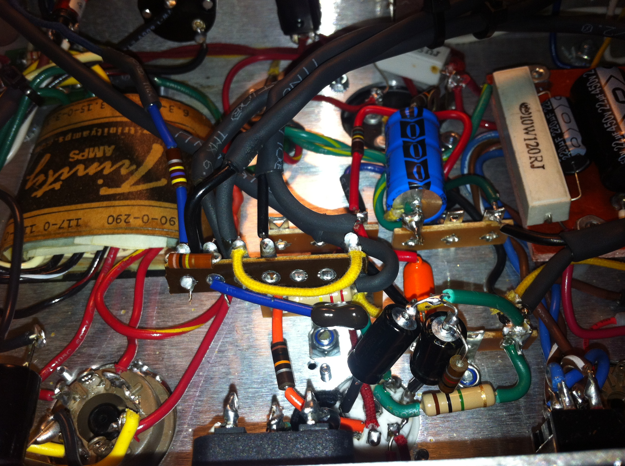

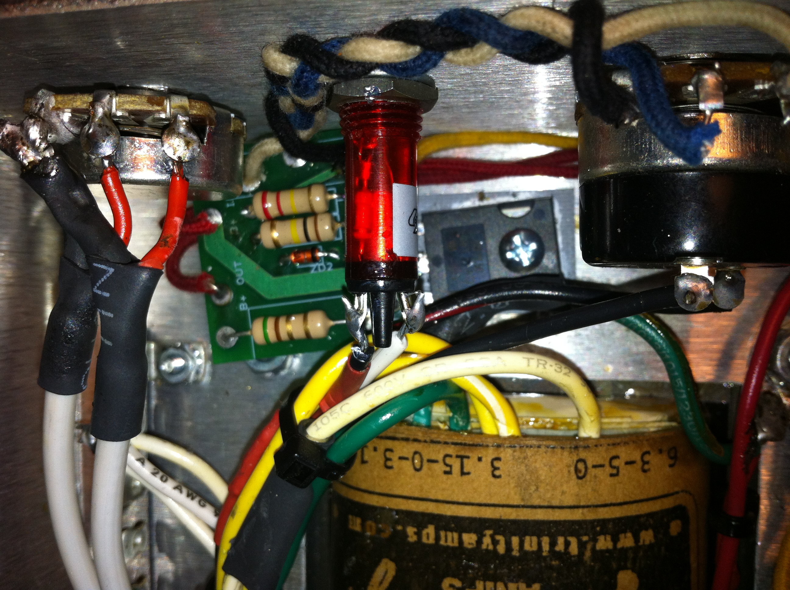

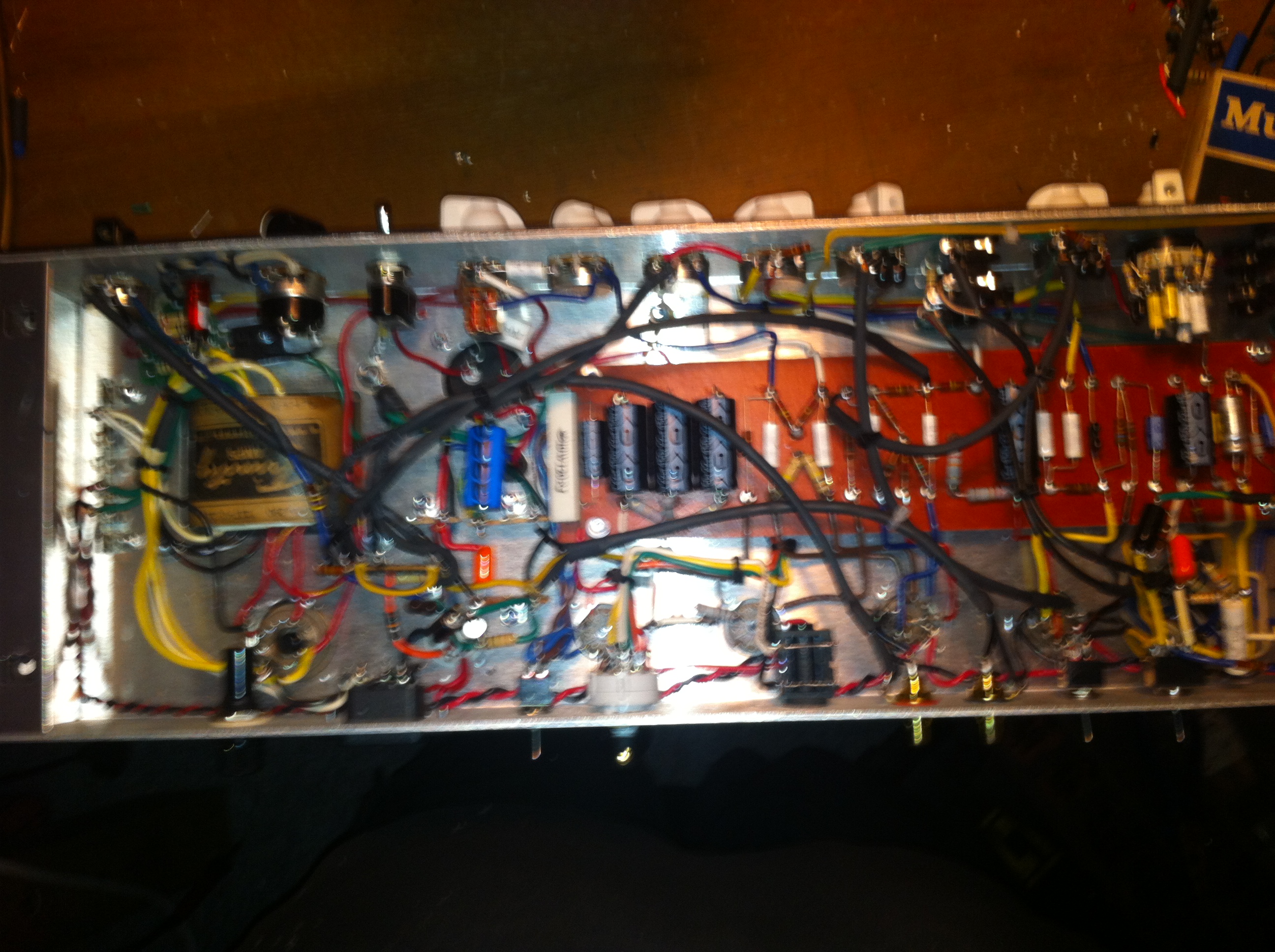

I've made another change and added a switchable choke. The voltages on the triodes are 246V & 135V in resistor mode and 305V & 166V in choke mode. I moved the input to the wiper and returned the 220k and 100k to stock like you said, the tone controls do work better this way. Also did some tidying up, check the pics and let me know what ye think.
