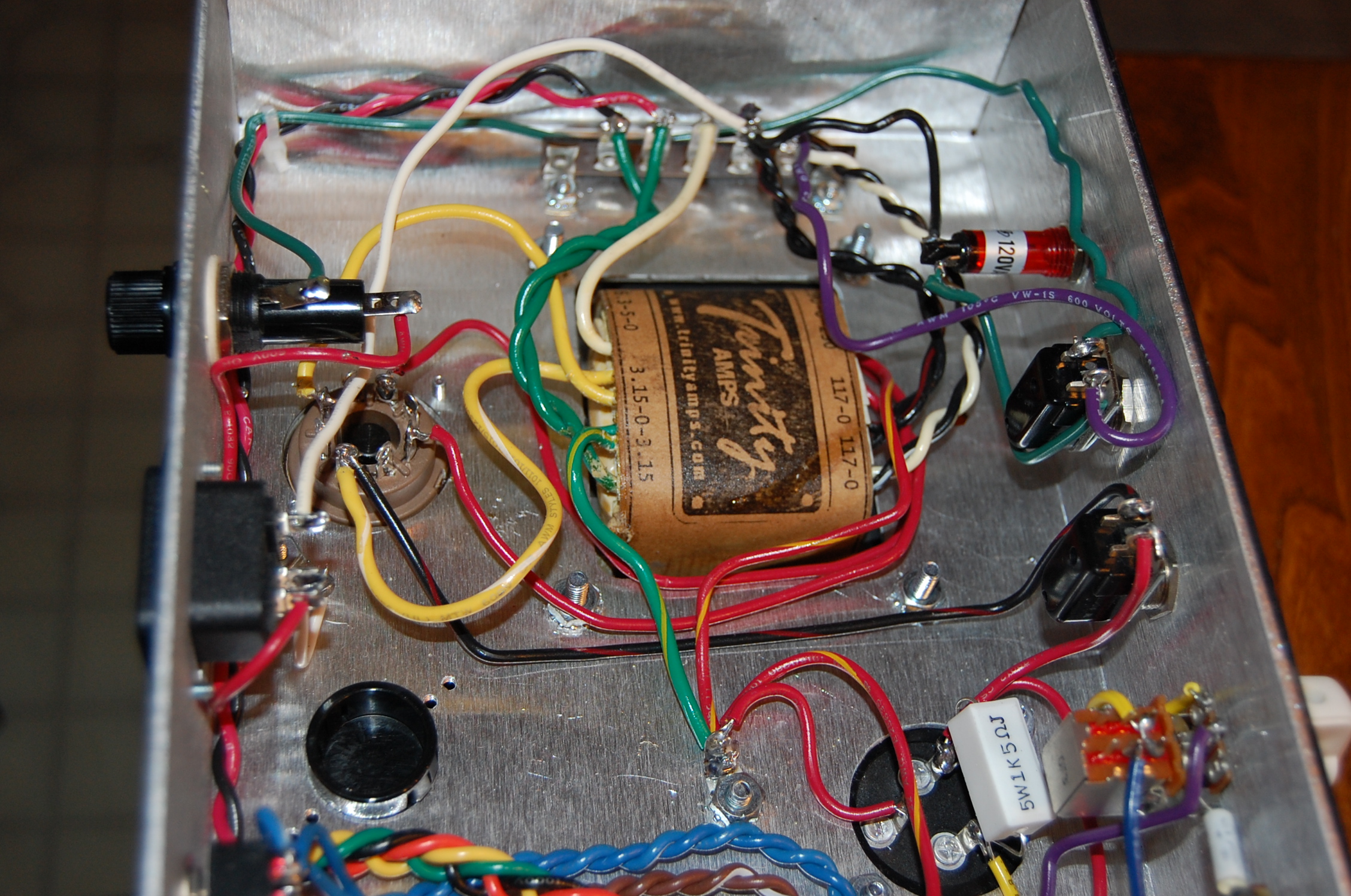

Hey coco, Been busy but finally got around to messing with the amp again. I did the start up in the instruction manual and took measurements. Started out with no tubes and all voltages were good( disregard what i said earlier about the rectifier socket voltages) My B+ is 384v. I measured all voltages on the tube sockets, everything was good and with tubes in, they are all pretty much spot on with the diagram that is posted in the TC-15 docs in the resource section. I have looked everything over multiple times and all my wires are good, board is good, but I still cannot get any sound. Here are some pics, maybe someone else can spot something I am overlooking or chime in with any ideas, Thanks guys!!

PostPosted: Tue Dec 06, 2011 12:48 pm
Is the impedance switch conected correctly? The blue line goes to acenter pole of the switch.
Is there any hum at all out the speakers?
If you touch the grids of V1, do you hear a pop or click?

Yep, blue wire is going to A on the impedance switch. No there is no hum or anything from the speakers. I poked around on v1 (with insulated screwdriver lol) and did not get any pops or sound.
PostPosted: Wed Dec 07, 2011 10:35 pm
I dont like the sound of that. (no hum at all). You said all the voltsage were good, even the EL84, so, bypass the impedance switch. Move the blue wire to the OT (say 8 ohm) lead.
Just confirming the switch is wired correctly. Unless you know for sure.
PostPosted: Thu Dec 08, 2011 10:50 pm
Joined: Tue Oct 12, 2010 1:22 pm
Got it working!!!! the impedance switch was funky. I had my tang washer on the impedance switch set for three positions and i had the output tranny wires going to pins 1,2,and 3 of the impedance switch but those were not getting anything; So i put my meter on ohms and measured resistance and pins 4,5,and 6 were the ones getting some, so i put the wires onto them and bingo, it worked. Thanks for all the help and troubleshooting and tips!!! This thing is amazing, I think my Marshall 18 watter and Fender prosonic are going to feel a little neglected for a while, haha.
