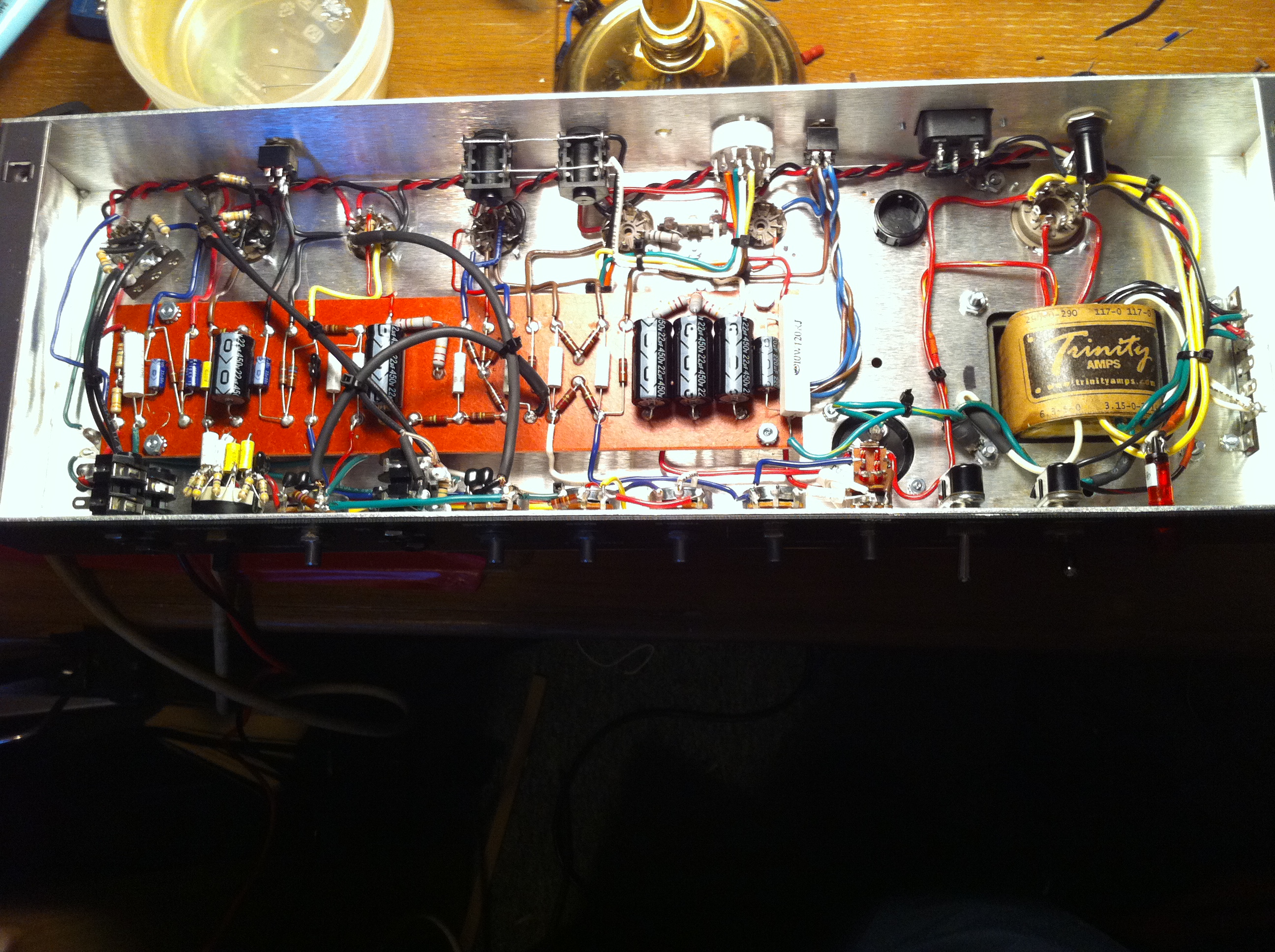

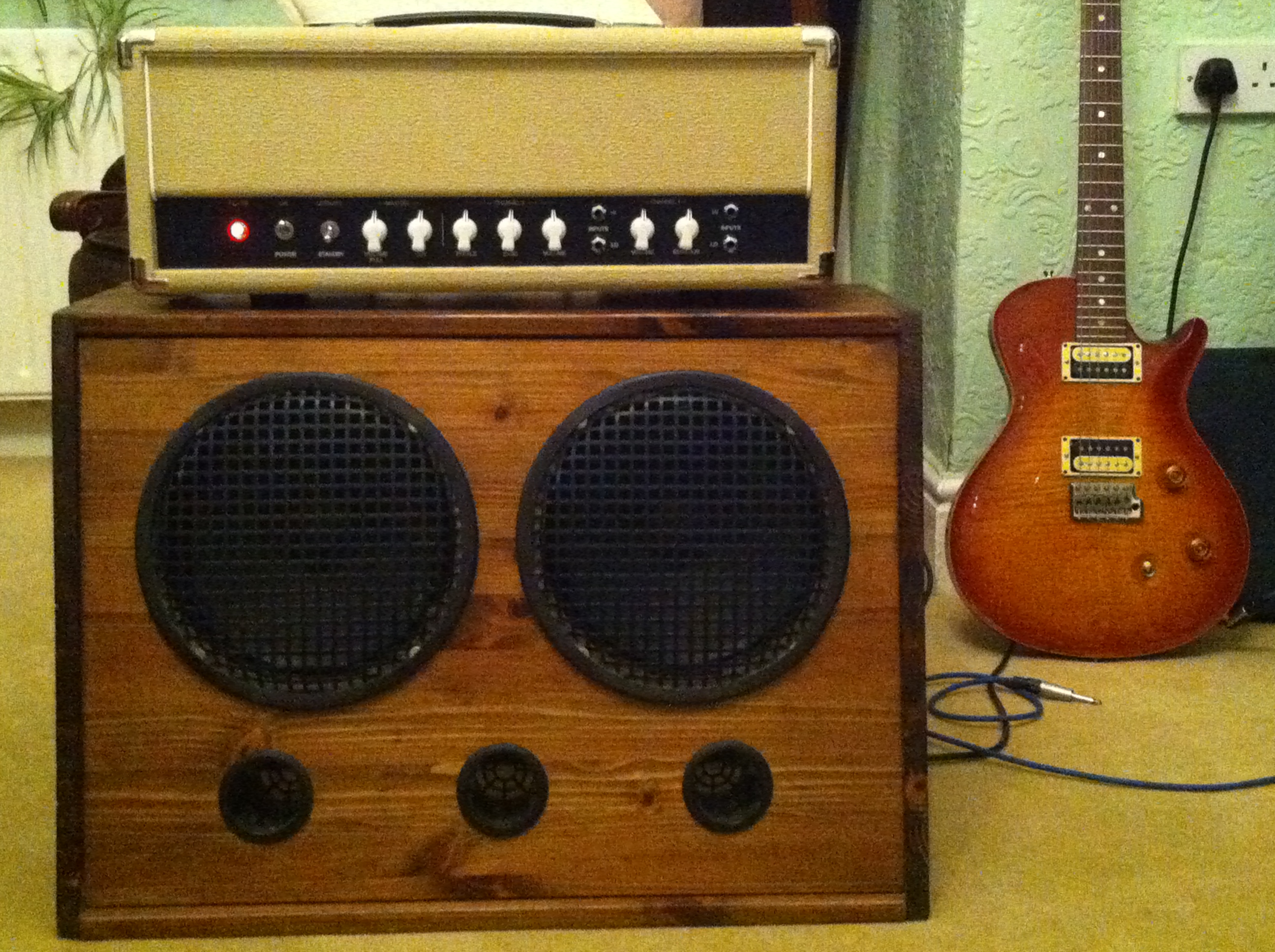

PostPosted: Sun Oct 02, 2011 7:00 am
Posts: 38
Location: Dublin, Ireland
Just finished my first build. The notes and drawings made it so easy to build, it fired up first time, no noise no smoke! Great sounds, distortion on CH 2 is really nice. Running all NOS tubes mullard in V1, V7 and the rectifier. Using a Telefunken in V3 and a sylvania in V2. V4 & 5 are national EL84's never heard of them but they sound good so.... The clean channel sounds excellent, but I'm thinking of trying the cascade mod you've described to get some more gain. My main aim in building the amp was to get a better understanding of how an amp works and how to tailor it to my needs. I want to use a pot to control the gain in cascade mode. Would 1M be about right?
Posted some pics, let me know what ya think.

PostPosted: Mon Oct 03, 2011 3:51 pm
Sounds like a fun plan! Amp looks good!
1M(A) would work, but for a bit more control and a tone that is not over the top I'd try 500K or 250K. 1M is ideal here but will give tons of gain.
