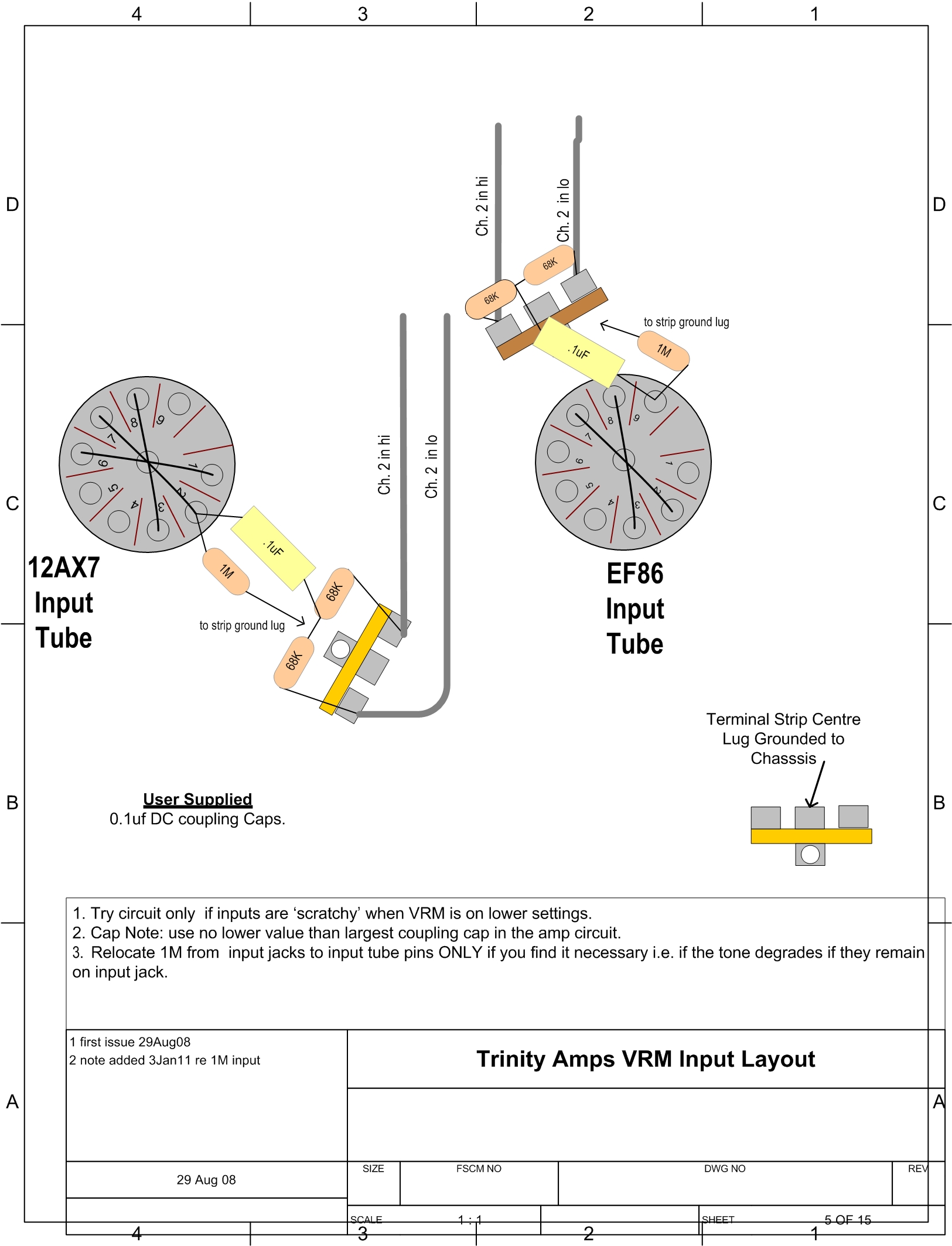

I am working on my first Trinity amp project, the TC-15 kit. I also purchased the optional VRM kit for this amp. Does anyone have any pictures of the VRM install on a TC-15? I have read a few posts, VRM install placement varies in the user posts. Also, anyone utilizing a 3 position on-standby-off switch in conjunction with their VRM install d/t VRM pot being placed in standby switch hole in chasis? Thank you in advance for any feedback and pics.

We sell our VRM a switched 1M pot so you can replace eitherswithc. I prefer to replace the power switch and keep the standby original. A 3-way , progressive like the TRIWATT would work as well, but these are expensive and hard to source.
Here's an input layout
