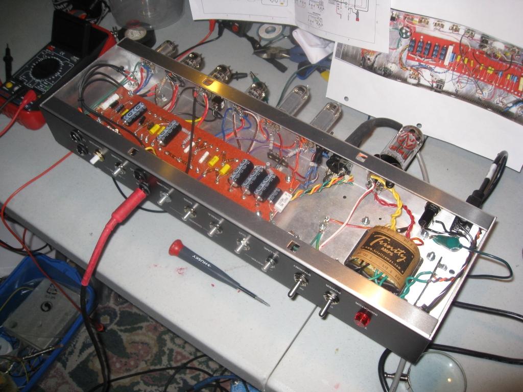

I have sound and at first listen sounds decent at low vol. The family is home so I can't open her up yet. seems like most of it works but I'm not convinced the contour switch is working as it doesn't seem to have any affect on the tone of Chan 1. Also some of my voltages on the EL84 and preamp tubes seem to high. I plan to do more testing and will post the values for input. Anyway Its been a long day of sniffing rosin fumes so of to bed. I posted a few pictures of my work. I think for my first P2P I did a decent job.

Yes, very nice, tidy job. The contour effect is subtle so listen for Fat <-> Thin as you turn it. Post more info when you get a chance.
