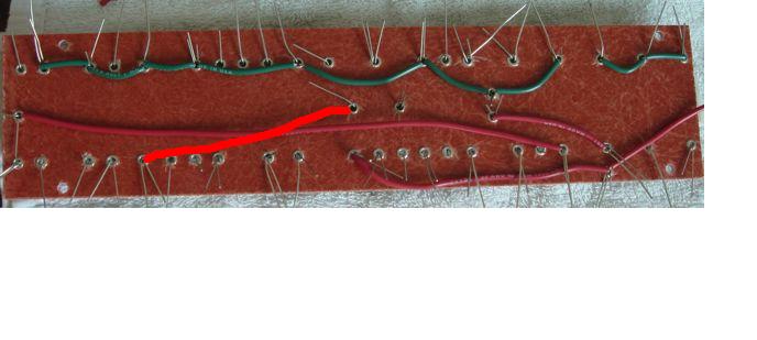

I am having some trouble figuring out how to wire the underside of the eyelet.
The illustration doesnt seem to follow the newest layout.
I am following the layout, but it would be nice to have the right illustration.
If i'm right:-)
Edit, posted some more pics.
Please take a lok at the power section as well.
www.paradisepi.com
PostPosted: Thu Apr 30, 2009 8:47 pm
Posts: 112
Location: Bangkok
Ok, i assume i have done it correctly and will press on.
www.paradisepi.com
PostPosted: Thu Apr 30, 2009 9:16 pm
Double Check the jumpers, one is missing here:
PostPosted: Thu Apr 30, 2009 9:35 pm
Posts: 112
Location: Bangkok
hehe, just discovered that one myself.
www.paradisepi.com
