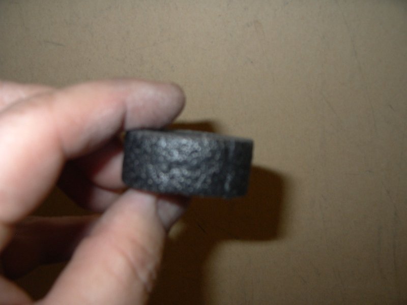

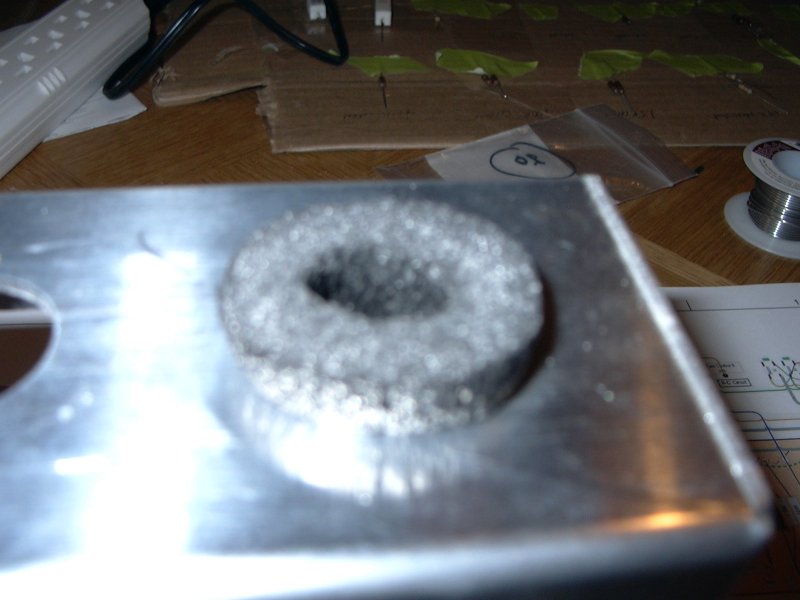

Here is my attempt. Have no idea if it'll work. I took a 3/4" foam pipe insulator and cut off about a 3/4" - 1" piece.
Then I cut about 1/2 way through half way down the piece.
Then I enlarged the hole for the tube socket in the chassis and pushed the foam into the hole, so that half protrudes on either side of the chassis.
Then, i pushed the mounting screws through the foam and hopefully this will keep the screws isolated from the chassis.

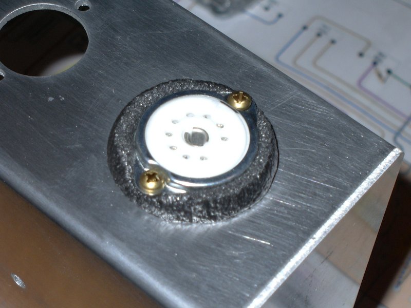

From the tube side:

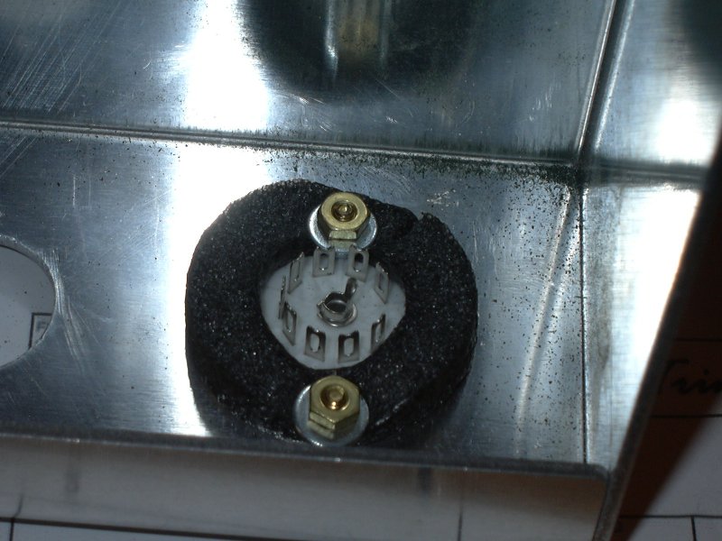

From the inside:
Using this method, there is some play in the tube socket to absorb the vibrations, but I can still get a tube in and out.
The proof will be in the playing. We'll see!

Update: I have had my colourful combo in service for a while now and have had the opportunity to play at BOOM on a few occasions and no issues with microphonics. I guess my socket damper works!
