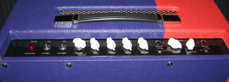

I must say, the new amp looks stunning in the head pics, and the classic lightning look of the "old" amp is a timeless one. Gotta love the top-mounted controls for that M_______ss vibe!

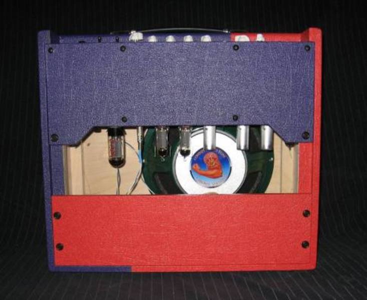

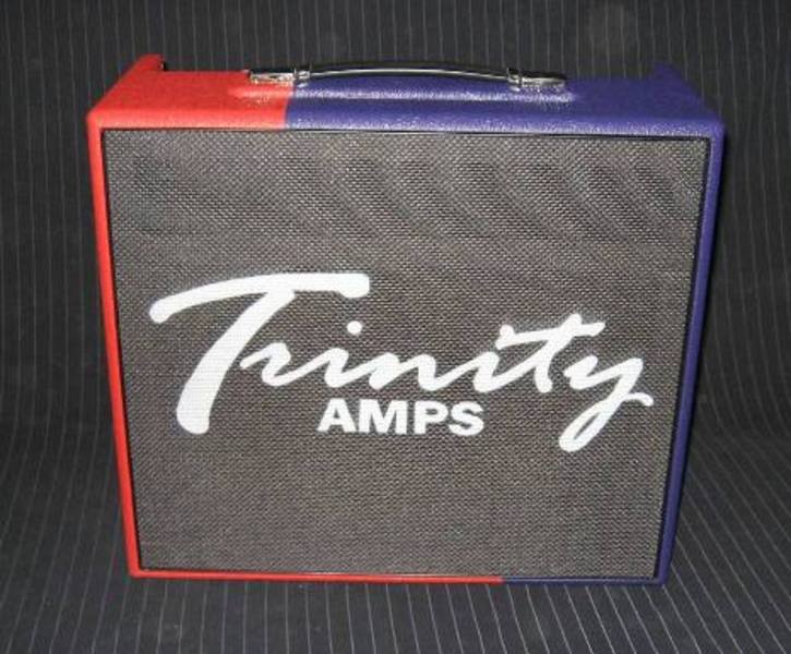

I was waiting for JP to post, but this will kick it off. Interesting combination of colors (purple/red) and JP sprayed the logo on the grillcloth. Tone Tubby of course!!

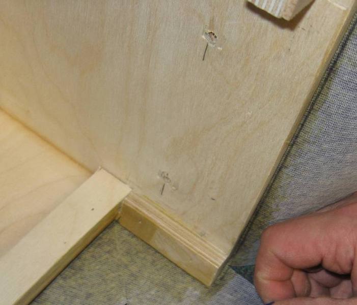

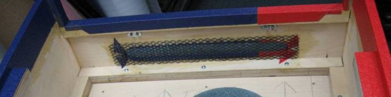

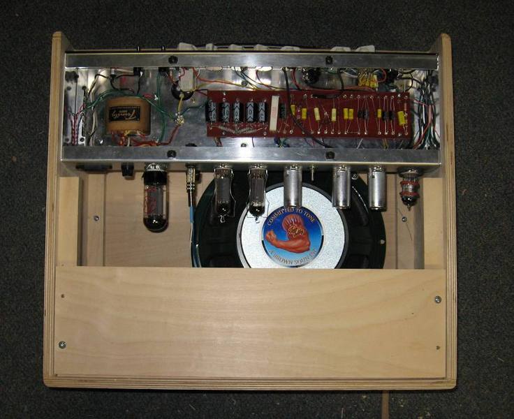

This is a compact one: 21" W X 18.5" H X 9" D . OFf-set speaker mounting perfectly balances the amp for carrying. Production needs to be 10.5" deep to fit Alnico Tone Tubby. Mounting the chassis was the biggest challenge and involved extra holes/bolts/nuts & ingenuity. Will post some pics soon, but the chassis fits exactly inside the cabinet.
We had to install 4 cage nuts on the sides and also 2 more for a total of 6 on the rear flanges.
We had to add a piece to thicken up the look and provide a surface for the panel to butt up against to prevent rattles.
