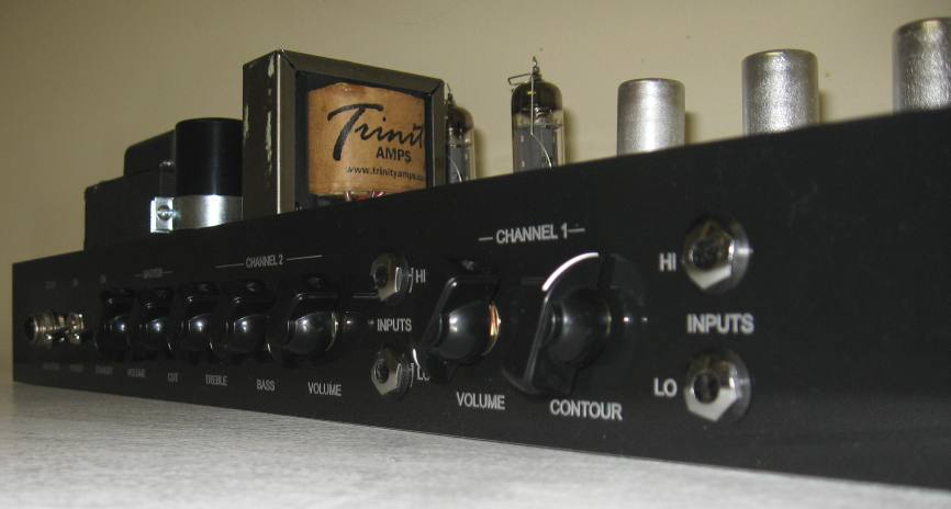

Finally got the TC-15 panels sorted and in stock. Here's a pic of the prototype in "Black". Hard to tell but that's gloss black with silver lettering.
TC-15 Front Panel
PostPosted: Mon Jun 11, 2007 9:12 am
Posts: 1078
Location: PA
Looks sweet and I'll be seeing her soon :D
