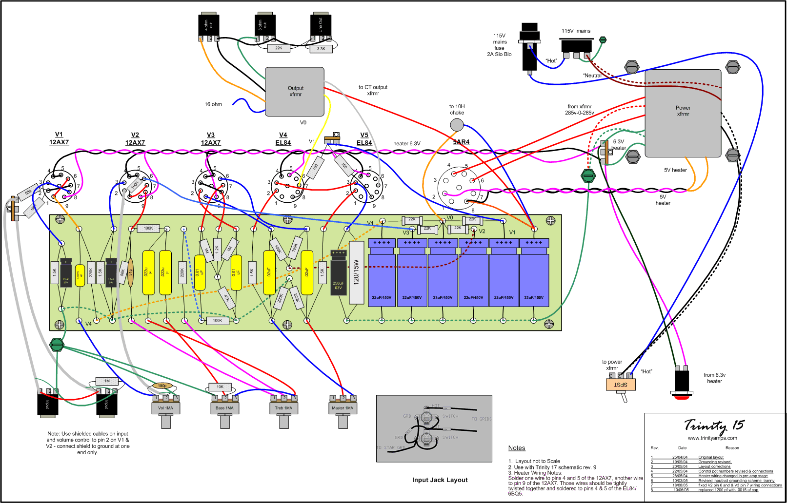

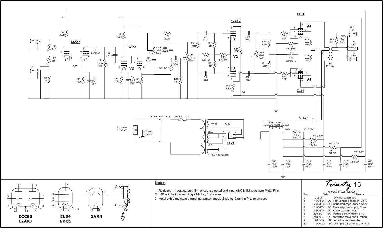

I have the pt ot and choke.. all Classic Tone. I am using http://www.trinityamps.com/Trinity15schematicrev10.gif
and http://www.trinityamps.com/Trinity15layoutrev9.gif
Size for chassis? I have 16X8X2..my cab is nearing completion, and the chassis could be changed to 16X19.5X2.
and placement of Iron/Sockets kinda funky in my mind.
Anyone got any pictures of a finished T-15.. gutshots and top shots of the chassis would be tres cool.
