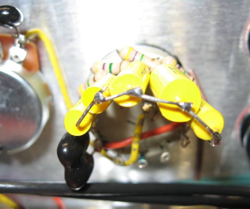

It looks OK but there has to be a reason why this is not working. I'm guessing the stack is being bypassed somehow so I'd check to see when you switch it, the connections are being made thru the correct parts. Test one to see.
Glad it sounds great tho!!

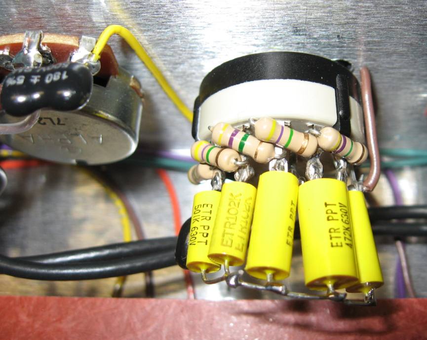

Here are some pics of a recent one I built. It might help you.

OK> I completely redid the contour switch and tried to replicate the one in the last photo you posted. Note I said TRIED. Now the contour switch works but only in position 1 and 6?. So the first and last position work as their supposed to (change in tone) but everything in between does not. No sound at all.

Just noticed that you have what I presume to be the PIN6 wire hooked up to position ?1 or 12? on the switch whereas mine is hooked up to position 7. Could that be the problem? I was following the diagram which I thought showed position 7 as the hook up point.
