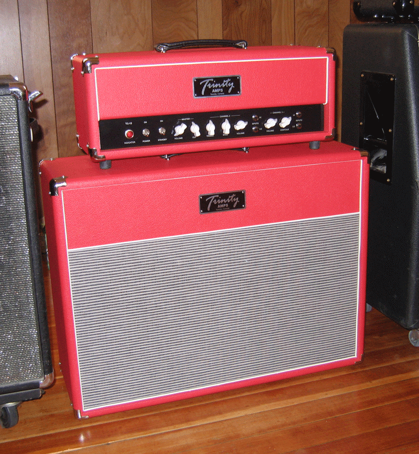

212 Tone Tubby Alnico to match the TC-15.
bgroup Hot Rod
