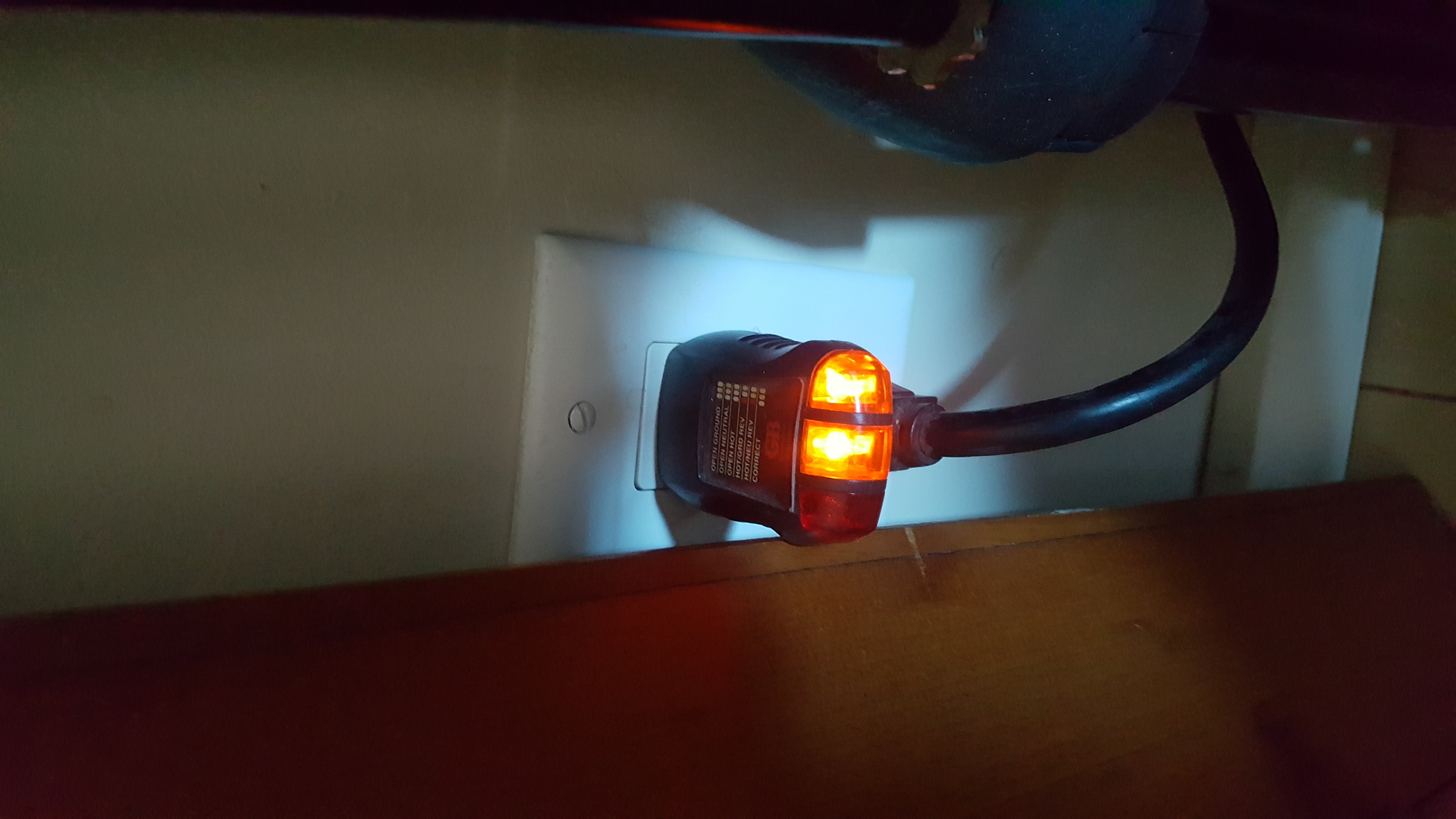

Here are some pics of a simple test for your AC socket to ensure polarity as well. I have a simple tester now but we fried an old PA power amp our keyboardist had after linking to main PA because of an improperly wired socket at an old pub once so I always check now. You can see where you should have 120V and where not to. Keep in mind you will NOT get this result on a GFCI socket or socket wired to a GFCI circuit (there will be NO 120V to ground) and will require a tester for that (<$10) which is easier. (Photo included)
I only suggest this as a way of eliminating problems at the source and is good to know. FYI the thing that is plugged into the bottom outlet of socket is my TC15.
