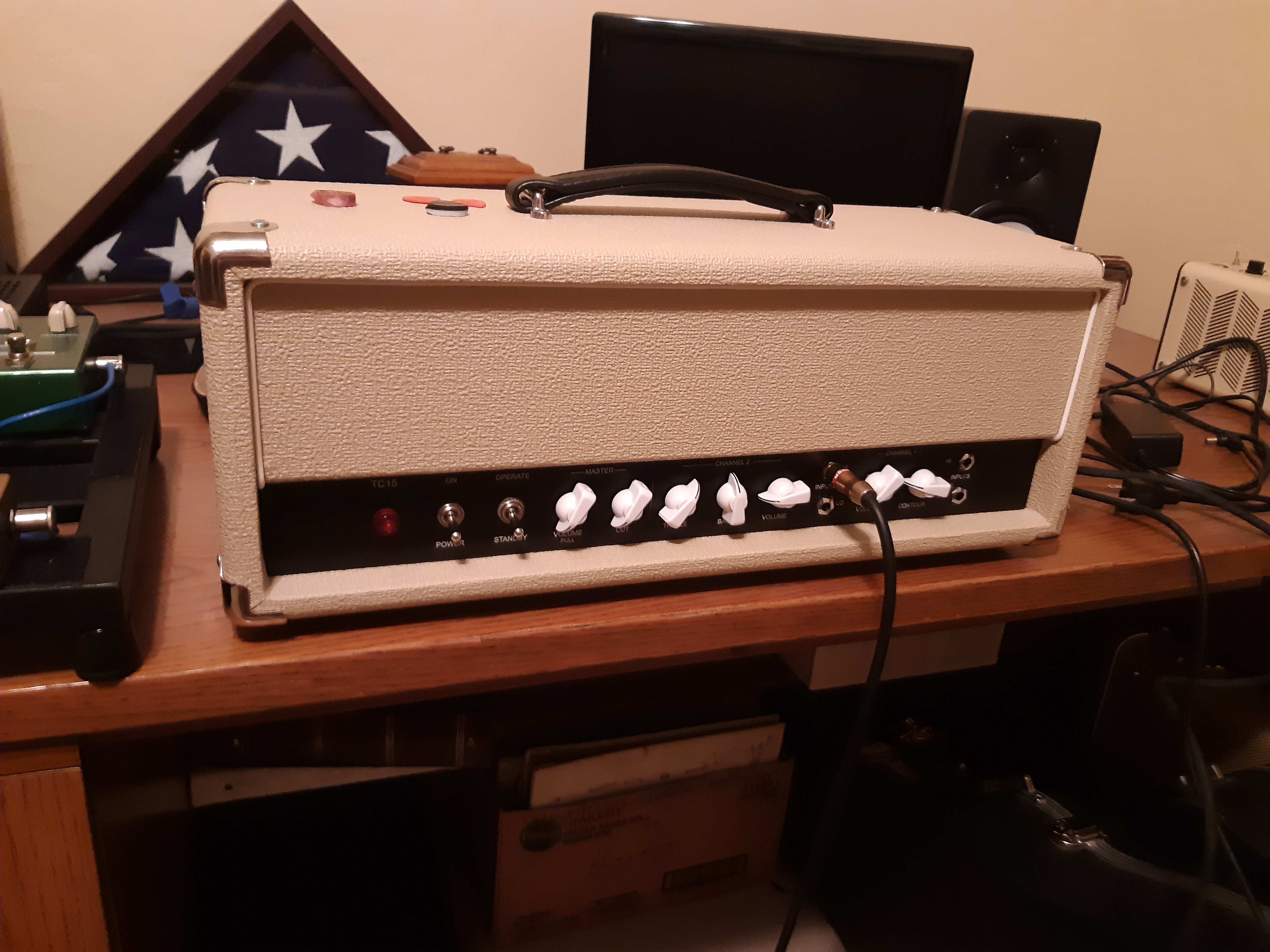

After having some family and professional challenges to deal with, I have my TC15 build up and running. To say I'm pleased would be an understatement. This amp is exactly what I was looking for. I've been gassing for a Trinity kit for years, and now it's a reality. I learned a lot from the build, and the build guide and layout are excellent. The boys and I had a jam last night at the house, and they were over the moon with the sound the Trinity added to the mix. I use a Fryette Power station in my rig.... Add my Strymon Flint reverb pedal, and a little delay, and it's really sweet. Sounds great through my 2x12 loaded with Eminence Red Fang alnicos. For tubes I'm running all NOS. A Mullard EF86, GE 12ax7s, RCA 7189s in the power section, and a Mullard rectifier. The ONLY thing I want to tweak, would be to brighten up the EF86 channel a little. Seems kinda dark.....any suggestions guys?

A couple pics...….

Glad you are enjoying the TC-15. It looks really good inside and out.
To brighten the EF86 channel, try changing C39, the 180pF capacitor on the volume control. Try bigger values like 270pF or 500pF.
